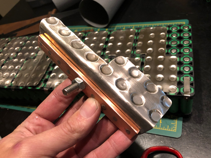

1200 amps from the 38P
You only need thick copper buses at the two pack ends, the positive and negative collectors. You are only drawing 31A per cell, so 0.20mm thick copper is all you need for the cell buses. Making those buses thicker will not help, and it would make welding more difficult.
If you were mapping the current, the copper bar shown could be thinner at the two ends, and thicker in the middle next to the connecting bolt.
With wat mechanism did you make these indents? You seem to have made them very systematically, and I also need to manufacture a bunch of these sheets. Do you have any tips?
Kind regards
Those pictures were produced by a different builder, and he made a press and die set. I don't remember the original link, but the press and die are similar to the one in this thread:
https://endless-sphere.com/forums/viewtopic.php?f=14&t=57810
