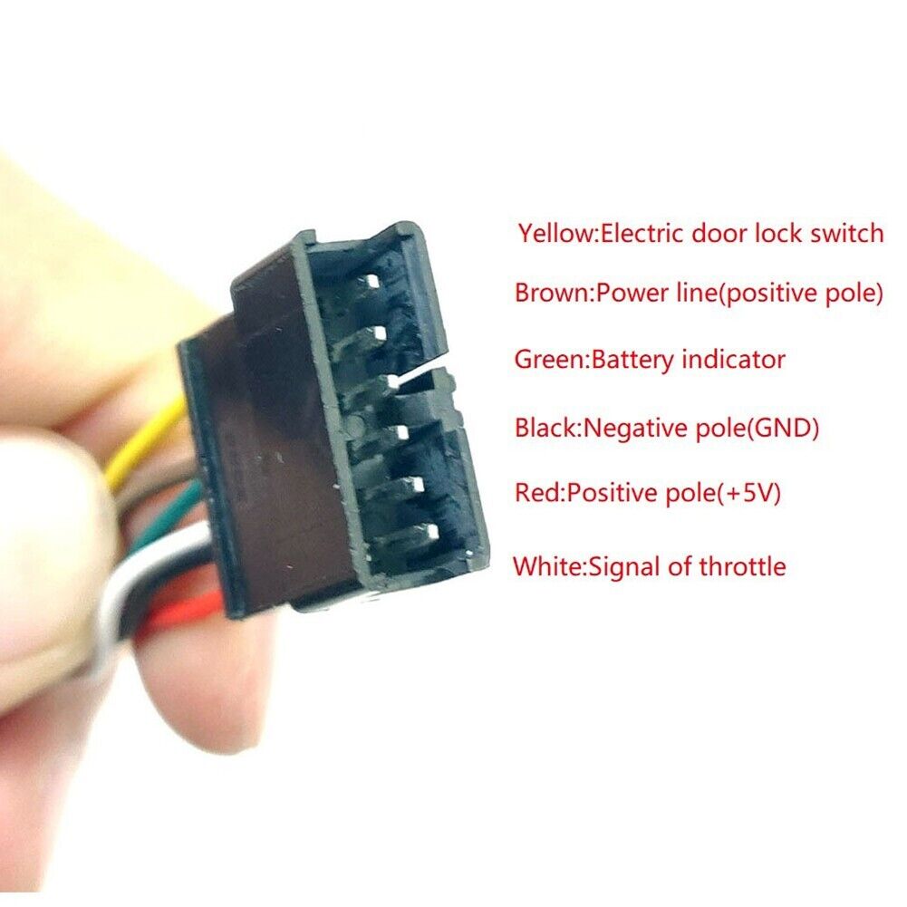

Hey tc: So when you say jump the power wire its as I described...basically joing tother the red postive power and the yell throtte wire together than then add on connector for battery connection? I don't know what green wire you are referring to. I‌am NOT uing the 6 wire throttle as it is a twist gripe (dangerous). I‌use thumb throttles initially trying my preexisting 3 wire throttle...it didn't power up. I then bought the 4 wire throttle and with yellow wire disconnected it didn't power up. Since the have no diagram on the controller electronics we have no idea as it hw it NEEDS to be wired in order to work. The ony thing I do know is that it is marked as a dual mode controller so I've been doing sensorless connections, just throttle and phase wires. I‌ guess I'll just have to wire theyellow up to my power red goign to battery and see if that does the trick. I will never buy a kit again just based on price. I'm gonna make sure i get diagrams and/or a support phone #.
Yes the first pic IS what I have. Let you know how it goes.
Fine, in the throttle posting that I found for it, the wiring pin-out and colors were given.
Sorry for the size...
This picture may help explain my earlier post and required wiring.
To be specific...
In order for the controller's electronics to be powered up. The BROWN and YELLOW wires at this connector need to be jumped, or tied together. Then, the GREEN wire at this connector should have full voltage to it, which can be connected to your throttle's YELLOW positive voltage display wire.
Note: Connecting the RED battery power to your YELLOW throttle wire alone will NOT energize the controller.
Please RE-read my connection and voltage tests in my post above, and the sequence of connecting. Verify that the correct voltage is where and when it is supposed to be first. Being careful not to let the high voltage wiring come in contact with the throttle's low voltage hall sensor wiring.

Hey Tommy! I'm finally checking in again as I laid out my components on a work board, changed some connectors etc. I finally found the supplied twist throttle to see if something was missing would recitify itself with the 6 wired throttle. Well...nothing changed. No power showing on throttle nor in the motor. It dawned on me that it might demand the hall sensors to be connected as well even though I assumed it would run sensorless since they offered a dual mode controller. But as I go to connect the wires for that I notice that the controller has 6 wires for the halls and the motor has 5 wires for the halls! WTH? I don't know if my assumption was right and I don't recall reading any other posts whether anyone else has run it sensorless it would seem I'm at an impass. I‌ will reread and try you suggestions again after I give myself a breather this afternoon. Hopefully I'm wrong and there is some other problem that does not allow it to power up. I‌ connected just the controller to battery to see if any voltage was detected on any connector so I checked to measure the 5v on the throttle wires and I got nothing. Again I assumed that any power would show once connected to a power source.
Followup...sucessfully connected 5 wire twist throttle so at least I know that I‌ was able to achieve display and battery voltage. However the motor showed no signs of life. It may have something to do with the white wire that has no mate. Onother site identified white hall sensor wire as a temp gauge but I don't know if that's true. I thought I'd read somewhere that the white was the signal wire for the motor but with no white wire on the motor I'm stuck again. Did anyone else has a 6 controller to 5 motor halls?? THere is alkso a tiny red item on the throttle display. I can't make it out.‌What's it for?

Well after 5 months it's finally running !!! Hallefrickinlujah. Apparently for this kit 36/48 volt 500W The whole problem is the wiring for the throtlle and the controller setup. I‌ used the included twist throttle which I may alter or switch out in the future but for now I just hope there is some longevity to this kit. The wires (hall and phase) are awfully thin 23/14. I‌ predict burns in the future but let's see. Apparently for this motor you can run it senseorless, You don't need the pas installed in order to work as electric bike. All the wires are same color to color match. Tomorrow my maiden ride.
