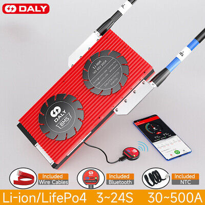

***If you have a smart BMS with bluetooth and actually monitor it all the time with the phone app, you'll see the overdischarged voltages (as long as the reversal of voltage doesn't cause the sense input to fail), and could do something about it, but you still can't know the FETs are stuck on--the app will say they are off becuase it can't tell what state they're in, only what the BMS told them to be).

Because the BMS can't talk***, it can't tell you that any of this has happened--it's entire capability to prevent damage that can lead to fires consists of turning those FETs off, which it did. So the end-user will never know this problem and damage has occured or that the BMS can't protect the cells anymore, and will continue to depend on the BMS to do a job it can't do, so even if the first damage doesn't result in catastrophe, the likelihood of it eventually happening rises with every further usage that runs the pack down to empty and overdiscahrges or even reverses the cell(s) again.

72v 150a BMS:
