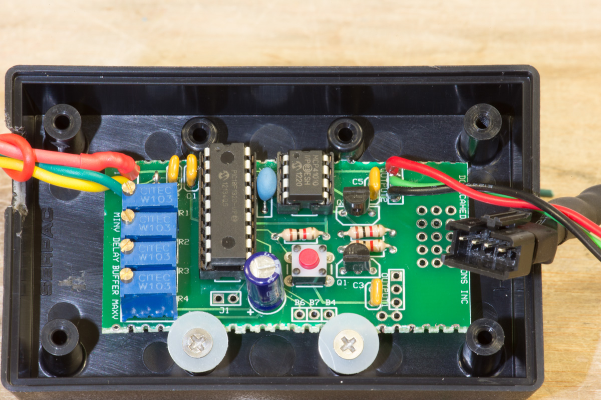

Where do I measure the voltage for the Delay and Buffer settings so I can report them. I see you reported Delay=0.65V and Buffer=1.43V in your written instructions.
Here's a picture of the board if you can tell me where to measure them. Bigger picture of the board is here: http://www.fareinc.com/65/Pics/Throttle_Int.jpg
-Jim
Voltage can be read from bottom of the board on the middle pin of the pot. Ground reference should be measured from the board at a throttle in or out pad.

Stealth_rider, the delay and buffer settings do have some effect each other. If you feel there is to much delay in throttle response you can do two things to improve it, twist the throttle faster or turn the delay pot clockwise a little more, both have the same effect but it needs to be tuned to your riding style. When you get close start making delay pot adjustments in small amounts like quarter or half turns. So yes, if you like the buffer feel, start tweaking the delay pot.
The buffer has the most noticeable effect at really slow throttle movements, a high buffer setting causes a slow ramp up unless you quickly turn the throttle, only experimentation will help you get it feeling right. I'm finding it hard to find the word on how they interact with each other. I need to come up with a good example or analogy.
