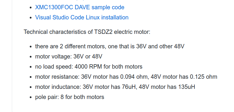

stancecoke said:Do we know the motor parameters for the TSDZ2? We need senseful values for making the motor run in sensorless mode with the DAVE FOC APP. This are the default settings in the APP:
regards
stancecoke
Yes we have!! A developer, at very beginner of this developing our firmware to motor controller V1, did measure the resistance and inductance of the motor, using the tools at his work. We have the value of:stancecoke said:Do we know the motor parameters for the TSDZ2? We need senseful values for making the motor run in sensorless mode with the DAVE FOC APP. This are the default settings in the APP:
I think @abrainer is testing to run the motor, I hope he can test using this data. I updated the repository with the technical characteristics of TSDZ2 electric motor:casainho said:Yes we have!! A developer, at very beginner of this developing our firmware to motor controller V1, did measure the resistance and inductance of the motor, using the tools at his work. We have the value of:stancecoke said:Do we know the motor parameters for the TSDZ2? We need senseful values for making the motor run in sensorless mode with the DAVE FOC APP. This are the default settings in the APP:
- motor voltage
- no load speed
- motor resistance
- motor inductance
- pole pair
We have everything
casainho said:I think @abrainer is testing to run the motor, I hope he can test using this data.
And do you think it is possible to move forward?stancecoke said:We tried a lot over the weekend, but the transition from open loop to FOC mode always fails.casainho said:I think @abrainer is testing to run the motor, I hope he can test using this data.
Without understanding, how the code works and targeted monitoring of relevant variables at runtime we won't get anywhere at this point.
for me, without hardware, it's not possible.casainho said:it is possible to move forward
I have the hardware so I should try. Please tell me your suggestions on what I should do and take care. And I hope you did update the code so I can use it.stancecoke said:for me, without hardware, it's not possible.casainho said:it is possible to move forward

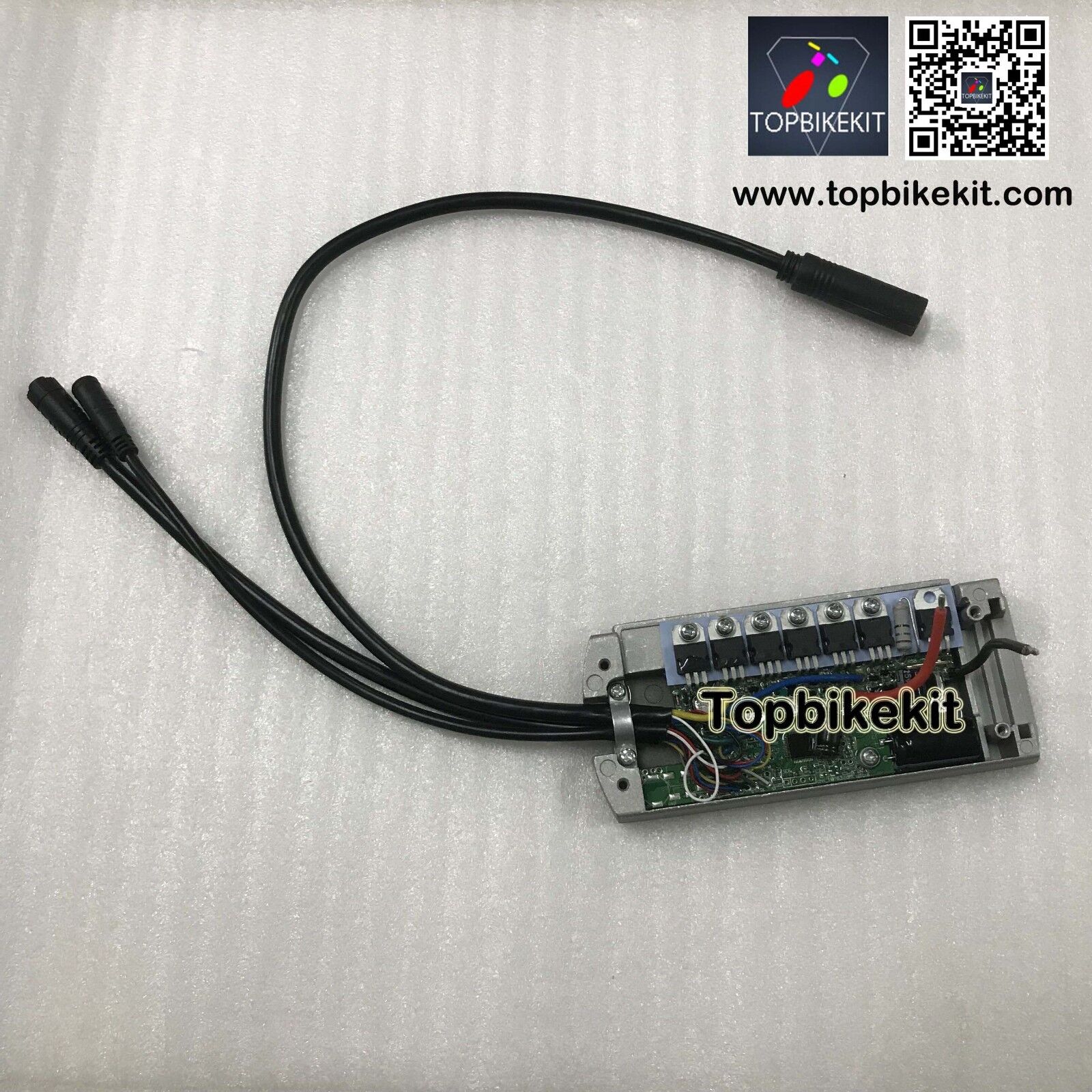

I am not being following other threads about motor controllers but If I wanted to do one, I would then make a substitute to the KT motor controllers because they are really cheap, so users could swap one electronics for the other but keeping the same metal case and possible wiring and connectors, because at least the metal case is expensive and difficult for DIY.
You are comparing the wrong KT motor controller case, as there are very small ones for the 250W motors. Since I know, that cases are kind of standard on the EBike motor controllers.mxlemming said:Of all the things you could possibly want to keep hold of, the enormous ugly metal box is surprising.
I will watch this with interest regardless, and if the results seem particularly good... I guess I shall have to make a fork To be honest, the DIY EBike community kind of needs a good alternative to VESC, which is... not especially good motor control with a shiny interface. While we'd probably all be better of with Lebowski code, the assembly and dsPIC is remarkably off putting.
casainho said:You are comparing the wrong KT motor controller case, as there are very small ones for the 250W motors. Since I know, that cases are kind of standard on the EBike motor controllers.mxlemming said:Of all the things you could possibly want to keep hold of, the enormous ugly metal box is surprising.
If you develop and EBike motor controller, then consider to integrate our EBike wireless, that works with Bluetooth phones and GPS cycling displays, all wireless.
casainho said:but keeping the same metal case and possible wiring and connectors
Your board would need to have advantages over the others other way why bothering?, so, putting a more powerful controller inside the same case would be a big advantage. Also if this controller is for DIY, then I would use extra space to add pads for extra DIY circuit / inputs, like analog and digital inputs / outputs -- this would be another advantage and distinguish between the other commercial controllers. For TSDZ2 we use an extra analog input foe the motor temperature sensor. And users look for other outputs for control lights. KT motor controllers are nice because they also have some of this extra pads / connections.mxlemming said:I'm not comparing the wrong one... The little MESC board in that pic can push many kW.... so I am comparing it to the 1.5kW KT case.
If I made a 250W board, it would be <half the size again.
