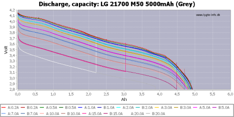

As far as sizing a pack of these cells, they advertise 3C, but no way in hell would you want to run them in that condition.
1C is still pretty saggy, at 0.5C, finally we start to get liveable voltage drop ( more voltage drop = less battery efficiency and more heat ).
Notice that the line ends early, meaning we either overheated, or the voltage sag got too intense and we tripped LVC, from 10A to 20A. So this range is basically unusable, and possibly dangerous without liquid cooling if sustained for a high period of time.
These would be a very good choice for a bike with a big range, and low to medium level power requirements.
For example if you are running 20A but also have about 20AH of battery ( 1C )
5.8 x 3C = 17.4 amps
No comment on that cell's performance until we see discharge graphs at various C rates.
Likely it is grossly overrated just the same, but, should perform decently at a 0.5C average.
