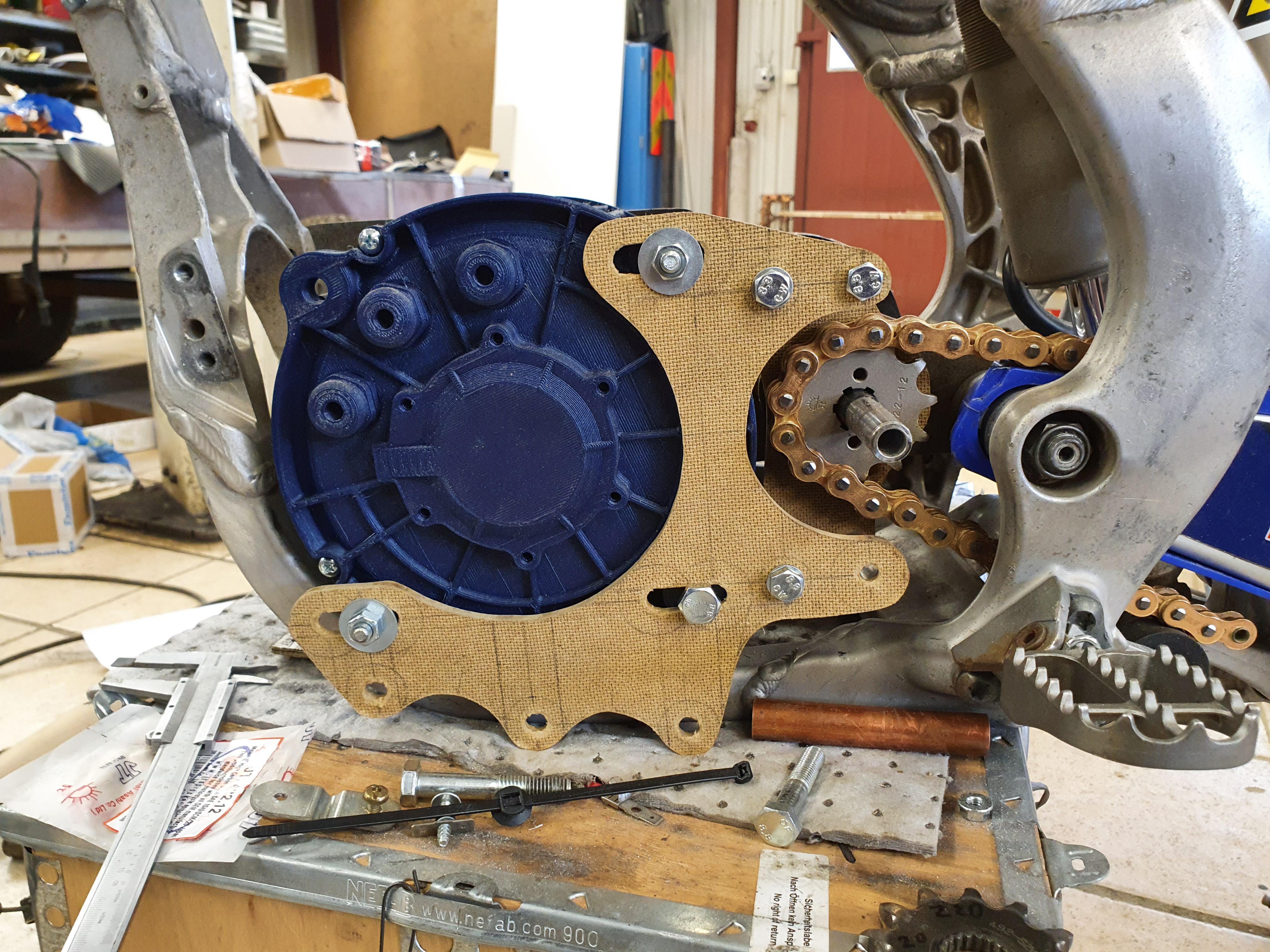

From my experience of 45 years with motorbikes, I would say: this is TOO TIGHT.
In any case I would add a chain tensioner of whatever kind (something with a spring or an oil dampener) in this primary chain drive,
since a chain is permanently changing its length, due to wear, and forces transmitted.
And I think, a possibility for moving one of those two axles would be required, for adaption of the chain tension
(as it is usually realized in motorbikes' rear swing arm axle mounts).
It is supposed to be 3mm between the chain and the housing to the rear of the chain, but this is more like 1mm..
I will make some changes and try to get the 3mm that I planned, I hope that will be enough.
Otherwise I guess the chain will make the room it needs :wink:
It should be possible to mill or grind out some material just where the chain are afterwords if needed, and be able to keep at least 3-4mm material for the sealing surfaces.
Do you really think a tensioner will be necessary for this short chain? I am trying to avoid it, to have less things that can brake..
The motor is movable back and forth to adjust tension. The chain will also be in an oil bath, so I dont think it will wear very fast.
It has room to move everywhere else, just not to the backside of that sprocket..
I understand the idea of having less parts.
If the chain is running in oil, this will sure make for less wear.
But anyway you will have to check it very often.
Usually even short chains in motorbikes' combustion engines have tensioners.
For example the camshaft chain of my Suzuki GSX400 :
I would guess it is not much longer than your primary chain -
and it much is less stressed out, because it only moves the camshafts, not the whole vehicle.
How big is the distance between the two axles?

I dont think you can compare a timing chain and a drive chain. The timing chain needs to have tension all the time to keep the timing stable. That is not necessary here.
I also worry that if I should use a tensioner it would take a lot more beating than a timing chain tensioner.
The distance is between 135 and 160mm. Im not sure I will be able to run 135mm, it will be very tight between the front sprocket on the secondary chain and motor. But 11/17tooth with a 36link chain will be 139,2mm or something like that, and I think that should work. 160mm will also be difficult to reach, especially if I have to move everything 3mm. I might change the max to 155mm.
I can get many combinations to about 142-145mm, and I think that is the best range to start with. Then I still have some distance to adjust when it wears.

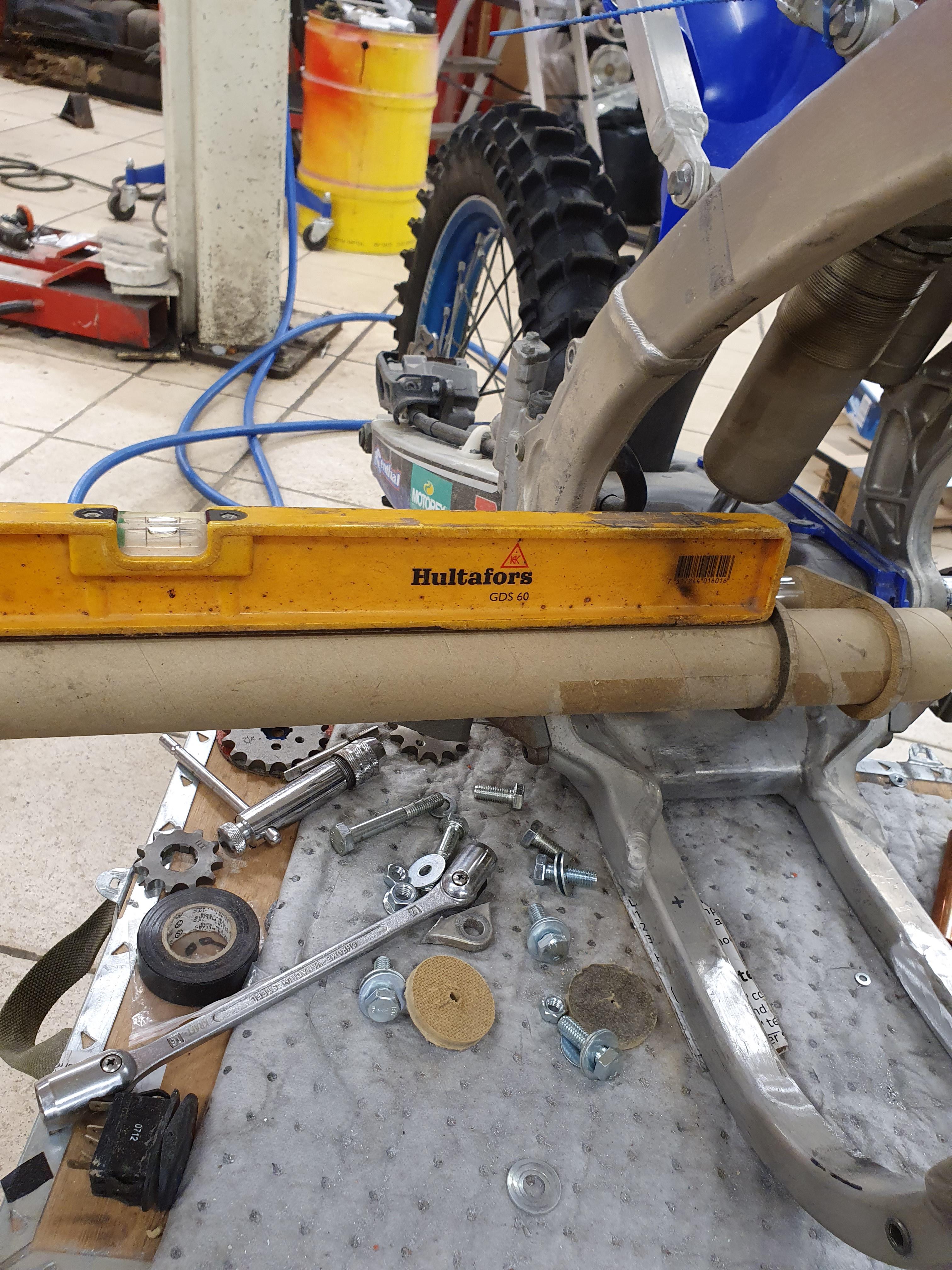

First of all great work! How important is it that the motor is completely aligned? Does a small angle make a big difference?
My build is starting in a month and I was hoping to weld the mount since I dont have access to a CNC. Guess alignments will be a bit tricky.
I dont really know, but I guess you can get an idea by looking at the chain and sprocket when spinning it with the wheel in the air.
If you can see that the sprocket dosent run strait in the chain it probably is to much..

How it looks now with the chain:
I hope this is enough room..
The other side with a new plate from an updated drawing.
It is not a lot of extra room for the batteries, they will probably end up at least 10mm higher than this.
I went for an extra bracket, I think it will be very stable without it too.
But just in case, and it should limit the stress on other parts.
