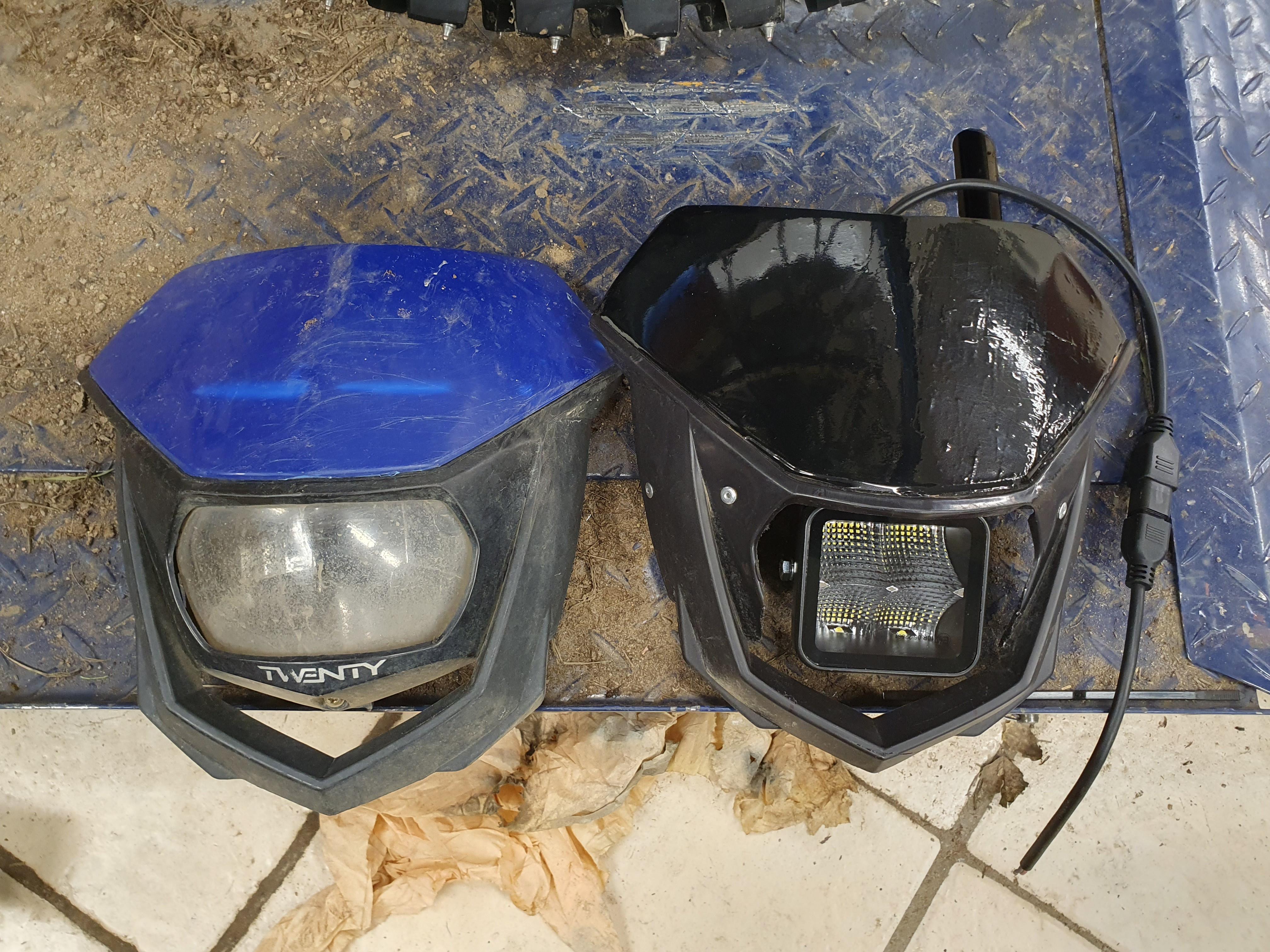

A little more on the light. I tried a H4 light, identical to the one I had on the bike:
And a 40w (confirmed to be true) led working light:
I think that will work fine and modified an old, a little broken front cover:
It wasent easy to fit the dc dc converter, but it eventually found its place behind the battery:
