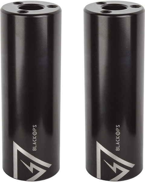

Can you share some details on how you did your foot pegs?
I have two sets.. the front (main) ones are literally just axle pegs clamped on a long bolt over where the bottom bracket would be. So remove bottom bracket and use long bolt and nut to clamp axle pegs over the hole.
The passenger pegs are tapped into the swing arm with M8 threading. They're some motorcycle slider pegs that retract if you were to low side the bike. They just thread in with M8 threading.
I think I get it but what is an "axle peg"?
Like these I guess:
Edit:
Wheely pegs worked great thanks for the tip.
