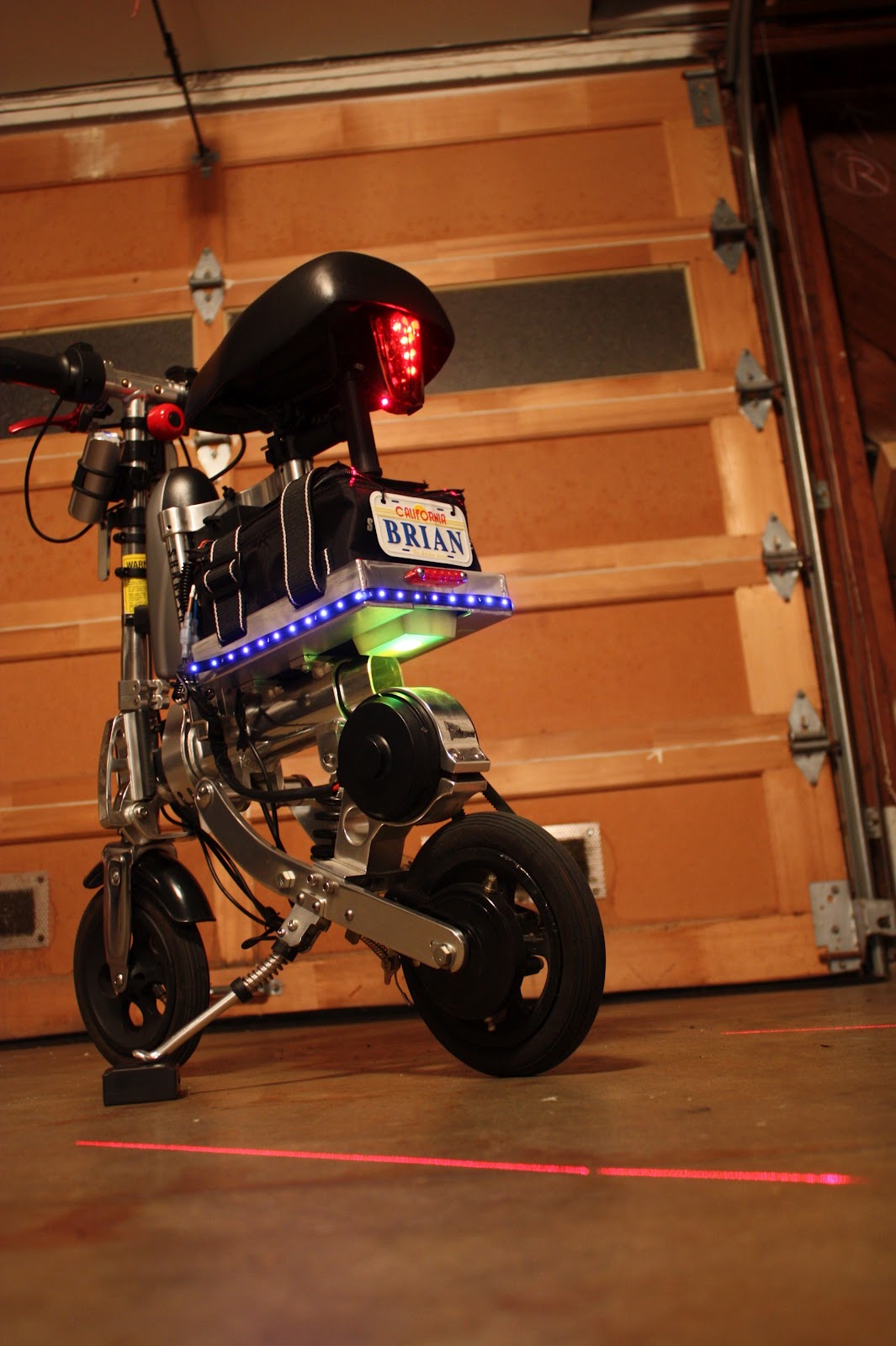

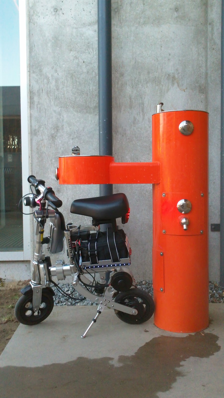

Maybe I'm cheating b/c it was electric to begin with. Regardless of that, it's gone through some mods and this is the latest pic from last week. The new mods since the last picture is the rear light, music speaker and relocated license plate. I also added the storage bin in the water bottle cage.
And of course the glow kit. AKA cheap LED color changing light stand that I mounted upside down beneath the battery tray. The pic here also shows the rear light with integrated virtual bike lane projected by the laser. If you want one, just type in "laser bike light" or something like that in your ebay search. Works better on regular upright bicycles where the laser line is much longer since it's mounted higher up and gets the clearance that's otherwise limited by my tiny little thing of a bike.
LED strips can be bought from ebay too. $3.50 gets you the 9v battery holder and spend no more than that again on the lights. Double stick tape and you're done. More info on my blog in the sig.

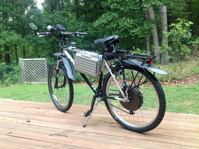

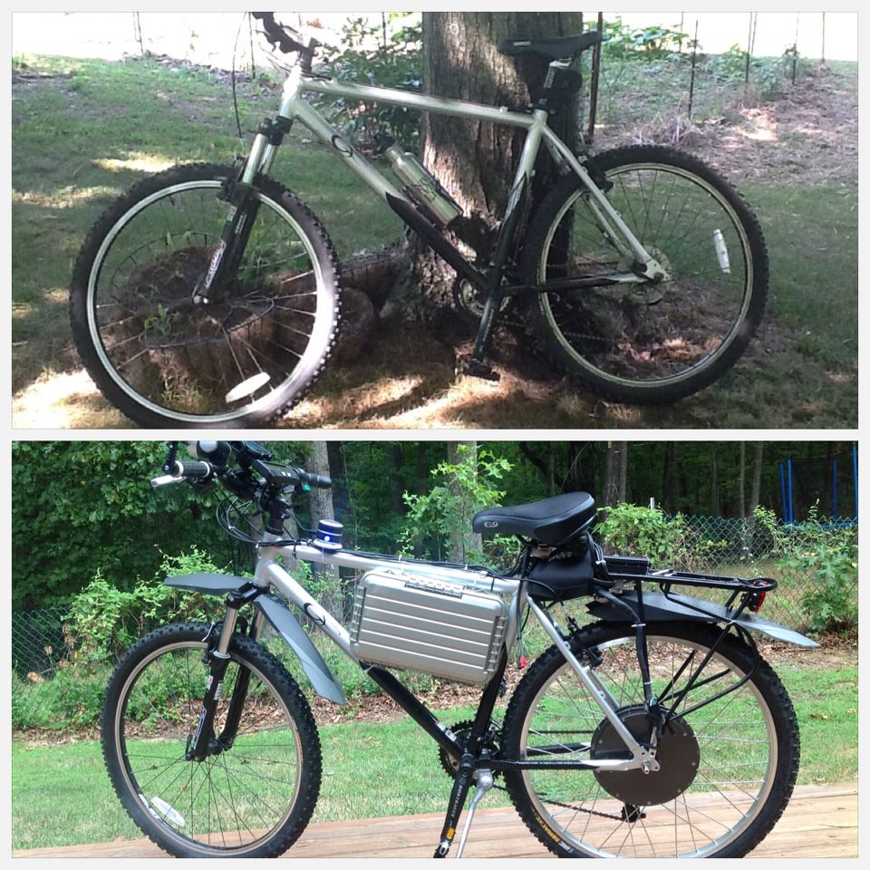

Here's my before and after that I just finished - my first e-bike! Thanks so much to everyone on this forum. I spent almost two weeks reading over posts here and doing research before diving in.
The bike is a mid-2000s Gary Fisher. Rear wheel direct drive HS35 Crystallite kit with 35A controller (from ebikes.ca). Battery is a 48V 15AH ping inside of a west marine tackle box (thanks to the suggestion by a fellow forum member). Additional accessories include fenders, mirror, cell phone mount, small rechargeable iHome speaker for music, rear rack and a million or so zip ties. I'm still waiting on the Ping battery to arrive but other than that, it's done! Really excited to give it it's first ride.
