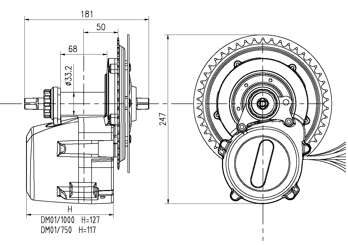

Am I correct that distance between cranks and frame is not even on toseven dm02 motor. According to my pixel counting in photoshop crank on drive side is shifted by about extra 12mm.
This is actually true, but not very different to all other motors like BBS01/2 or TSDZ2/8, the reason is the offset needed to accomodate the big gear under the chainring. You can make it even by assimetric crank set
Is there any reason why they do not even try to compensate that extra 12mm by simply extending spindle on other side? Looks like obvious solution to me. If i'm not mistaken cyc photon does not have this problem.

IIRC, the spindle length difference is similar in the Bafang BBS02 -> BBSHD motors - with BBS02 installs benefiting from (sometimes requiring) an offset left crank arm (such as the Lekkie set).
Then it would give very wide Q factor that is BTW the issue of CYC motors, measuring around 190mm. As far as i remember Yamaha motors do have it around 170mm making more side clearance and more convinient biomechanical force transfer to the pedal.

Between two evils I would nevetheless preffer symetry. I own cyc stealth and I do not have problem with q factor. 165mm + 12mm = 177mm. Still less than in cyc.

Situation looks much better in Toseven DM01. offset is only 5mm. Weird!
The distance from the mid line to drive side looks unchanged comparing DM01 to DM02 but the distance from mid line to non drive side is increased on the DM01. This means for the same set of cranks Q factor would be increased by 16mm on DM01. (re: 181mm total distance on DM01 is 16mm more than the 165mm total distance found on DM02. NOTE: The measurements of 165mm and 181mm as found on the DM02 and DM01 diagrams are not the Q factor. Q factor will be larger than these measurements owing to the additional width added by whatever crank arms are used.)
Overall though I'll bet getting cranks that would give equal distance from frame center line to both pedal spindles would be easier on the DM01. Definitely something to consider.
P.S. The unequal distance from from crank centerline to each pedal spindle is a very annoying problem on these DIY mid drives. That and the increased Q factor. (mid drives like Bosch as found on pre-built ebikes does not have the problem of wide Q factor or unequal distance from frame midline to pedal line.)
