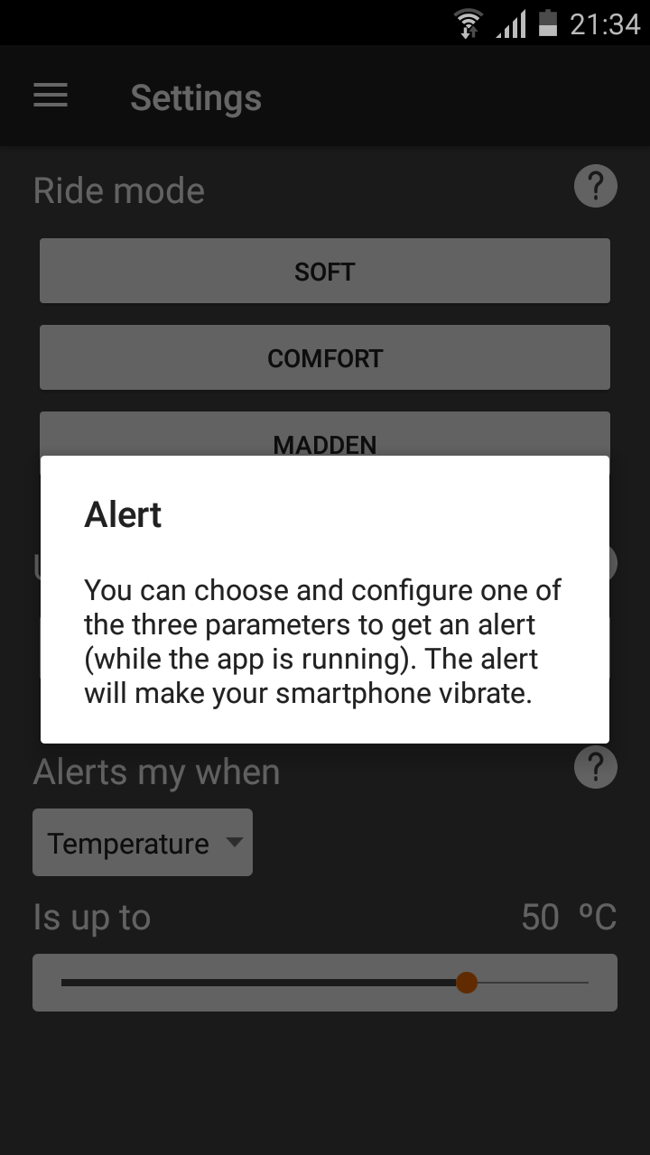

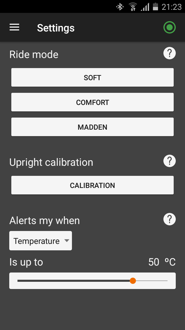

About the mobile app and SW102 innovation that we should try to do, is implement the time clock. We know that original firmware does no implement it but most of users want to have it (since I recall on the messages on this forum). This would make our firmware to have a clear added value and differentiation from the original firmware. (I am not thinking only on TSDZ2 motor, I think SW102 has potential to also be adopted by KT motor controller OpenSource firmware users).
To have the time clock, we really need to investigate and probably will be a work on both the firmware and mobile sides.
About the mobile app, once my girlfriend did a simple one for an electric unicycle that had a main screen and configurations screen:
[youtube]U1IkkHLnXI4[/youtube]
