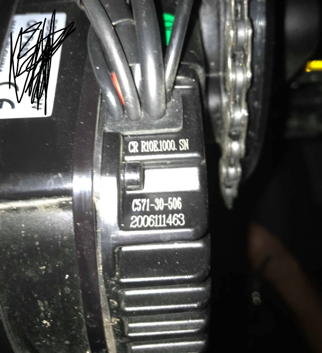

I am running a 48v battery on a 52v controller and this presents a big problem. Initially, power out put is strong, but it falls off fast and hard. at only 47-48v, the power drops off to 400-500w already....I have a 2020 JUNE version, the outer case is shown below:|
I would like to flash a 48v firmware to alleviate this issue...but I don't know if the supplied 4830 file will work. Can someone please help?
i have the same verson as u 28a controller and this software wrks fine now saying 30a
