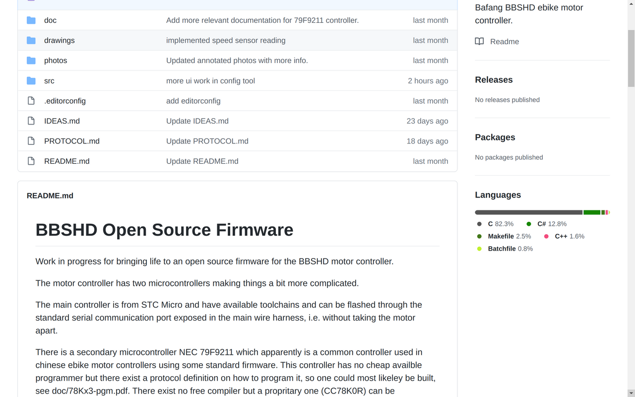

There is an OpenSource firmware development for BBSHD and seems the main developer has a version that works partially - see here:
- https://endless-sphere.com/forums/viewtopic.php?t=102148
- https://github.com/danielnilsson9/bbshd-fw
