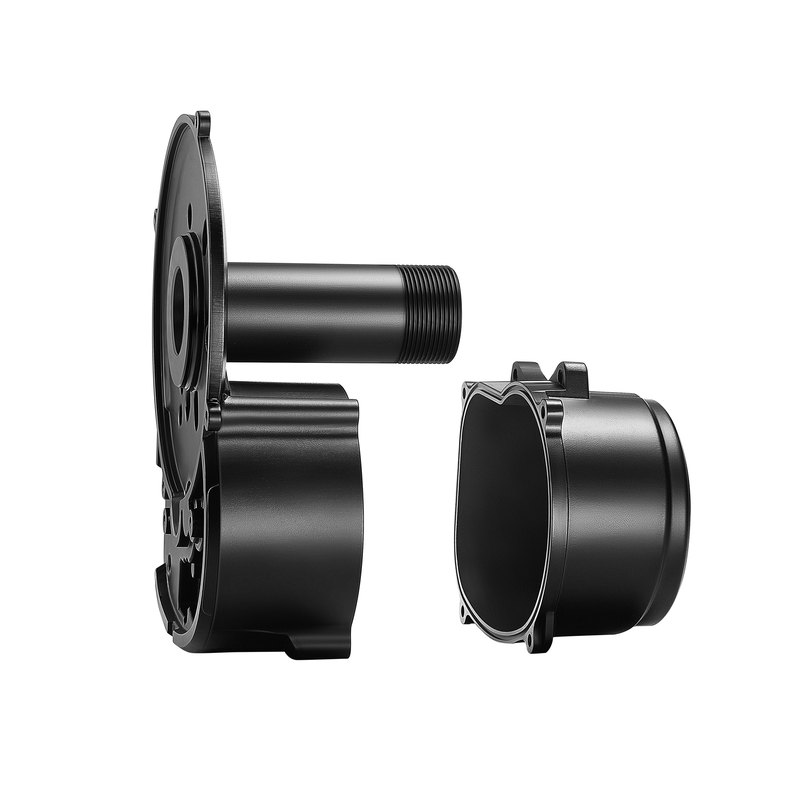

I recently picked up this broken tsdz2 kit (Has been given away) Broken TSDZ2 FREE (Preferred pickup in Brooklyn please)
If I can find the parts to fix it, it will be going on the Raleigh Seneca Mountain Tour.
Around $48 shipped from pswpower, if all you need is the TSDZ2 casing. Make sure it's the TSDZ2 and not the TSDZ2B,
Thanks for the link to the casing! Before I order it, I want to hook up the motor to the LCD3 display and throttle and see if the motor runs. Bike it was on was never ridden. The casing broke during setup (maybe due to insufficient torque on mounting bolts).
