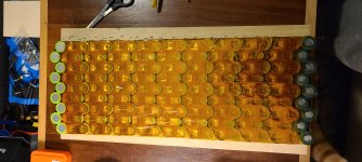

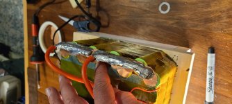

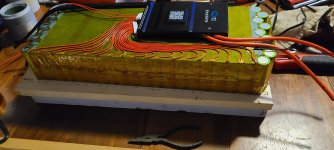

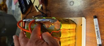

Battery is completed, BMS is live and all is well. Vsett 10+ scooter with dual Nucular 12F controllers. 50% charge with wheels off the ground, 59mph. Can't wait until the weather breaks so I can charge fully and ride. 30 minute test charge at 7a looked perfect.
Samsung 48X cells in 20s9p configuration for 43.2ah and 150a discharge. .1 copper sheets cut to custom shape and .1 nickel plated steel tabs. Main Bus Bars were L shaped pieces, soldered first, then spot welded to cell and finally folded on top of itself, secured the top fold with a few welds. Welder was Malectrics V4 on 12v marine battery at 30ms. Amazing performance from the Malectrics and welds are super solid. This was my first battery ever and couldn't have done it without the knowledge I gained from everyone on this forum.
Thank you for sharing the knowledge and hopefully the information I posted will help someone else.

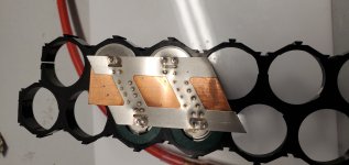

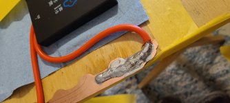

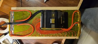

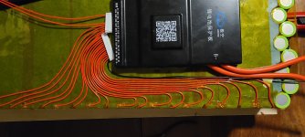

Not sure if this is of use to folks, but I have found this method to be really effective. Waterjet cut the copper busbars (0.9 mm thick) and solder nickel strips to them, such that the nickel strips can be pushed down onto the cell ends and spotwelded.
So far very reliable, especially when the whole surface is coated in filled epoxy and a layer of G10FR4.

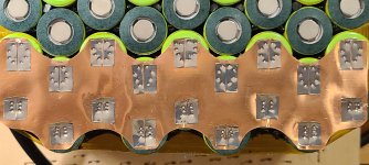

I never could get the sandwich method working reliably with my capacitor-based spot welder and copper electrodes. I suspect that this welder is a bit anemic, because even at the highest pulse lengths and infinite slots in both the copper and the nickel-plated steel, the copper just didn't stick very well. Also if I held the probe wrong, I'd blow a hole in the nickel at higher energies. I'd used it earlier to weld 0.13mm slotless nickel-plated steel only, which worked very well.
However, I read somewhere else on the forum that copper could be welded directly with tungsten probes, so today I got a 1.6mm TIG welding stick of pure tungsten, and cut it into spot welding tips. I first tried cutting it with pliers, but it split - it's quite brittle. Working it slowly with a dremel cutting disc at full speed worked nicely. I made the tips flat, with just a small chamfer to get rid of the burrs from cutting.
This actually welded very nicely, especially with an infinite slot, using only 0.1mm copper. Getting rid of the sparks thrown by the steel was also nice.
sounds like you have used steel or copper, but not both at the same time.
If yes, perhaps try copper with infinite slot, and weld with the steel cap over the copper.
I used both at the same time; 0.13mm nickel-plated steel on top of 0.1mm copper to be precise. I tried infinite and non-infinite slots in only the copper, only the nickel, and both. I got good welds sometimes, but not consistently, on used cells with some nickel remnants. The best welds were often sticking to the top of the remnants. I have considered grinding the remnants off for the build itself, but if I can make the tungsten-copper method work reliably without doing so, it'll save a lot of work. 20s17p 18650 is the plan, and the cells will be loaded at <1C max, for a very long range (or long life, I'm not sure how my usage pattern will look yet) moped battery.
Here are a couple of rows of test welds on some junk cells using 1.6mm pure tungsten TIG stick probes. The offset welds on the lower row are just an artefact of sloppy cutting of the test ribbons. The upper row of welds is on the positive pole.
Edit: my inspiration for trying tungsten came from this post: https://endless-sphere.com/forums/viewtopic.php?f=14&t=84680&p=1584958&hilit=tungsten#p1584958
Edit 2: I tore off the strips, and made a few more passes. Most welds were ok, a few were great, and a few were duds. A few too many in fact. I'll experiment more with my technique, and maybe try some cell surface preparation as well. A bit of sanding or brushing. I don't need super strong welds, but I do need a bit better consistency.
Some observations:
  • If the two copper strips happened to come in contact somewhere, they would spark at the contact point when welding, even if it was several centimeters away. A testament to the value of the infinite slot for copper.
  • It's easier to identify the weldable area of both positive and negative poles when you can glean the position of the pole through the slot.
  • The probe got a lot warmer than when using copper tips. Some pauses may be needed when welding lots.
  • One of the tips eventually became copper coated and had to be sanded, because it started sticking to the ribbon. I don't know if this has to do with the tip, the polarity, or just random chance.
