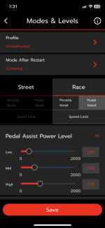

Well, the photon still suffered runaway temps and down-throttled.
Here's my power settings:
and here's my screengrab during my climb:
It is hard capture the throttled power levels because it doesn't stay constant... it bounces around while trying to keep from melting, but the lowest that the motor down-throttled to was 495W.
This is a 500W nominal motor.
