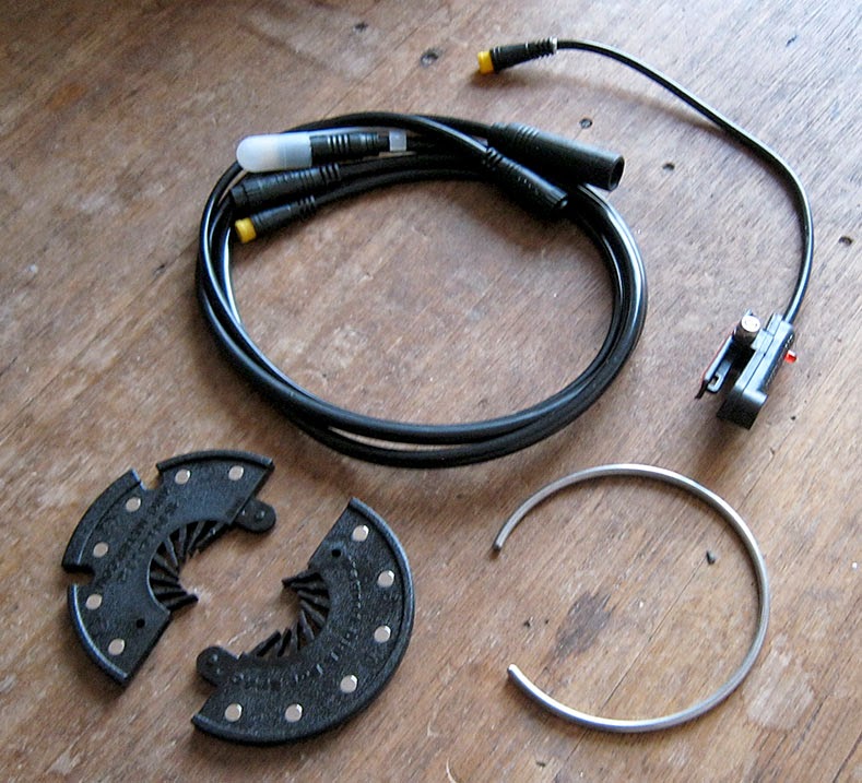

1st ride on the bike path in the drizzle - PAS stopped turning with the crank. The grit off the road is just causing a little too much friction between it and the bottom bracket. I'll put a drop or two of super glue between the PAS and the pedal crank this arvo and see if that locks them up a little more - not going to bond them, just want a little more friction on that side of the sensor and less on the other. Otherwise I'll have to file a bit more off the plastic cap around the BB.
With the PAS not working I used the throttle to help me up the hills and pulsed it when I dropped below 28 km/h on the flats. The 20km is fairly even uphill and downhill, overall I averaged 27.79 km/h, no-one passed me and still had 50% battery showing on the lcd meter. Previously without the kit, I would not have ridden this morning - but I really enjoyed the ride and was over 10 mins quicker than any times on this bike with pedal power only. And I'm now setting target times to chase on my roadie.
Hi Tats,
Good idea on the drooping cable to reduce water ingress.
Sorry to hear about the sticky PAS. It needs to be keyed-in somehow. Superglue works but just be sure to rough up, clean then dry the bonding surfaces. Hot glue might be better since it's got more "give" and volume.
Thinking aloud; a better solution might be to have an optical trigger to detect spoke rotation. That way it would be out of grime a bit. The trigger would, like the existing PAS need to trigger only for forward motion.
I've found the throttle twist is a great assist for getting away sharply from standstill.
I got passed this am by a MAMIL in full garb but he was desperate and did it illegally up the inside and scored the green light so that doesn't count but it still annoyed me ;0)
I reckon I'll hot-glue it tonight - had the same thoughts. I'm sure a super glue will get me home. I may put a little screw/nut through the pas to pin it up the pedal if it proves to be a 'feature' that the glue doesn't resolve.The PAS is quite thick and a quality plastic.
** Update ** Just had a look at the PAS and the amount of sand round it from the bike path - I've decided to drill a couple of very small holes in the PAS and put a small cable tie through these to attach to the pedal crank. Better than glue imho.

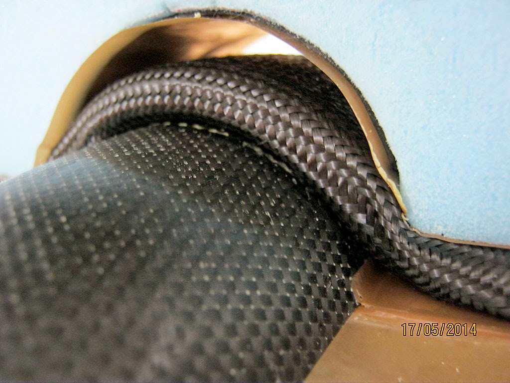

On a slight tangent; just laid-up the front guard tonight; 5x 93g plain weave carbon on a 30 degree bias (so it goes around the curves,
plus 5 patches of more carbon for where anchors will go. I'm just winging it intuitively.
With Gladwrap to provide the final finish surface :
Resin almost cured, needs another night, temperatures in Tas are pretty low at the moment and my workshop isn't heated.
So in the meantime, I made up the Dremel jig based on an idea by an expert scratch-builder on ES but I can't find his build thread ;0(
Good.......... Maybe 12 magnets aren't enough ?
Maybe what this PAS needs is double to 24 or one continuous magnet.
When I receive this kit tomorrow I won't be using the cable ties........ I'll be using thin Velcro strips which provide zero cable resistance for setting up and easily removed for maintenance.

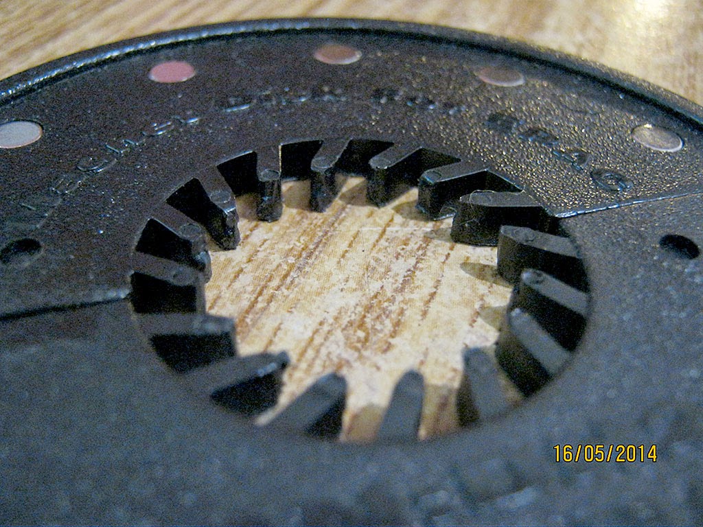

New PAS arrived.
AemGbypA357lz6rFrAA40g7-KtpHAjW5uYwj_aa7GDo=w789-h717-no
Any idea how to mount it on a Shimano Hollowtech II Bottom Bracket; SM-BB51 ?
The Magnet Disc has flexible splines that conform slightly but they don't conform enough to make it easy to fit on a Hollowtech BB.
It probably fits a charm on thinner BB.
Solution: cut the thinner ends off the splines.
The ring now fits and fits with sufficient "grab" so it doesn't rotate and mis-read. It's as if the length of the thicker
splines was designed to fit the Hollowtech.
6G3KnMX4jvrrY421lnjm3BA_iHIeheR0pzQVXCe8-NM=w1024-h768-no
New PAS is working well so far. The adjustable hall sensor needed some material removing to get it to fit thanks the size of the BB on my bike.
Apart from that. it was fuss-free.
The assembly; ring halves, circlip and sensor weigh a lot. I didn't have the foresight to weigh it but I can imagine the equivalent optical sensor would weight a lot less.
Mudguard mount continues:
Kevlar/ carbon hybrid sock and carbon sock laid-up over 4mm foam. Blue foam mock-up provided dimensions on where to cut it after it's cured.
Guard mounted securely, foam block taped and waxed :
IHSl2wzDv3f3yg8VyoguvKI-jGZkn0rVBBtrXooRni4=w1024-h768-no
Foam mock-up pressed down over the cloth and guard using lead weight. Left to cure :
8c684By7kt8tRma1qS0uUHgroMXgInV-zcQyLFmbauI=w1024-h768-no
Fully cured. Marks for cutting to fit the fork are left behind. Light and strong.
