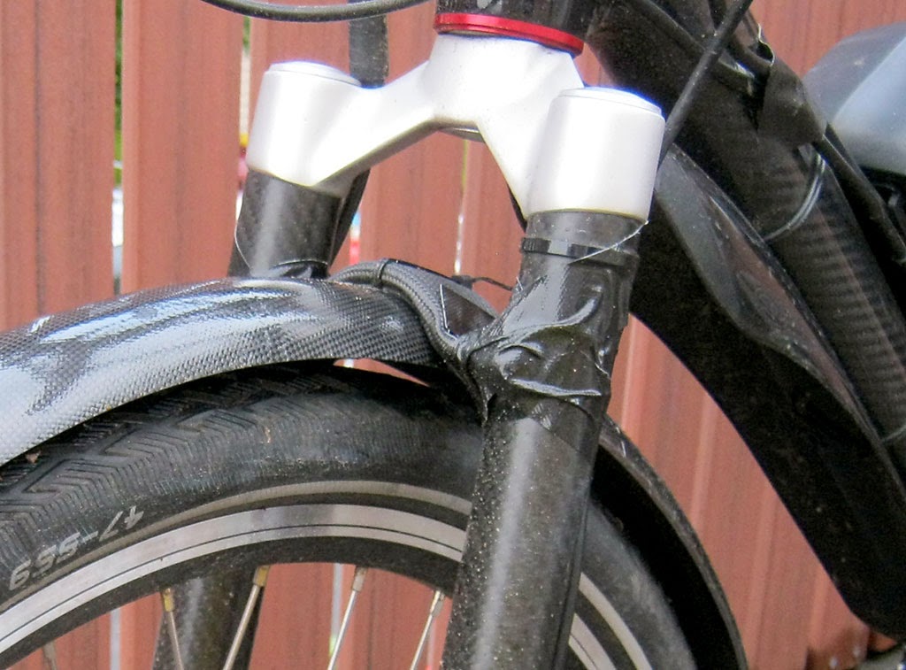

Lashed the mount and guard onto the bike and took it for a spin.
PAS is AOK. No mis-reads, just smooth power when needed.
The mudguard works. I found the biggest puddles and ploughed into them at speed and the spray is contained. It might look a little "ungainly"
with such a pronounced forward bias but it works.
I'll make a support for it, it's not going to be durable without one. 4-40 clevises from aeromodelling will be a perfect adjustable mounting too.

Loving the mudguard mate-looks very pro.

Thanks Tats. I'll work out the mudguard mounting system soon.

Good work on the carbon mudguard. Didn't know it was possible to make carbon parts without a big curing oven.

I have to confess I still haven't got around to making a proper mount for the front guard. It's still just gaffered on.
I'll make a front mount and rear guard over the next month or so.
The rear guard (Crud Catcher) isn't very effective, the mud / water
is prevented from hitting the rider but the poor bike cops a drenching.
