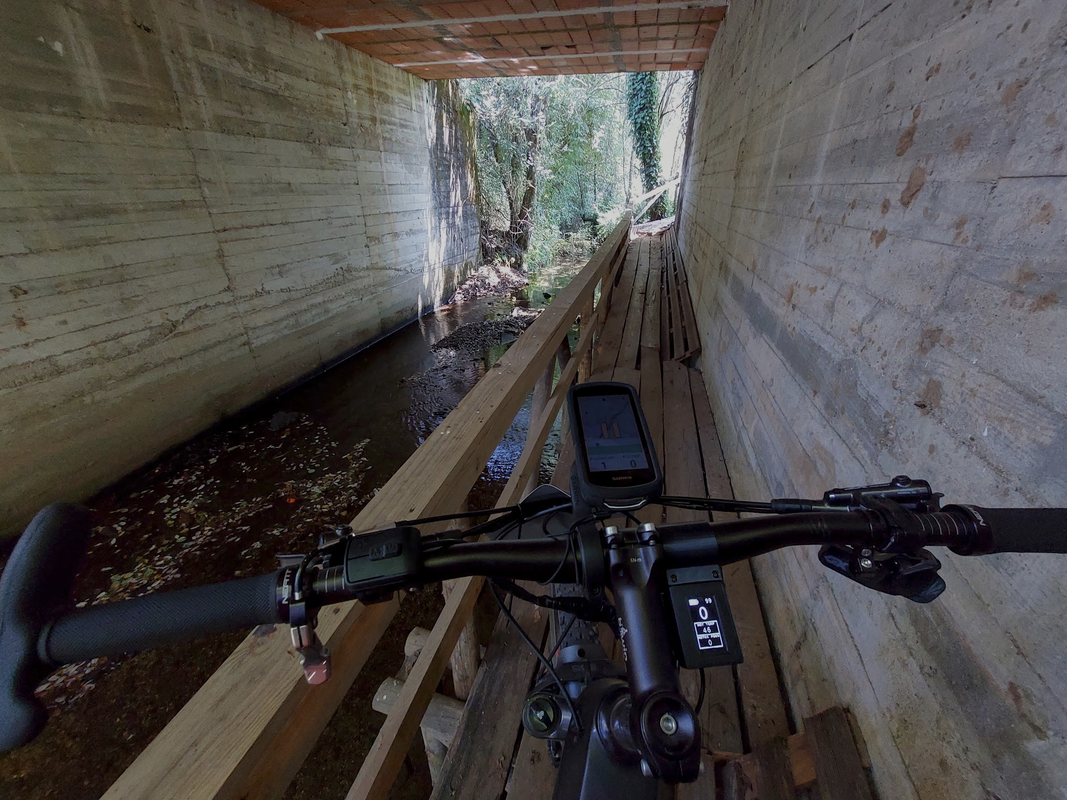

I think Bafang M500/M600 only puts the motor temperature on the CAN BUS, not the controller temperature.
And yes, the display shows the motor temperature and that is very important to control, see here my recent experience:
Other thing I forgot to mention is that my motor got hot, because I had a lot of hills and the weather was like 35, I could feel the motor burning and I could not keep my hand on it. The display was saying like about 72 and so I kept and eye on the display and I stooped like 10 different times to wait for temperature decrease up to 50 or 55 degrees.
Even if the motor controller firmware should protect the motor, I was afraid and get near the fatal motor demagnetization I already had on TSDZ2 at begin when I did not know about this -- read here all the details of motor fatal demagnetization due to high temperatures: https://github.com/OpenSourceEBike/TSDZ2_wiki/wiki/TSDZ2-motor-demagnetized-due-to-overheating
Example when my motor had demagnetized due to high temperatures:
casainho said:
Yesterday I went to the mountains and I did cycle 140kms and it was hard. That gave me the opportunity to real test my EBike with M500 and I would like to share what I found:
1. 52V battery with a M500 48V motor: My M500 was bought as a 48V battery but soon I found it would start to limit the motor power very soon when the battery was like at 50% SOC. Since I built my own battery, I decided to add more 1 series from 48V 13 to 52V 14S, as recommended by one user, so the motor power limitation would start later. And this worked very well!! The SOC on the display was 99% for a long time, because the M500 was calculation the SOC for a 48V battery. I also could see that at 40% SOC, the motor was limiting my motor power at up like 220W, which is not bad since now the 40% SOC it is for sure a real lower SOC than 40%.
Now I need to fully implement the SOC Coulomb counting on our EasyDIY display, because the original SOC of M500 is totally wrong.
2. Walk assist does not work: I mean the motor rotates but at very slow speed like 2 km/h and has very low torque meaning that it even can not push at all the ebike on the hills, the motor just stops on the hills that is when I really need walk assist.
3. Electronics gears are perfect not related to this motors because they are modular (unlike the electronic gears just released by Shimano that only works for their electric motors), the SRAM AXS, worked flawlessly, perfectly, while my previous mechanical gears would always missing some gear and that was frustrating because I want to pedal as smooth as possible. The M500 works very well, so the external gears need to be on pair with the motor.

I am being away of development, many things going on on my life but anyway I am doing more and more sports - I keep riding my MTB EBike for events of 80 kms on mountains, but I also now have a road / kind of gravel bike (no motor and love the silent!) and I like to ride it. I am also doing trail runs and some swimming - that is why I do not have free time but at the same time am getting better fit with better health and not needing so much a motor.
Just a warning, I recently had an accident at slow speed on my EBike, when doing an MTB event, where I did brake by instinct when something got in front of me. I went with my mouth directly to the road, I lost one teeth, I have problems on other tooth, got some problems on my mouth and face. I will take months to fully recover and It will be very expensive!
Here is my new helmet, this time it will be a full face one - just be aware that this accidents happen and we now have full face helmets that are light and good for pedaling on the trails:
