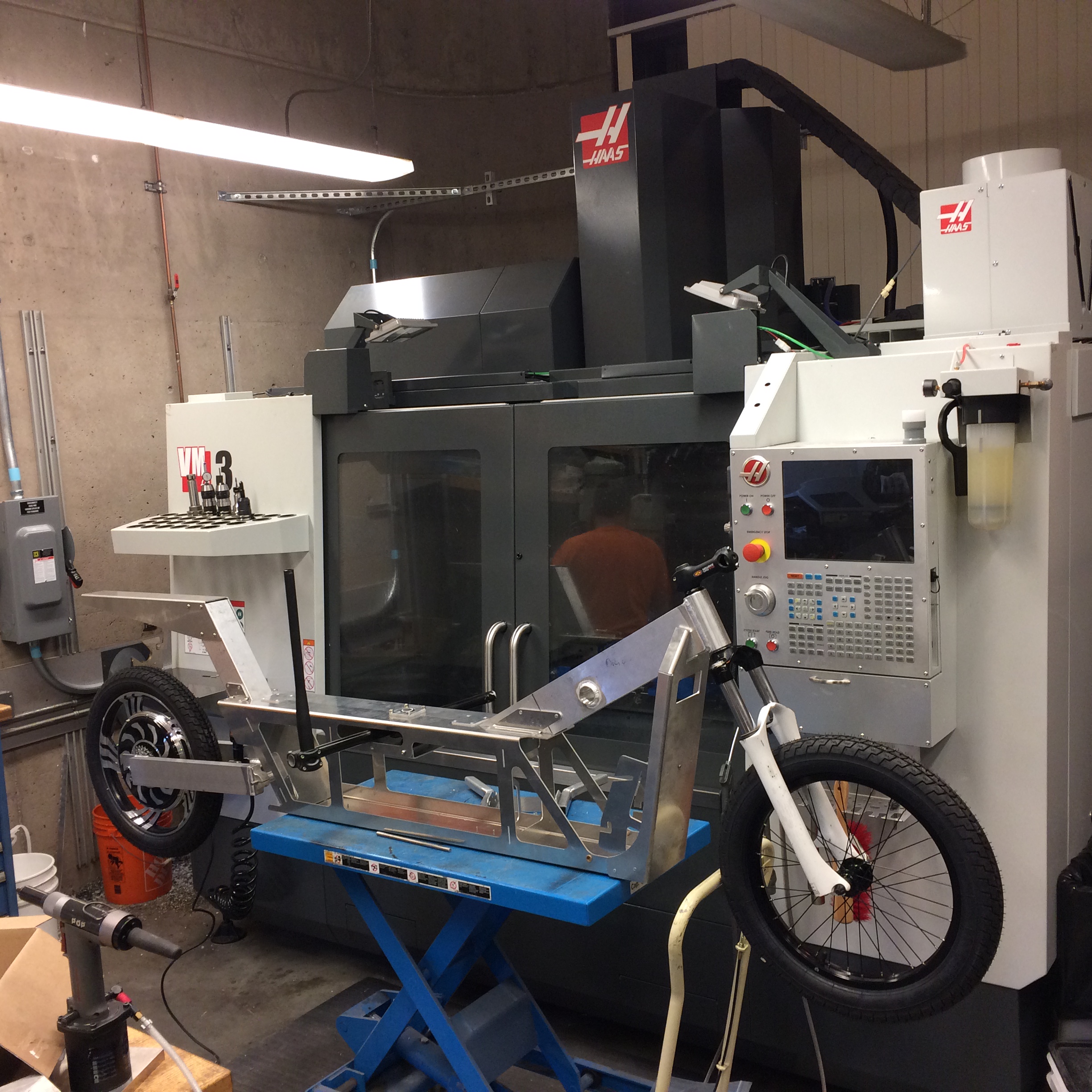

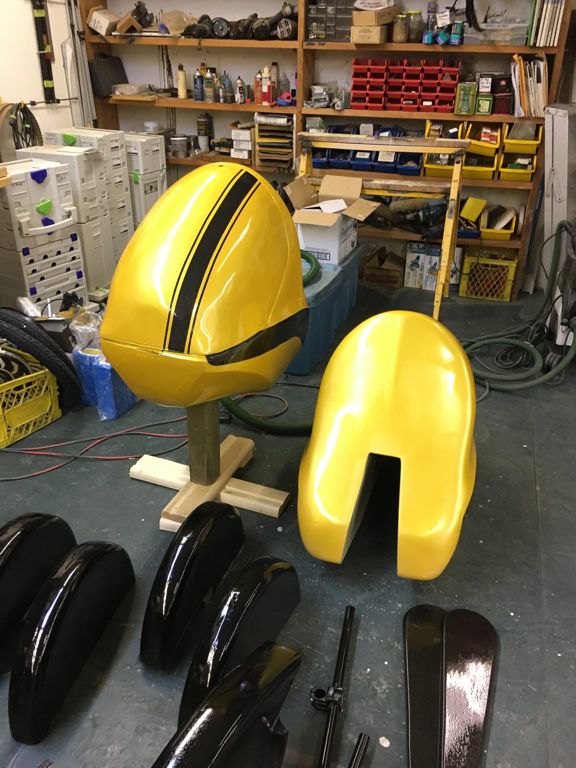

We are just completing the first run of production bikes and it has been a real learning experience! The molded Carbon Fiber parts have turned out to take much more time than is realistic for the price at which we would like to sell the Electrom, so we are looking at which parts absolutely must be made in this way, and which could be produced more economically with other methods. We will revise our offerings and produce another run of Electrom in the fall of 2021.
Currently the hand-made carbon parts include the Tailbox and hatch, the Footwell, Bubble Support, Swingarm covers, Fenders and Pedalling Station Cowling. The reality is that only the Tailbox and Footwells truly need the strength and weight savings that custom molded carbon fiber offers.
In the meantime, our first two lucky buyers will get to start riding their new Electroms in the next month.

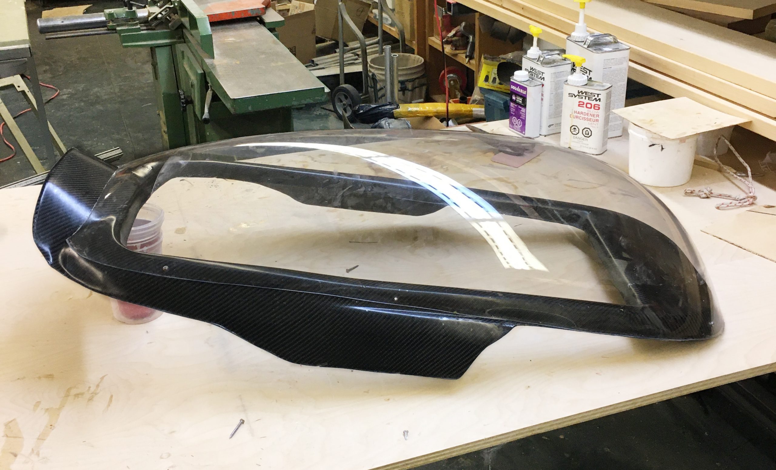

Ah yes, the old "can you make the windshield higher, lower, further away, closer?" question.
I agree, with your assessment, because the Electrom looks fast, folks tend to think of it as operating at motorcycle speeds. It is undeniable that a head-on crash would be unpleasant no mater what the height of the windscreen is. It's funny how many people obsess about that considering how rare it is on a bicycle class vehicle. Here's a little traffic video to give your gal an idea of the speeds involved.
[youtube]Mkt3S6vFOJ0 [/youtube]
I've tried a number of windshield configurations and they all have compromises:
- Higher and you risk taking the windshield in the face in a crash, and if it is above your eyes you would need a windshield wiper on rainy days. I also ruled out an over-the head full covering because of the need for windshield wipers, also too much surface area presented to cross-winds creates handling issues.
-Lower and your knees bump while pedaling
I was curious if a higher windscreen would clean up the aerodynamics and it actually made the bike slower. I guess that while my head poking up is aerodynamically messy, it is still less overall surface area.
The height of the windscreen is adjustable in order to accommodate different size riders but it generally performs best at the rider's chest height.
That makes sense. Your reasoning is good.
The lip at the end of the windshield also helps distribute the impact to a wider area of the body if it were to happen. Better to be hit with a thick pad and have the windshield be designed to deform than to shatter.
It is funny to even be thinking about crash safety on a bike. But with this sort of bike, we have a lot of possibilities to save the rider from harm. :)
Indeed. I've actually modified my mold to add a wide lip on the edge to do just that. The poly carbonate component of the windscreen is actually quite thin and flexible so on impact it would definitely deform before shattering.
