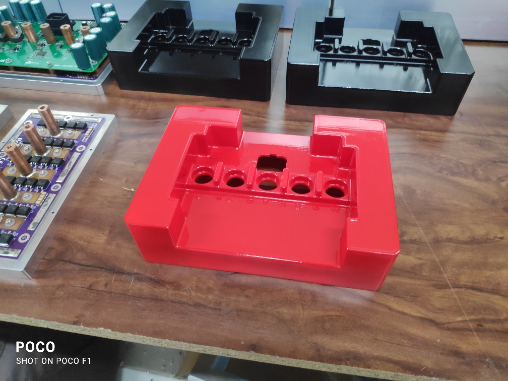

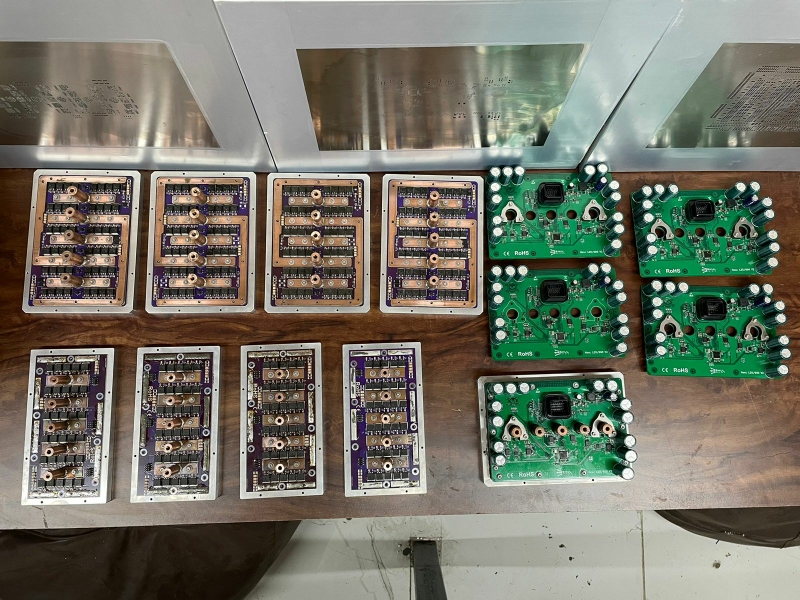

@scianiac I am not much active here on endless sphere. first pre-production batch have been sent to few OEM's as well as Retail customers. Here are some pictures of pre-production Unitstop.jpegside.jpegcontroller.jpeg
The production units are under production and no Pictures of the units are available at the moment. Maybe 2 more weeks and we will have it all.
preproduction version is tested for more than 60kw and peaks at around 1000amps phase and 600 battery.
