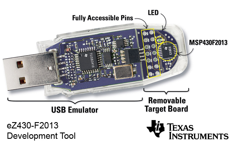

This thing is only $20
You get the emulator/programmer + 3 target boards.
The target board is the tiny rounded part at the end.
For those of you who dont know what you are looking at - THIS THING IS AMAZING. The thumb drive part allows you to not only program and power the chips but you can also do in-circuit real time emulation... i.e. you can actually go into the code and set breakpoints, monitor values, pause the code and change values... right on the real hardware. Totally changes the game. You can code it in C++ to with dynamic memory allocation, OOP and the works.
After you do you magic just pop the little booger off the end and you are set! Solder in a single cell Lithium and it will run for 30 years.
These feature either an MSP430F2013 or an MSP430F2012
Additional target boards are $4 each
The A/D is 16 bits and you can do all the fancy stuff.... Auto scan and all.
The sleep current is sub 1uA, but this thing can sleep like 90% of the time
I develop 100pin devices that use only 250uA on average
Here are the chip specifications:
