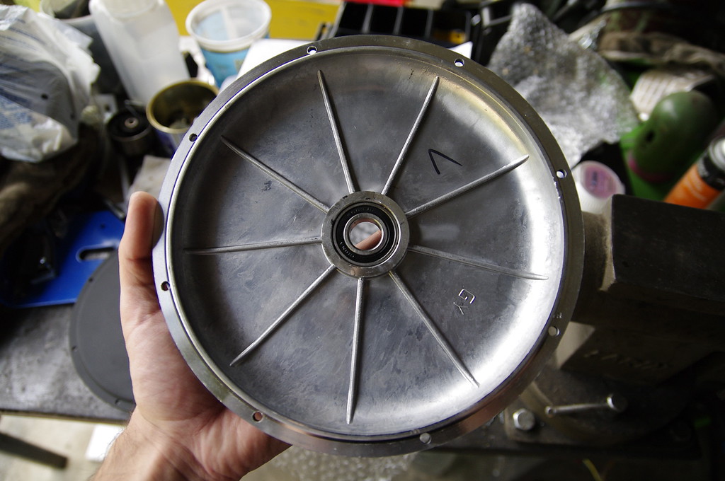

So I just cracked open my Leaf motor for the first time. I plan on changing phase wires, bearings, painting it, cutting vent holes, and adding cooling fans...it's the whole lot for this motor. :D
Things I notice:
The side covers are strange...those cracks are just on the surface, so not structural. It must be a side-effect of the way they make them. Anyone care to comment?
The windings are still perfect. I got it up to about 80C on the covers a few times, but it's still in great condition.
The bearings are bad. I've only gone on a few off road rides on this bike. They feel like they have sand in them...just bad quality I guess.
It's great that the holes in all the motors are roughly the same size...makes fan cooling mods much easier. :)
Cheers
Yeah the crazing on the outside is from the casting. That's simply an umachined surface for the side cover interior, so you see what the mold looks like. I noticed one of my bearings was a tiny bit crunchy too. Kind of to be expected; In my younger days I installed a really nice quality bearing improperly and it exhibited similar results, could be the bearings are cheap, or could be they were pressed from the wrong surface. How'd you push the bearing out of the side cover on the phase wire side without cutting your bundle? Still trying to figure out a reasonable solution for this that won't shoot parts all over my shop when I throw it in the press... I don't have tube that large of diameter to just make a spacer for, and I assume the cover needs to be held by the perimeter to not damage it. (bearing has to stay on the shaft while cover comes off)
It's simply an unfinished casting. How many people do you think actually look at the inside of a motor? Manufacturers don't think about making the inside "pretty". So long as there aren't voids in the casting, it should be fine.
uc

I do not like the look of that. I hope that it is just poor finishing.
You might be the first one to get a funky cover.
Thanks all for the comments on the side cover surface. It's hard to see from the photo, but it's really only on the surface, so I'm not overly concerned. Nevertheless, I've emailed Leafbike to ask them about it just to be sure.
I plan on drilling the side covers soon anyway, so if the cracking does extend into the main metal itself I should be able to see it in the cross-section of the drilled holes.

There is a reason it is marked with a X, unless you put it there. No such thing as cracks just in the surface. Every one of them is a major fault where cold material failed to solidify /fuse fully before cooling or cooled too quickly at the surface. If you used die penetrant ( http://www.zoro.com/crc-weld-check-penetrant-105-oz-03106/i/G5180445/?gclid=CP2twKP9z8gCFcEXHwodWO0O7A&gclsrc=aw.ds ) on this I bet you would find it is much more than skin deep. I would make sure you can get a replacement cover before you make it even less supportive with vent holes.
I'm not so sure about that. I emailed them and got this response:
Hello
It’s normal. Motor may work in the rain or web environment. Shaft is steel, will be rust.
This rust will not effect noisy.
If you would like to pay shipping cost, we can send new cover with bearing to you.
Not that the explanation makes much sense mind you...so I honestly don't know at this stage.

Also, for what it's worth, all of my side covers show this sort of "crack" like outer surface irregularity. In my case it's not cracks, as the lines are convex, not concave.
You can see it to a far lesser degree here:
For your own reference, the bearings in the side covers appear to be glued in with some sort of bearing seat adhesive. I typically see it used in car parts, but this is the first time I've seen it in a motor. It's why I said I need a way of removing the bearing from the cover without destroying the cover.
The covers of my Goldenmotor 9C clone has similar but slightly less extensive surface crazing as that. No doubt potential stress raisers, but no signs of failure yet.
No doubt they will try to ignore the questions of the bad flow / surface cracks as someone in management decided to ship borderline parts. Get some new covers. No excuse for this. Normal to see grain boundary blotching, but when cracks are throughout as on the photo, they should never be used in a structural application IMO. This paper is for zinc but will maybe help a bit understanding the dynamics of the casting process. http://www.eazall.com/classification-of-zinc-die-casting-defects
The bearing is most likely held with a retaining compound. Ask them what the release temperature is or what exactly is used. It will tap out easily with a wooden dowel once you get to the correct temp. 250C for most. Wear old winter gloves. :p http://www.henkelna.com/industrial/retaining-compounds-14963.htm
New freewheel side cover on it's way. :) $40 shipping :(
Nothing was acknowledged, but the fact that they are sending me a replacement kind of indicates it is not normal.
