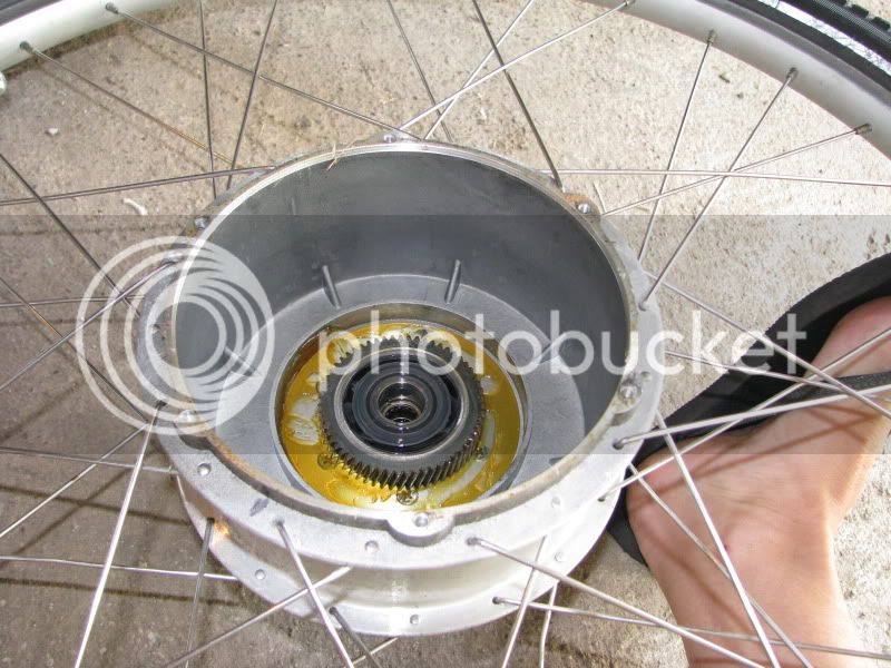

I do not have a clue what I am doing. Took to much apart I think. I am trying to take the motor somewhere tomorrow to have it spot welded as you suggested. But I do not know where to tell them to Tack it, even which side--don't know what is suppose to spin and what is not.

I would like to ask if they have to remove the screws and remove the cover and tack from underneath or tack down beside at the bottom of the blades where I have the white arrow? Just in case I end up at a muffler shop. :?

The sharp things you call blades are teeth of the gear. Anyone who is smart enough to weld it for you, will know exactly what to do. If they are at all puzzled, take it somewhere else. Maybe try a trade school where they teach mechanics or welding? If the gear is spinning, why does it not just pull off? If it pulls off, clean it and the shaft of all grease, really clean. Is there a bolt or clip holding it to the shaft? Is there a key in the shaft that is supposed to drive the gear?

Could we have a picture of both side of the big gear?
From dnmun"]wipe the grease off the end of that little gear. you will see where the motor shaft turns inside that gear because the gear just slips onto the end of the shaft when they manufacture it and that is not strong enuff without a keyway to lock it on the shaft. it may now be loose enuff that you are able to pull it off by hand.
i was able to pull mine off and so i cleaned it and used the JB WELD epoxy. that was when i discovered bearing retainer too. love that stuff. like superglue to the max.
but if you are gonna weld it, then have them weld it on the end of the motor shaft inside the gear exposed when you wipe the grease off. spray the solvent right onto the end of the shaft so you can see the line where the shaft turns inside the gear, on that end.
the guy needs to tack that shaft to the gear without getting any welding sputter onto the gear faces so just light tack at low heat is best. he can put the ground clamp on the case, ask him not to build the weld up high or it will rub on the case when you put the end back over it. just tack it to keep it from slipping on the motor shaft.
So the weld should go here at the white spot? It is Teeny Tiny and shaft is 1/8 inch down in the hole. I have a very nice mechanic looking at it right now.
yes at the joint between the shaft and the gear on that end. you gotta clean the grease off totally first. you can push the gear down to where it is flush on the end. the gear has moved up on the shaft and rubs on the inside of the cover opposite, you can see it in the tracks in the grease on the other piece. that is too far out so push the gear down flush to tack it.
New development--Mechanic said gears on motor don't seem to be slipping, actually motor looks brand new on the inside. Sorry I don't have a pic of big gear, we did take it apart but it is still with Mechanic. We have found what may be the problem
the gear here is spinning frontward and backward freely. So when the small gear on the motor is spinning against it is not turning the wheel. The other side that holds the chain only spins one direction.
ok, that should freewheel only in the forward rotation of the wheel. there should be freewheel pawls inside that gear. i no longer have mine open to look. sounds like that guy already has a clue. but it did move eventually in your video so it is not totally free, gotta look underneath that gear imo.
That gear mounts on the one way clutch.
It shold only freely rotate one direction.

I opened my extra 24 volt motor and googled the part number csk25-s-n-d-c5 on the one way clutch and this might help
