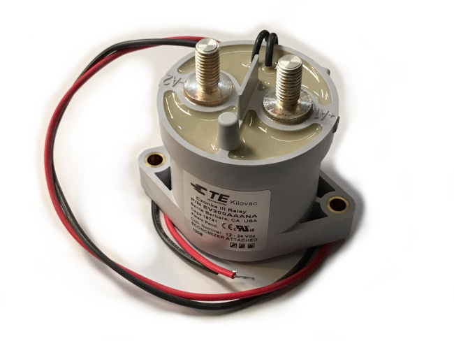

Has anyone used those standard kill switches found on traditional (non-e) bikes? (my Suzuki had it too, of course)
And for a setup as high as 100A - Which switch holds up? Anyone has experience to share?
That kind of switch might handle an amp or two. Anywhere near 100A would melt the wiring to the switch, the switch itself, and the housing on the handlebars, and all the other wiring near it, shorting all the differnet voltages together, damaging all the affected components and probably starting a fire.
You need a large high current switch to reliably disconnect that kind of current at the voltages you're dealing with on vehicles like this. A circuit breaker is a good way to do it because they're designed to break current under load, and not all switches are. They usually have springloaded contacts to help this happen very fast, where switches usually don't, so the switch may have to be larger to handle the slower turn off as you manually move the swtich toggle, wiper, etc. without too much damage to the contacts.
Isn't this where someone points out what a relay is?
This is not your answer, but it explains it well
Getting a switch that is gonna handle monster amperage without magic smoke and singed digits getting involved is not gonna be small nor simple.
So, you have an interstitial event relay. event happens, big heavy switch goes clunk and safely engages power. No burnt digits, rarely any magic smoke.
The one you are most likely familiar with is the starter relay, lil wires in the dash do *NOT* handle the up to 900CCA that kicks over your starter motor and spins up your dinosaur burner.
What you need is something similar to that. If ya need help finding one that will work I can probably give a bit of research and explanation of what and how we look for it around Tuesday (literally my life is this sucky)

The switch on the handle bar does not cut battery current. It only switches off an input of the controller which makes the controller stop.
Correct Dominik, it's found on traditional (non-e) bikes. Has anyone used such handlebar switch on an ebike to isolate the battery in an emergency (like many here wrote is "important") ?
How you wire a switch Dominik depends on your needs only. And whether it holds up depends on the current flowing that you are trying to brake per switch.
Does a handlebar kill-switch exist that holds up when you have a 100Ah battery? I don't know. A DIN rail DC breaker for that I can get, I wrote, that's not a problem. But I have no place to mount a DIN rail box on my bike, I think, not even IF it's waterproof. :unsure:
That kind of switch might handle an amp or two. Anywhere near 100A would melt the wiring to the switch, ...

I doubt it, you need to use a relay/contactor. Example:
Amazon.com You wire a switch to the low power terminals which allows you to cut the power to the main power.
Yes, THAT looks like a powerful relay, thank you.
Now I am worried though that the product photos are right: 24VDC, on all photos. The sales prose is contradictory, as is often the case on amazon pages, unfortunately.
What do you trust, the product photos/labels, or the contradictive sales wording/hype??
I don't know. I think, I trust the photos more.
Basically: I will be running 76.8VDC (rated, it's Lifepo4), which is ~84VDC when charged. :eek:

I don't know anything about that specific product, it was just an example. Better known brands are Gigavac and Kilovac which have more detailed data sheets available. Usually you need a lower voltage to activate the switch, 12-48V. Example Kilovac EV200 good for 500 amps and up to 900V but uses 12-24V to power the coil:
