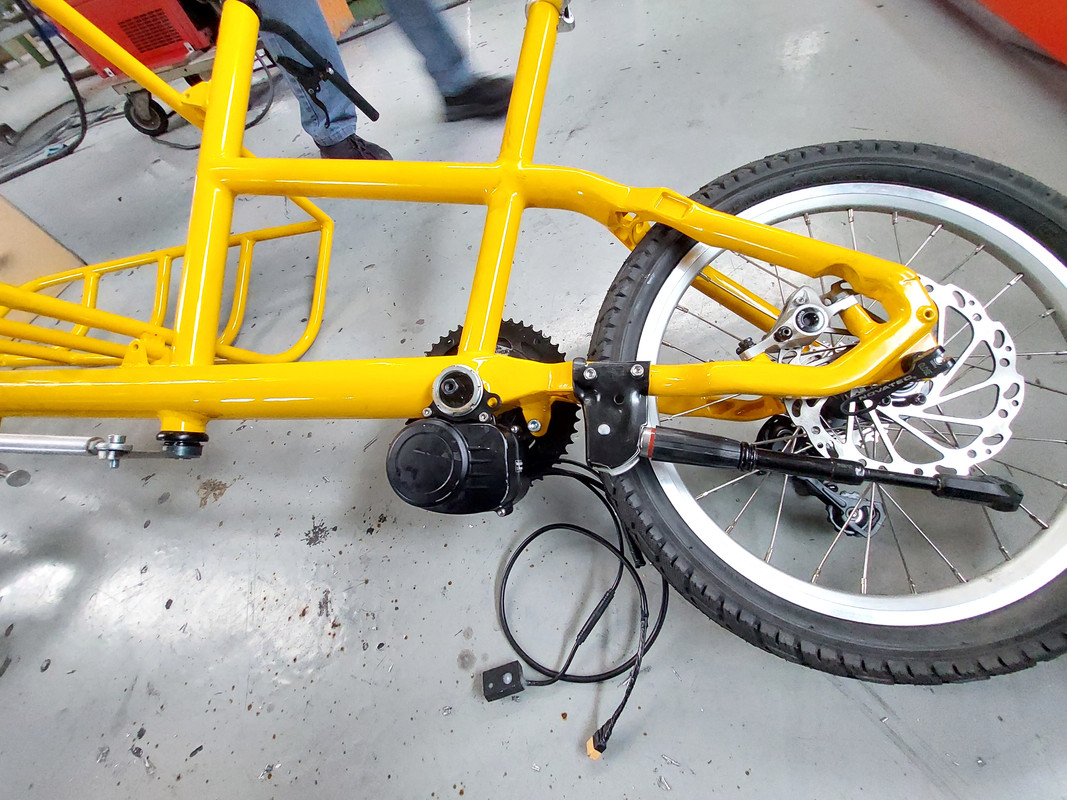

My new mini cargo bike is mostly ready, with a perfect fit for TSDZ2 :)

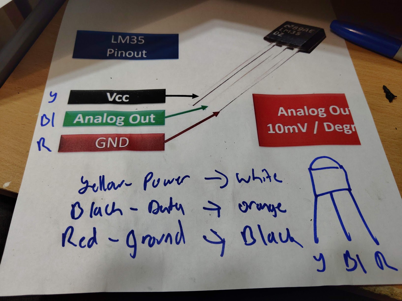

Hi guys I finally got around to installing the temperature sensor and thermal mod to this motor after completely frying the stator (it turned to charcoal LOL).
PROBLEM: The temperature sensor works fine when the bike is not in use. It shows the correct room temperature. However, when I press the "walk" button for testing, the temperature on the display goes up to like 180 degrees and of course this cuts out the motor. It is not really getting hot obviously. It works fine again when I turn off this feature.
I cannot see any problems with my splicing, but I traced it again to make sure, and double checked it 5x. I am only using the wires from the display (not the other grounds).
The display is the SW102 and I'm still on version 1.0.0 of the software.
Note: That goop is just liquid electrical tape
Edit: Note 2: It may look like the "red" wire is in the wrong place on that connector but it's correct on the end with the actual sensor (it goes to the ground not the middle)
Strange issue. I would test again the wiring, maybe GND wire connection of the sensor is lost.

casainho said:
Maybe when motor is engaged the 5v for LM35 drops.

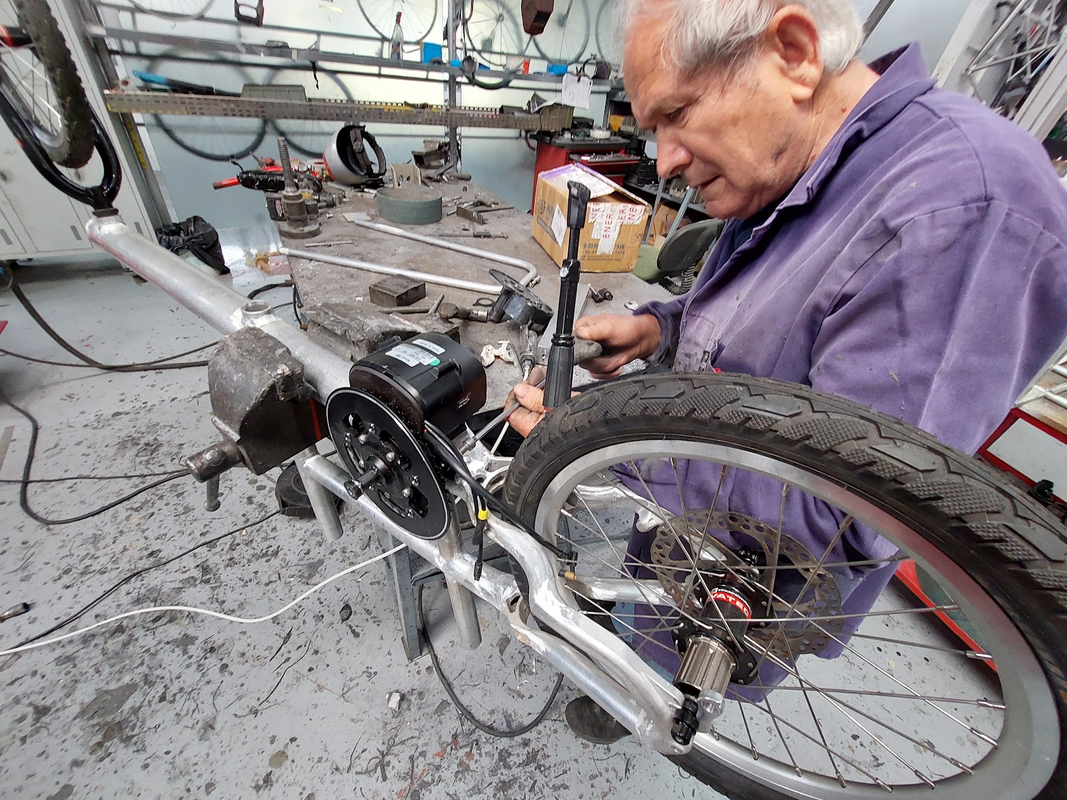

Finally my mini cargo bike is ready and I had to ride it 50 kms from the shop to my house, and I had to carry that electric scooter which was a good test.
The Sir is the man that did this mini cargo bike, a great shop for custom bicycles!!
And my son, 50 kgs, it was a quick test. The plan is to walk our 2 months old new baby, we do not expect to carry a big child there.
TSDZ2 works perfectly well and I am being very happy with it. See, for this small bicycle, a small and powerful enough motor!! I think this was the last bicycle I will use TSDZ2 as I do not expect to have a new bicycle in the next months / years (??).
