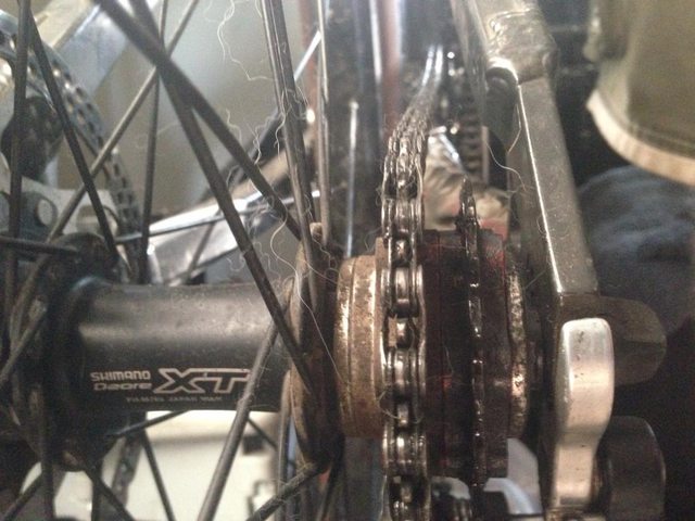

What's that silver big fat washer looking thing and how is that connected?
Unfortunately as I think you mentioned on the LR kit...

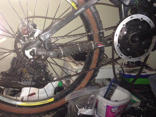

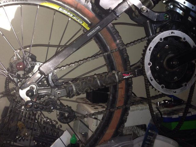

can you explain how your 20t works with that tensioner you linked thanks?
Let me know if you want a different view than these...
This is my commuting setup - large chain wheel with 16t rear for 55kph@72v
This is my trail climber setup - small chain wheel with 20t rear for 35kph@72v (sorry chain line looks crooked but I couldn't get it straight in pic without sun in my lens...I also didn't tighten it right up)
Tensioner seems to work fine on 20t for me as long as the spring is tight...I don't think it could do much bigger. There's not really as much chain wrap as I'd like, but those sprockets have nice big solid teeth and grab the chain well enough. I still need another shadow conspiracy chain for the extra links though so I can use on this bike. They only come with 74 links or so - sized for a BMX.
The 'washer' is a spacer, you can see them more clearly on the last couple pictures. They're from a single speed conversion for freehub - they're to fill the rest of the width of the free hub when you only have one sprocket.
