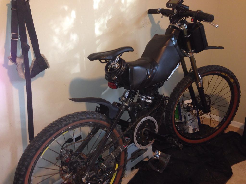

Here's my newest stage of elemental resistance :D
Hacked up some 1/4" closed cell foam matting I found at the surplus store. Turned out to be pretty decent protection.
Now to make a slip cover for it - a la Jon Bozi tshirt skin.

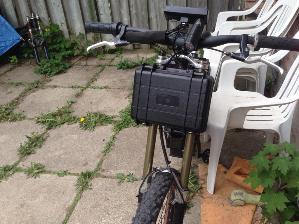

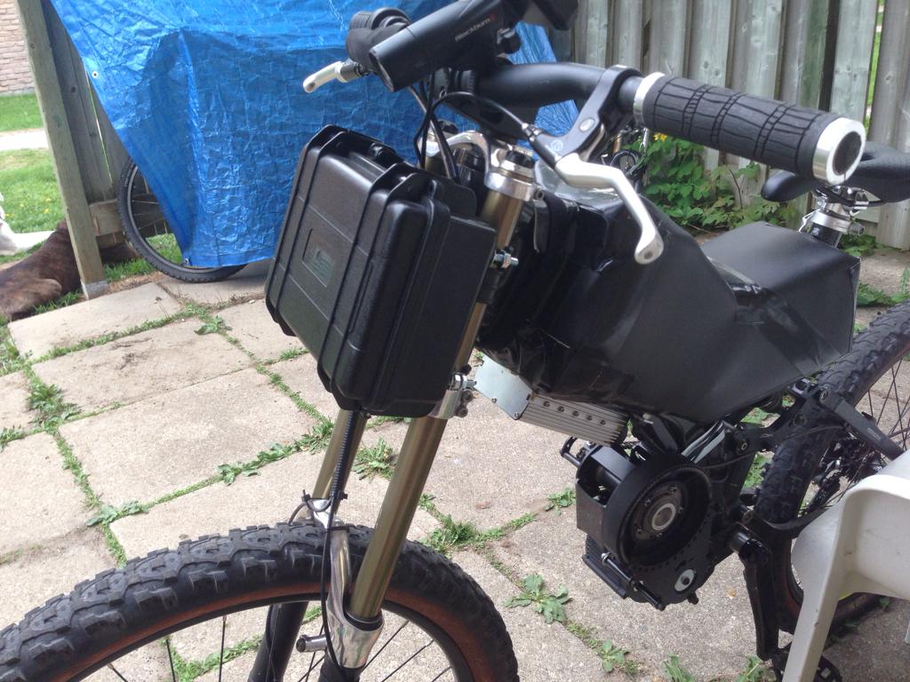

Well I finally got around to mounting a Pelican-type case to the front fork.
It's my new mobile-toolbox and trunk space - good to finally say goodbye to carrying a backpack everywhere.
Turned out super easy to mount with just bolts and rubber jacketed clamps - since I'm not holding a bunch of battery weight I can't see much wrong with it (yet) :D

Here it is now with fenders
