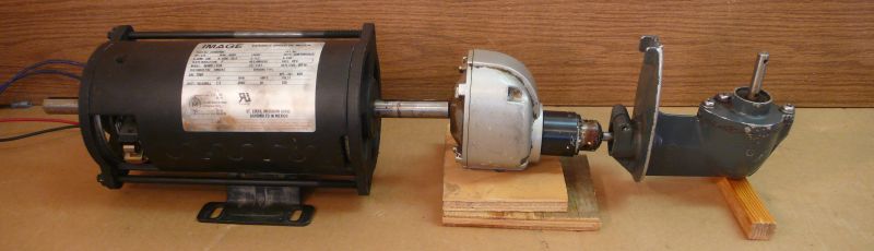

Also, the 90-degree outboard motor gearbox arrived today:
It is a 2:1 geardown, and quite small. The bottom bulb is half the size of my fist.
One complication, it has no bearings, just seals, and the gears grind badly if it's not aligned both tilt-wise and depth-wise. This is a pain in the ass but not insurmountable.
So, the motor might be a little bit overpowered. Bit of a difference in shaft sizes here...
And the "completed" driveline:
Too much geardown as is. I'll have to remove, at least, one of the drill geardown stages.
As-is, with all 4 stage geardowns:
3200 RPM @ 130V.
90' gearbox is 2:1 so 1600 RPM.
The drill is 38:1 so 42 RPM
The drive sprocket will be ~3" and the rear cassette varies from 4.5" to 2.5", so, between 1.5:1 and 0.8:1, so between 28 and 53 RPM.
The rear wheel is 26"=0.66m or 2.07m circumference, so between 3.48-6.69 km/hour. Or, between a slow and a moderate walking speed. *Fail Stamp*
Kill one of the 6:1 geardowns in the drill gearbox.. 21-41 km/hour. Not bad. And if I use 170V instead of 130V like it's supposed to.. 27.5-53.7 km/hour.
Still a bit weak. I'd like a max speed a bit higher than that, batteries will drain too, so, maybe I'll upgrade to a 4" drive gear and increase those numbers by 33%.
Hrm, let's see if I get rid of the drill gearbox entirely, but pulse it on average at 130V still.. 126-246 km/hour (75-147 mph). Nope. Guess not.
4" drive sprocket it is. 37 - 71 km/hour (22 - 42 mph). Slower is not a problem, can do that electronically.
I guess the next step is laying it all out and start disassembling/cutting.
