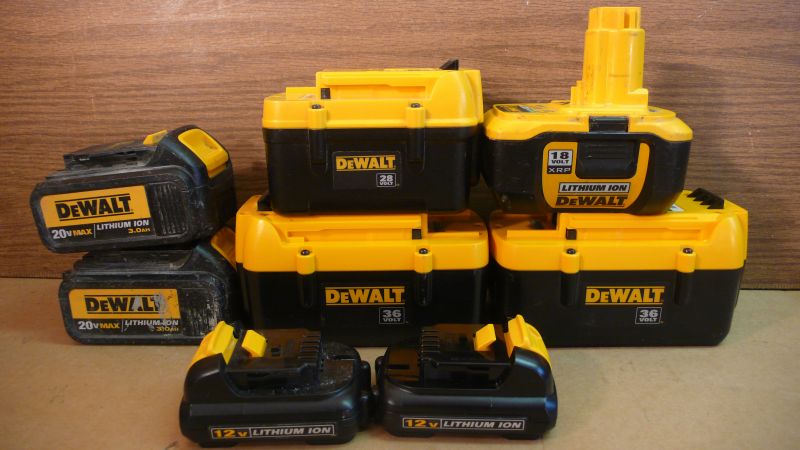

Progress:

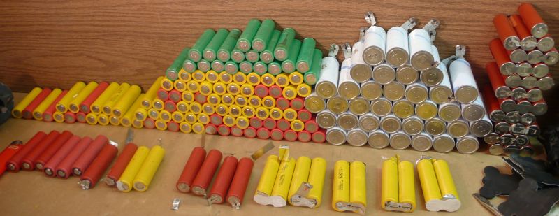

Out of each pack, 1 or 2 cells dead. 70% working just fine overall.

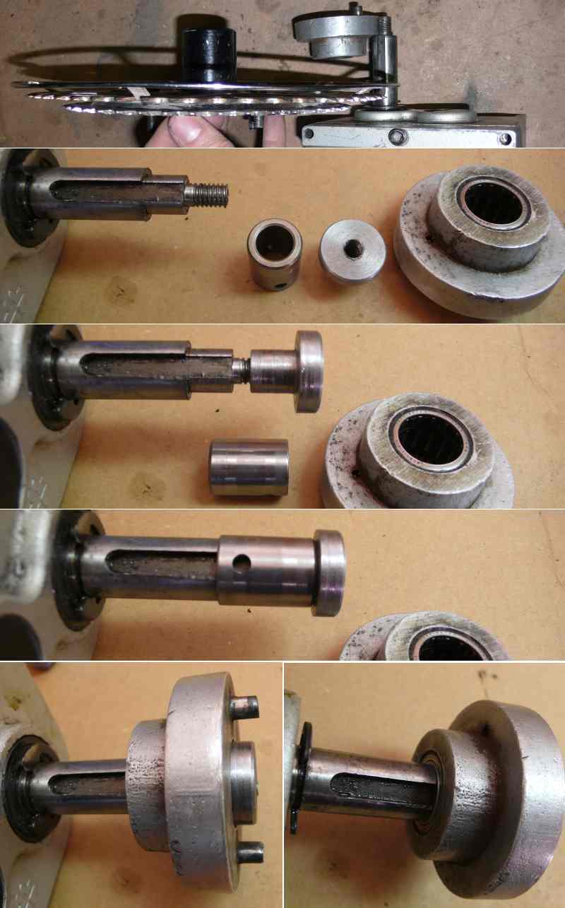

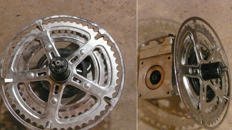

Then on an old powered golf caddy I found some freewheels, (the rusting things):
And pulled off they look like so:
These are overrunning clutches, not pawl-type or ratcheting. Completely silent when coasting.
These were gifted to me, someone bought them off Ebay and ended up not using them. Not sure if LiCo or LiFe. I suspect LiCo.
A word of caution about Ebay buys of extracted batteries. Out of the box, 34 chargeable, 78 dead and gone. 30% success rate. (Compared to 70% from disassembling packs I rescued myself). These packs have clearly been picked through already, likely by the sellers, and the ones on top were, by far, the more often working ones than lower down. I suspect they threw in a few questionable ones and padded the bottom of the box with ones they knew were dead (visibly leaking electrolyte or chained to ones that were). So, buyer beware. You'd be better off buying packs not disassembled yet so you can be the lion rather than the jackal.
Batteries were all 3V+ or under 0.1V anyway, so that made Keep vs. Scrap easy.

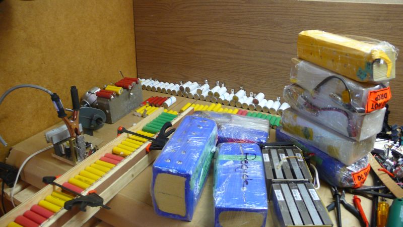

Been slacking on this while waiting for parts for a month. But, progress is being made.

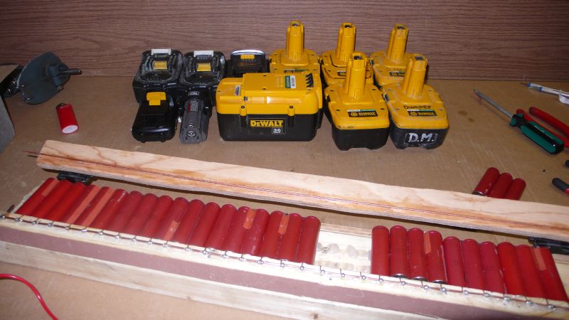

Built a massive parallel charger for the 18650-sized cells.

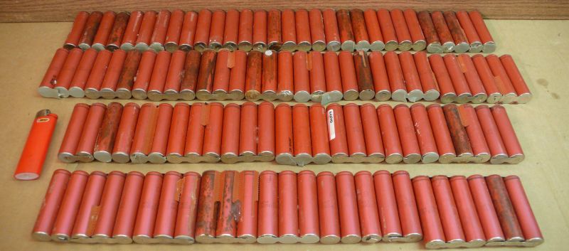

And picked up another load of "Dead" batteries. Still about 70% recoverable:
And then the motherscore. Had a contact hook me up with some "dead" LiPo packs and their BMSs:
65 pounds worth of LiPo. $5000 worth of cells, if new and functional. Which is somewhere around 4000Wh. Which is somewhere around 1000km (600mile) range at 25km/h (15mph) with no pedaling.
A few issues:
1 - I presume for them to be "dead" that some cells are overdischarged and gone. But they're stuck together with adhesive powerful enough that I think I'll tear (or at least bend) the bags if I try to actually remove the dead cells. So, I'll probably just disconnect them and haul their carcasses around.
2 - Cells are maybe not all matched, and with cells so large this actually matters (8 in parallel at a time averages out, 1 does not). Many of these cells seem similar, but I might find myself limited to the capacity of the smallest cell.
3 - LiPos are fragile.
4 - Charging might be an issue now, I might have to build a gigantic switchmode power supply to regulate current.
5 - I don't know how to configure the BMS in each of them, so that they'll cooperate with each other (multiple BMSs in.. series I guess).
I'd hoped to be riding back in April already, but, feature creep is having me lean towards building a better bike later than a crappy bike sooner.

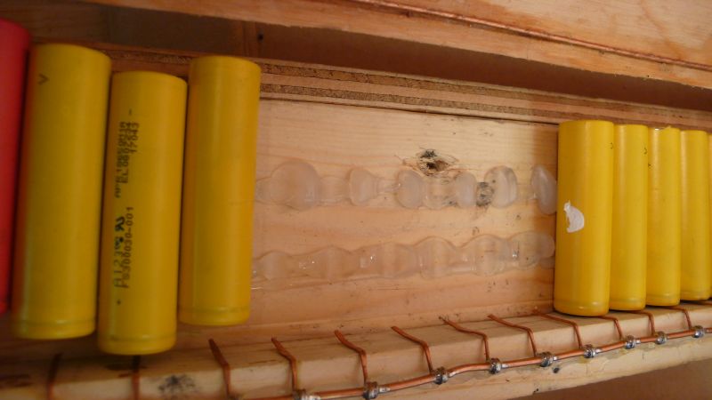

Just beware of it not actually contacting all the ends at the same time. If you use enough clamping force, fully parallel along the wood, it should "indent" the wood wherever some cells stick up a teeny bit more than others and then get them all connected properly. I ran into problems trying to do the same thing using only two inflexible metal bars, where the cells didn't all make contact properly at both ends, as they are not all exactly identical (even the ones from the same manufacturer), sometimes because of torn-off tab welds and such.
Denatured alcohol (or even isopropyl) will usually at least temporarily "deactivate" many adhesives, and usually permanently remove them. Just test to be sure it won't damage the cell casings first. (almost certainly will not, but check...).
Outside or in a well-ventilated area, put DA in a bowl or container big enough to partially immerse the pack in, and let it soak a few minutes, then try a plastic shim (about like a credit card but with no stamped-raised stuff on it) to slowly insert into the gaps between cells. Once a gap is enlarged a little, re-immerse the pack and soak, and keep repeating till it's all done. Alternately just use something to apply the DA to the adhesive areas/gaps and enlarge with the card, if you don't have a container large enough for the pack.
You could test them once assembled into groups, under load, and see which groups of parallel cells have more voltage drop or run empty faster. Mark each group with this info, and then build a pack with the best groups. The other groups you then troubleshoot with a binary search to find and remove the problem cells, and repair with any spare cells.

Just beware of it not actually contacting all the ends at the same time. [...] as they are not all exactly identical
*takes a better photo*
Not a problem. There's at least 1/8" of compression from each, and I clamp the whole top bar anyway.

Good news: Of the first 43 cells I tested, 42 of them seem in perfect condition. I'm not even sure how these got reported as "dead", even cells marked as dead show identical voltage to the others. *shrugs*. Maybe the BMS left on them for weeks/months slowly revived the dead cells.

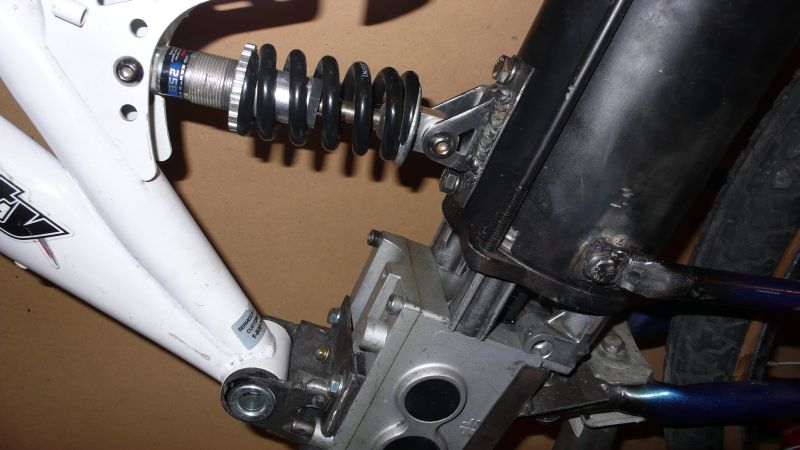

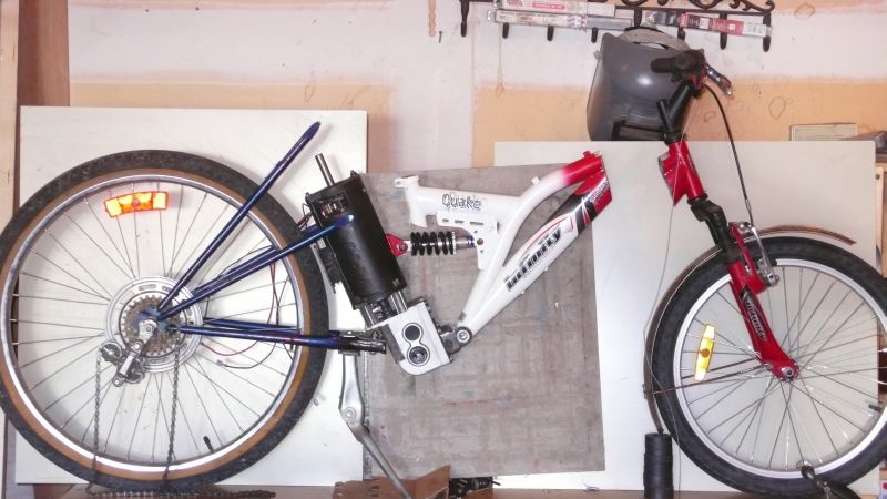

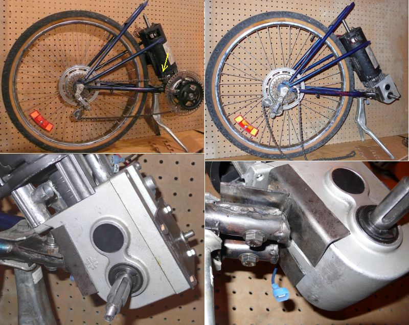

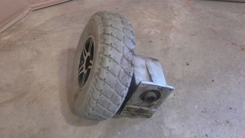

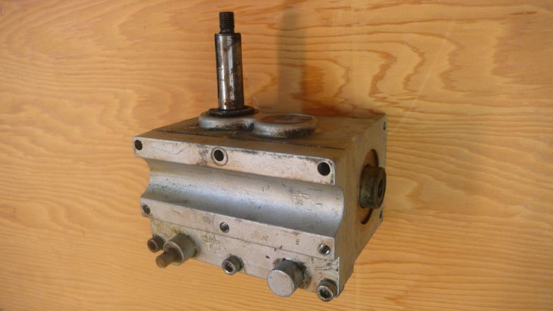

Picked up the powrechair gearbox today.
I pounded the wheel off, am left with a keyed shaft, and a 32:1, 90 degree all-in-one gearbox.
Note it also has that other shaft protrusion on the bottom left there. That is a shaft that bends like a hockey stick about an inch into it. I know it's supposed to have a manual freewheel engage/disengage so you can push it without cranking the motor. I'm not sure how it works, if you pull on it or twist it. I would definitely like to use it though, to disengage the motor when batteries are dead (4000Wh and 1000km range at 25km/h probably never, but..).
Anyone familiar with powerchairs?
Other feature: Where the output shaft (long one) comes out, next to it is another rubber plug thing. The opposite side also has this pair, (with both plugged). So 4 options total. I presume both sides is to make the gearbox flippable to the other wheel. But what is the 2nd plug on each side for? The box is literally packed with grease so I can't see anything, would rather not scoop it out without reason. Is it likely to be a two stage geardown and the other position is for using only one set of the geardown?

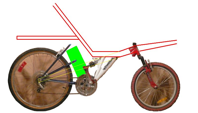

At full open throttle I'm at 4200 RPM (170V) off the motor, so, at 32:1 geardown, that's 131.25 rpm on the drive sprocket.
Ideally, I want 200-600 RPM on the rear wheel using the rear sprockets (25-75km/h, 15-45 mph).
So, I should have a drive sprocket that is a ~50% bigger than the largest rear sprocket and it should all match up. Except this is stupid, I'm gearing down to 131 and then gearing back up almost 5x for high speed. Would make more sense to remove one stage of the gearbox, same problem as before.
But, it's at least doable, since I don't have to contend with the extra 2:1 geardown from the prop gearbox. I have chainrings of the appropriate size. If I go 32:1 down and then back up, so be it.
Tha'ts the clutch. Most of them twist. If it has a lockingpin hole in it, just stick a screwdriver or allen wrench in there, and turn it, usually 90 degrees. Sometimes you have to "rock" the output shaft a bit to engage or disengage it.
I used the clutch frequently on CrazyBike2 when I had the "350W" motor on there, but when I switched to the "650W" motor, it's gearbox did not have a clutch. :( So I could not rol the bike backwards hardly at all.
AFAIK it's to access a bearing for installation/removal. Most of these gearbox cases seem to be flippable, but the parts inside may not all be--some seem to be made specifically for left or right operation. Even the lid can be used either way--you just drill out the other "cap" for the clutch rod and cap off the first..
That's what I did on CrazyBike2; the only issue I had was the massive torque capability at the low speed, which could and did destroy about any bike parts that were misaligned, espeically since it had the power to twist the frame. :(
It was quite simple to do it this wya, and was the primary motivator for using it liek that.
To mount the sprocket, I just welded it to the wheel's ex-hub, making it easy to mount to the output shaft. I also used a bolt-on version at some point.
You'll want to install some bolts in the "top" row of holes, too--without them the lid isn't perfectly attached and will probably leak. Some of these lids are also dirlled all the way thru on the meiddle row of holes, and can leak there if they aren't filled, ieven if not used.

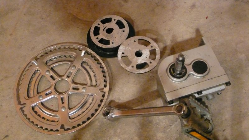

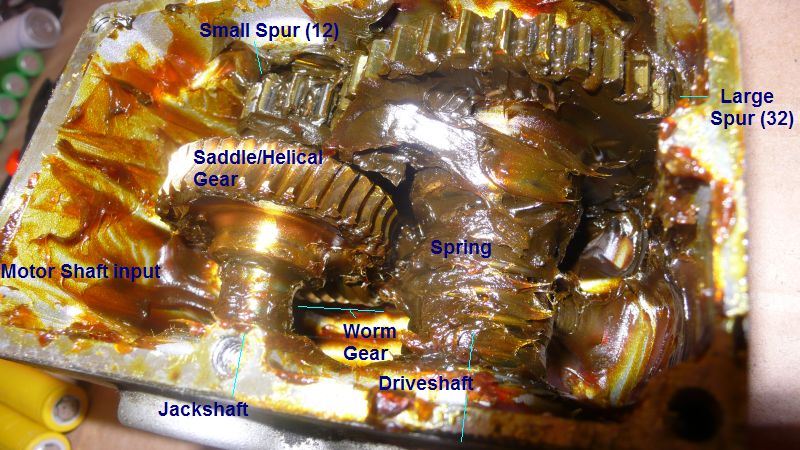

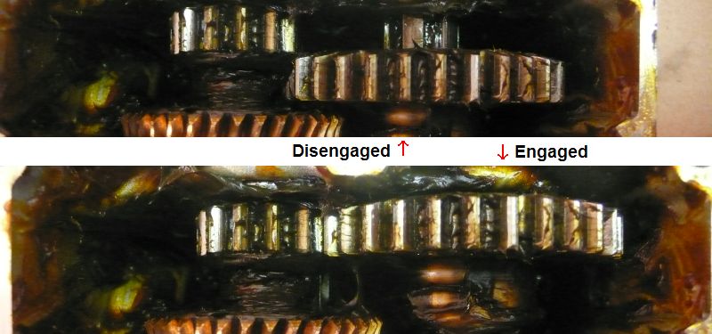

Scooped out the grease for a look-see.
1 - From the motor coupler shaft, a loosely toothed worm gear.
2 - A saddle/helical cut gear on a jackshaft, meshing with the worm gear at 90 degrees (not sure of tooth count, but 12x).
3 - A small (12) spur gear on the same jackshaft.
4 - A large (32) spur gear on the drive/wheel shaft.
5 - A spring on the driveshaft to hold the large spur at the edge of the box so that it connects to the small spur gear.
6 - A hockey-stick lever that can shove the large spur gear so that it compresses the spring and disengages from the small spur, when twisted from outside the case. (Amberwolf was right)
Notes:
A - The freewheeling action is best for when you want to disengage the motor from turning the wheels, not the reverse. While either way holds the gears apart, if the wheels are moving it will scrape the lever against the large spur as it rotates, whereas with the reverse, the small spur rotates freely in the air with no scraping. (Crappy for me, I want the reverse, so I can pedal when the batteries are dead without cranking over the motor).
B - There's no such thing as moving the driveshaft up to the jackshaft, at least not without changing everything else out. The large pinion is incompatible with the worm. The shafts themselves are different sizes (drive shaft is larger). The rubber plugs are just there to serve as end caps.
C - Unlike most worm gears (like the one Amberwolf mentions that couldn't go backwards) this one does not lock up when the helical gear tries to turn the worm. The angle is sufficiently steep that they mesh without locking. But it's not easy.
D - Overall geardown is 32:1. Most of the geardown occurs on the worm (12x) stage. The remaining (32:12 or ~2.66x) is in the spurs.
32:1 isn't great but is workable. 12:1 total is ideal for me. In a perfect world I would use the jackshaft as my output shaft and skip the spur pair altogether (since the freewheel is only emergency-usable in reverse anyway). But it's cut off flush. So, I need to gear back down by ~50%. I'll muck around with it a bit more before deciding.
I'd need a 48 tooth gear on the drive sprocket, which is fine, that's a normal big chainring. It'll taco the chainring if I don't bring it up to speed before engaging it though, even on the small gear. Which interferes with my "Screw speed control, just use a relay" plan.
You can also see the insides of another type over at my http://electricle.blogspot.com if you're interested enough to find the post with the pics. But I dont' remember the title of the post or exactly when it was. Should be tagged with motor or something like that.
The clutch is actually designed for "freewheeling" the output shaft, so that a helper can push the chair around without overcoming the motor and gearbox reduction drag (which is quite a lot).
So it can do what you want, but there will still be drag on the system.
What would be better is to use a freewheel on the output shaft of the motor. Take the threaded part of an old rear bike hub or a threaded bottom bracket cup, and weld *that* to the ex-wheel hub, and thread a freewheel onto that. Then just use the motor in the direction that allows the freewheel to drive from the motor but just spin with the pedals.
Yeah, but I was looking forward to the simplicity of it already being done. I have those two expensive overrunning clutches to use, but no way to replace them.
Oh, locking up the helical wasn't the problem--just that the force necessary to reverse turn the motor via the reduction gearing thru all the bike's gearing too was so high that it was beyond hard to move the bike backwards
Well, I can twist the shaft with my hand, so, throw a gear on there I should be able to move it even easier. I guess my angle is pretty slouch.

Ah; I wonder if there is a fix for that. Perhaps a pin in the casing (outside if possible) that prevents the lever from flipping all the way over to the spur gear, yet still fully disengages the clutch?
Hrm. One of three things: I'm misunderstanding you, I'm misunderstanding how the mechanism works, or you're misunderstanding how the mechanism works.
The lever is bent. When you rotate it, the bottom part swings out and makes contact with the spur gear, which is held where it is by a spring. If you keep twisting the lever, the bent part shoves the gear back, compressing the spring mounted on the shaft. This eventually moves it far enough to disengage from the other spur.
If at any time the lever is removed, the spring shoves the gear back to the end of its travel, re-engaging it.
So, the lever has to remain in contact (with moderate pressure too) of the large spur gear. If that gear rotates, it will scrape along the lever.
So, I don't understand where a pin could go.

Up top is the old wheelchair wheel hub (thanks again Amberwolf for the fantastic suggestion to re-use it!). I need to fit two things on that shaft, so I spent a half hour hacksawing an inch off the outside so only 1/4" is left. I'll trim the other side later.
I also drilled around the old crank, dremeled, chiseled, until I got the chainrings off the crank. A bunch of filing and it fits onto the wheelchair hub.
Bonus, both are 5-spoked and the holes line up perfectly.
And they fit nicely back on the gearbox.
Bolting is nice because if I pretzel up the chainrings or go with a different motor or want to gear it for different speeds later, I can just unbolt it again.
Next, I have to mount one of my overrunning clutches to the same shaft. One would require the shaft to be built up, the other lathed down. Annoyingly, the difference is enough that it would bite into the shaft key, so that makes things a bit complicated.
Sort of a milestone, it's the first time any parts have been assembled together since I started the teardown.

The upper picture is how things started. The old hub and the sprocket already fit on the shaft, but I needed to get the overrunning clutch onto there somehow. The shaft is too small for the clutch directly, but not by enough for a bare collar (0.080" total). Luckily, the place the clutch came from had a precisely machined and hardened collar of its own.
So, the shaft was lathed down, and then a custom nut/collar/cap was added to the end to lock it all in place. It could've been just a nut with no collar, but it was suggested I leave as much of the hub intact for torque reasons. So the nut serves as a 1/2" extension too.
[Pics taken to show how pieces fit together, not the actual assembly sequence]
Next up, the nut head needed a couple flat spots ground in so I could get a wrench on there. Then, trimmed a 1/2" off the hub with the sprocket to make up for the part of the shaft that the freewheel stole.
This cap/collar/clutch assembly was the only discouraging "I don't know how and don't have the tools to do this" obstacle in the build, far as I can tell.

Gearbox is actually dry from me disassembling it to take pics. Need to grease it back up.

Made another rough sketch of where stuff has to go:
And since then worked on fabricating a way to mount the gearbox (aluminum, no mounting points and not thick enough to tap) to the rear frame:
The brackets will be JB Weld epoxied to the gearbox. I welded a mounting plate onto the chainstays that bolts through the mounting plate for the gearbox brackets.
I also cut, welded, and drilled the mounting plate for the pivots to attach to, and ground away a clearance hole for the clutch lever.
Around this time I noticed the mother of fails. Note the yellow arrow. The chainline does not clear the motor. In the small chainring and smallest casette it clears barely, but nothing clears on the big chainring and only a few gears clear on the small one. That means I'll need to have a power-side redirection pulley/sprocket right next to the chainrings. ARG. Unnecessary stupidity.
Next up is mounting the pivot to the gearbox plate (it needs to mount right inside the clutch lever, wonderful)... and figuring out mounting arrangements for the top and middle of the motor to the old seat stays.

Did a quick mock-up assembly (everything's hovering in place, not mounted).
- Created a ridiculously overbuilt bracket for the hinge. It has a cave for the clutch bar 'cause it had to be mounted right over top it.
- Drilled temp mounting holes for that bracket and the plate it mounts to before mounting to the gearbox. I'll weld the two plates together once I've sat on it and determined if I mis-thought anything.
- Stole the rear suspension off my new (to me) mountain bike, swapped it with the original one from the kids bike (it's much larger, longer travel, heavier duty).
- Bent and reformed an old chrome fender to fit the front wheel.
- Chopped the front wheel, head tube, & handlebars from the rear pivot. Front wheel and head tube will get re-used, handlebars will be replaced, sourced some conduit for that.
- Test fitted the rear suspension. Pivot is set, the rest of it not sure. Most of the top of the red/white frame will get chopped flat to fit the reclined seat.
Looks okay except for the questionmark of my head tube angle and handlebar design. I'm going to try these instructions:
http://bikesmithdesign.com/Design/12Steps.html <-- This, and...
http://bikesmithdesign.com/EvoBars/EvoBarSetup.html <-- That.
Except that's all data for a LWB and I'm not sure how to adapt it to an SWB. But much of the advice is quite solid in terms of ergonomics.
Boring technical stuff:
The other problem is that the rear suspension mounts a bit high. Swapping the suspension from the kids (fitted to the red/white bike) to the adult size one means now the geometry's changed. The distance between the pivot and the motor-side mount is correct for the big spring (based on its donor bike), but that would yield a very shallow angle because the upper frame mount is sized for a spring 2" shorter and weaker. Angle should be close to 90' (pivot-to-motormount be 90' from motormount-to-upper frame), so that movement on the back translates directly into compression. It's like 60' in the picture.
My solution is to drop the motor mount almost to the bottom of the motor (where it should be for the old spring). That will keep the angle closer to 90'... but now leverage has changed. Spring will appear much softer if closer to the pivot? Ehn, it'll be what it'll be. I'll can fab the upper frame mount wherever, but any higher up and it forces me to place the seat higher, so it will probably stay.
In the end, I've basically swapped out the kids spring with an adult one, it's stronger and has much more travel. But I didn't put it appropriately far out, only slightly farther out than the kid's geometry. So net change is that it will have more travel than the kids one, but will be softer than what's expected on an adult one?
Is any of this stupid for reasons I haven't considered? I can't actually test any of this, "try and see" until most of the bike is set in stone (or, in weld). Fingers-crossed engineering :(
Next, bolting it together. Got the rear suspension bolted onto the motor and one pair of seat stays as well.
(you can also see the little cave for the clutch lever in the bottom left).
Progress/Notes:
- Cut extension strip for the rear suspension mount. So I'd have room to bolt it.
- Welded strip to the old red mount. Accidentally decent welds.
- Drilled mounting holes in the mount, drilled mounting holes in the motor, tapped holes in the motor, bolted (5/16") mounting plate to the motor.
- Tested the suspension. It suspends. Great.
- Drilled & tapped holes for 1/4" bolts on motor bottom sides.
- Bent seat stays to bottom sides of motor (to take the load from the suspension rather than the motor-gearbox joint taking it).
- Realized seat stays aren't long enough to reach said holes after bending.
- Decided to fab rear C-cup half strap and weld that to seat stays to cup the whole motor and then bolt those.
- Fabbed, bent and tack welded said strapping.
- Tried to disassemble motor, oops, strapping went under the motor cap bar (has to). So I have to disassemble the entire motor to get it on or off. NOPE. Cut those welds, threw strap away.
- Refabbed some 2" long 3/16" cups instead, unjoined, bent to curve, welded (horribly, back to normal) to seat stays.
- Ground flat, drilled 1/4" holes in seat stays.
- Bolted motor bottom to seat stays.... sheared a head off a stainless 1/4" bolt. Whoops. Ground the protruding bit's sides flat and wrenched the carcass out, replaced with spare.
- Considering replacing 1/4" bolts with 5/16" on those seat stays.
- Abandoned plan of mounting motor top to the 2nd pair of seat stays, since the brakes line won't clear the motor. Have to mount it higher (on the aluminum cap?) or think of something else. Biggest remaining obstacle.
- Wish I had some disc brakes instead.
- Grabbed two more donor bikes just in case.
- Considering scrapping the gearbox mount and starting over. It's poorly designed. Considering not even JBwelding it just hoseclamping it until it breaks on a test ride or two.
- Starting to get twitchy trying to figure out head tube angles and handlebar stuff, but, cross-that-bridge and all that, trying to ignore it.
