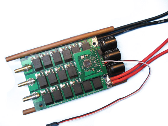

That is an RC boat controller. It has liquid cooling tubes on each side and no heat sink.
I would have no problem buying a motor from them, but controllers are another story.
Matt
