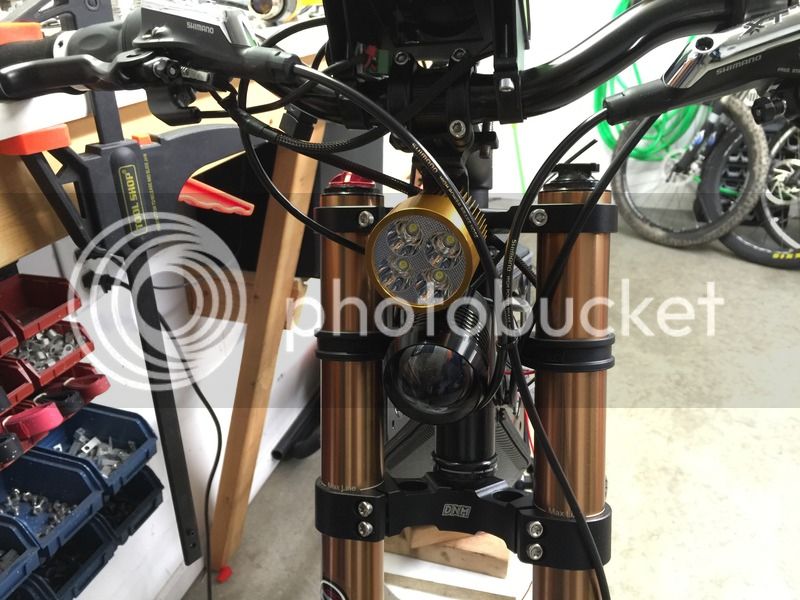

Headlights installed but not wired, one spot one flood

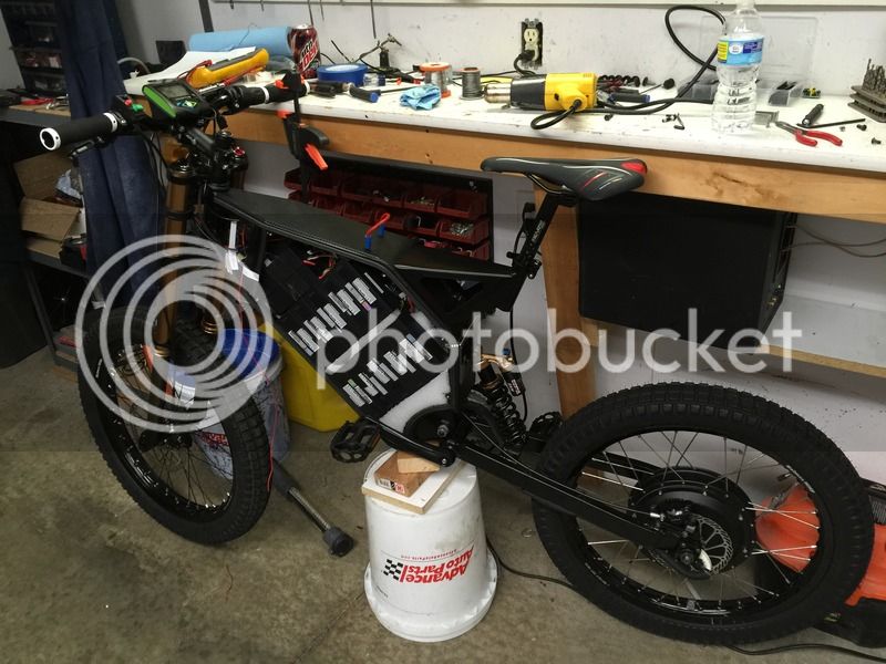

Current status, ride-able!

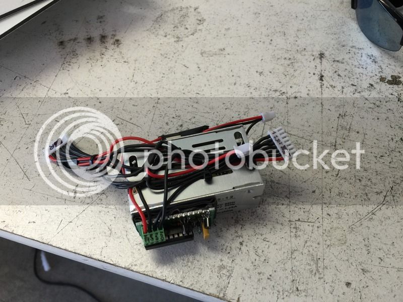

This rats nest controls all the lights on the bike, not fun to make this...
I took it out a couple times and hit 40mph with plenty to go. I didn't have the wheels trued all the way so I cut it at 40. Pulls like a freight train wow!! On the stand (or bucket) it hits 59mph with wheel/tire no OVS. This is with running autodetect 3 times. It seemed to get better each time I ran it. This is the QS 205 4T (11.5kV) motor with F/R 19" 1.6 JHR rims with Shinko 241s.
Loved your tail light. Real nice work, and the turn signals and brake lights - smooth :!:
Can you elaborate on your light set up? I noticed in your vid both turn signals and brake light as well as LED strip tail light.
That "rat nest" in what way does it work together with your lights?

This is the light bar I used:
http://www.amazon.com/gp/product/B00OB5QHC0?psc=1&redirect=true&ref_=oh_aui_detailpage_o09_s00
You can find the same thing on ebay. It has all functions built right in, just 5 wires coming out. The only thing I did was add a resistor (175 ohms) inline with the tail light. The brake light wasn't quite bright enough from the tail light, so I dimmed the tail a bit more than "stock". It was also a little wide so I had to cut it down and then wrap the left overs around the side of the frame. I actual like the look and will notch the side covers so you can see it from the side also.
The little box is a AC>12V 1.25A cheap thing off ebay. Then all the assorted wiring with it to power brake, tail, left, right, horn, headlights. It has a flasher I built with a PIC on the side for the L/R turns. Then a relay on the other side to switch the headlight power. The 12V box itself runs right off battery (74V) through the headlight switch on the handle bars. Once the 12V box fires up it switches everything else on. I could have saved some hassle and not added the relay and have the headlights (74V lights) run direct off the headlight switch along with the 12V box. I figured I was pushing my luck with 74V through that switch and I'll play it safe and use the relay to switch the big 'ol headlights. It also has provisions for front turns and a horn.

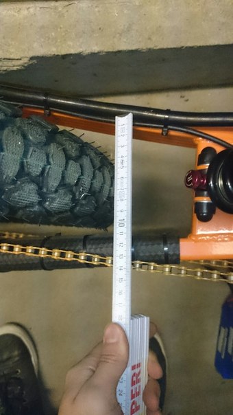

What is the maximum tire Width (Rear) ? Or what is the clearance between the swing arms at 11" from the axle?
Trying to see how big of a Moto Rim/Motorcycle Tire I can put on this. :mrgreen:
From the front of the drop out and 11" forward the width is 110mm or 4.33 inches. If you don't have too big knobs you should be able to squeeze in 3.5" width or even 4". Your biggest problem is that it is rare that tires are 100% correct sized when mounted onto rim and filled with air. One manufacturer might have a 4" tire that will work, another 3". IT also comes down to the width of the rim. A skinny rim might let you squeeze in a wider tire, a wider rim will let the tire take up too much space in the width.
Those squares are 10x10mm. The last pic is 17" moto with 2.75" width tyre. As you see there are room for a little wider tyre.

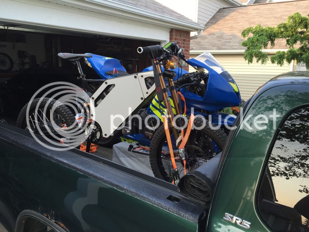

My Vector has been doing awesome recently. Only a few tweaks left to do before it's completely done. I got a chance to take it out on a racetrack in Grattan, Michigan.
I got some good looks, with "that thing" in the back haha.
I hit 65MPH no OVS. I have a video of me doing a lap, I will try to post that up sometime.
Wow, that is crazy fast. You got the version 3 -205 motor with what wind? 9 , 8 or 11kv? So what kind of wattage/amperage are you pulling?
Super cool bike.
Tom
Yep, V3 QS 4T 11kv. My plan is to be able to commute at 50-55mph. So this is why I went with the higher kv version. I didn't want to rely on the efficiency gouging field weakening (OVS) to hit speed. I am now in the research/design aspect of motor/controller cooling to sustain it. I'll post a video soon and you can see the amps. It was pulling about 110A constant down the straightaway while pinned. I have no plans to cruise at that speed haha.
