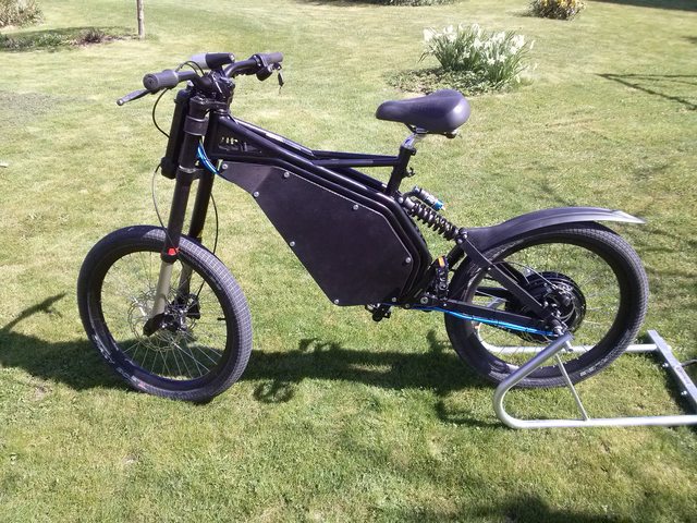

thanks for interest, here are some spec:
stainless steel frame: ~7.4kg main frame + rear fork + rear fork bearings. bb is standard 68mm width BC1,37x24T, but needs not less than 131mm axle. headset fits standard semi integrated 44mm size, head tube lengh is 170mm, seatpost 31.8mm, seat tube outside diameter is 35mm.
aluminium: ~3.7kg main frame + rear fork + rear fork bearings. bb is shimano bb92 press-fit type, headset fits standard semi integrated 44mm size, head tube lengh is 170mm, seatpost 30mm, seat tube outside diameter is 35mm.
battery box weight will confirm in couple days...

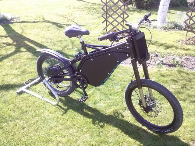

sorry for late replay, had couple urgent orders for compleate bikes, here is last one, with max performances:
steel frame; modified cromotor style motor with faster winding and liquide cooling (72v battery and 24" wheel, speed ~90km/h); integrated kelly controller, dc/dc for pump and usb for lights and other devices charge. peak power ~10kw, continious ~7kw. without liquide cooling first motor burned after ~10min ride.
i was going to say, i really like the radiator utilization..
but now instead i have to say, i really look forward to see your customized radiator!
any more details on complete bikes and the cooling system etc???
8)
how much for steel frame shipped to Australia 7053?
what is the motor youv got in the pics there exactly?
is it from zelena vosila or elsewhere?
looks a little like the elmoto motors...

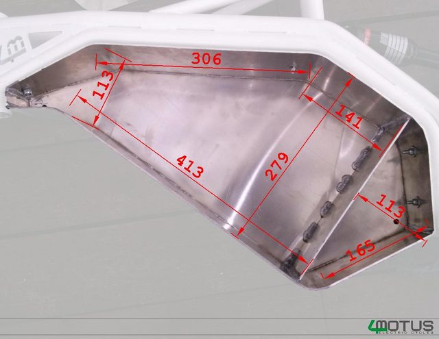

I might have missed it, but what is the internal width of the battery compartment?
We need to know so we can workout how much lipo can go in there....
Kudos
will be available two case sizes, one internal width will be 105mm, and second 124mm, will try to make photos internall look with more acurate dimmensions.
