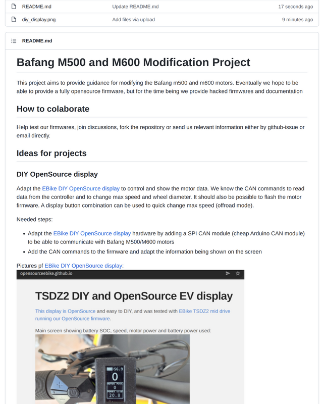

@CiDi I think you were the guy you documented more the CAN commands. Do you think would be possible to develop our own display and have all the information the original display shows as also add configurations menu to send the commands for configurations as the max speed as also the torque sensor calibration?
My idea would be to adapt this display firmware, to show the Bafang M500/M600 data as also add the configurations. This display has Bluetooth, meaning we could even make an app to flash the Bafang M500/M600 firmware using our phones.
Also supports the ANT+ LEV EBike wireless profile, so we could send all the Bafang M500/M600 data to our GPS units on the handle bar or to our watches.
We all know the Can commands to read data from the controller and to change speed and wheel diameter, so if the display can read and write Can commands, it is possible to do everything, in theory even loading the firmware.
A button can be set to change top speed from road at off-road.

Ok, great!! And I checked the datasheet of the display DP C240 and it has 3 buttons, the same as our DIY display.
We use buttons UP + DOWN long press to enter in configuration menu. To disable / enable offroad mode (in this motors would be to increase the speed over 25 km/h) would be only the buttons UP + DOWN press and an indication on the display.

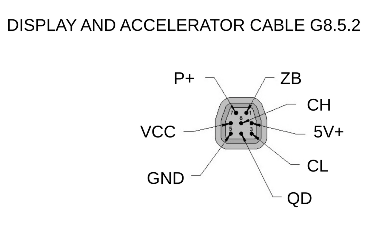

Does anyone know what are each pin function for the display connector?? I understand the GND, 5V and CAN H, CAN L but I need to know how to enable / turn on_off the motor controller:
To not forget the idea of developing our own DIY OpenSource display for Bafang M500/M600 motors, I wrote the main idea on the github repository -- while I do not have free time currently, I can help any developer want to do it, as I was the developer of this display, I can quick guide anyone. See more here: https://github.com/OpenSourceEBike/Bafang_M500_M600
Guys, try not to reinvent the wheel too much please, the motor is good, there's more than enough power with the current board with reliability, who needs too much more ( OK field weakening would be good but are you sure Bafang are not already doing this, mine easily will pull into the 120's cadence ), stick with what you have and with just abit of fettling you could have a good system and get to ride your bike more.
Try not to go down the DP C240 route, its been replaced with the DP C241 which has bluetooth on board. Its actually a very good display readible in virtually all light and quite discrete, but Bafang for some reason have made the real things we are interested in such as Watts, cadence, battery levels are all only available on the very small lower row, which for 90 % of users are too small to be readable. If only all the fields were able to be diplayed in the large centre part of the display, it would be pretty darn good.
On /Off is via the +- switch, theres an extra button there which controls the display and also with a long press switches the motor on and off.

What I really value on TSDZ2 and that I am looking at Bafang M500, my next motor, is fine control of assist levels, motor current and motor current ramp, that way I can optimize my range / battery size / weight, as I wish to have a low weight battery and do long days riding on the mountains. Also that will let me optimize my workouts / my fitness / health, as I can reduce the motor assistance to a minimum that is of my interest for my workout.
I expect the original motor control to be good but I wish to have that fine control of the motor, like even control the amount of field weakening to save battery.
And battery advanced configurations as we do on TSDZ2, automatic calculating the battery resistance and having a good SOC estimation, including being able to deep discharging the battery to increase the SOC on that long rides!!
As you say, "try not to reinvent the wheel too much" make me think that is a good idea and why doing everything from scratch again since we already have advanced motor controllers as VESC and displays? For instance, much cheaper to use the standard 48V EBike batteries than the specific 43V Bafang batteries. Much better to reuse the already existing EBike motor controllers, displays, batteries e softwares!!
About the display, for me will be much better and quicker to reuse this OpenSource DIY display I already developed for TSDZ2, that also has Bluetooth and ANT to connect wirelessly to the cycling GPS displays, that way I will not be reinventing the wheel and I will have full control of it. And they are cheap, even because I will reuse the ones I am using on my current EBikes with TSDZ2.

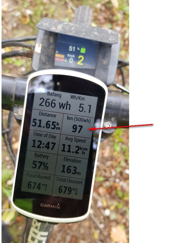

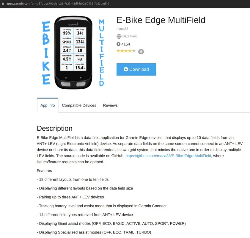

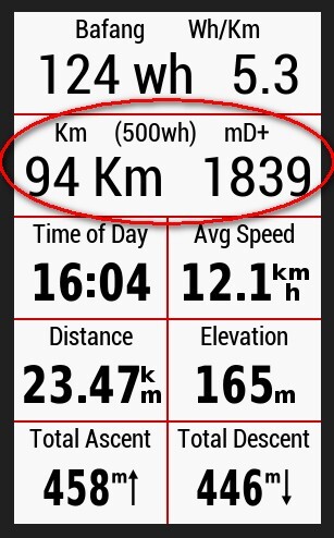

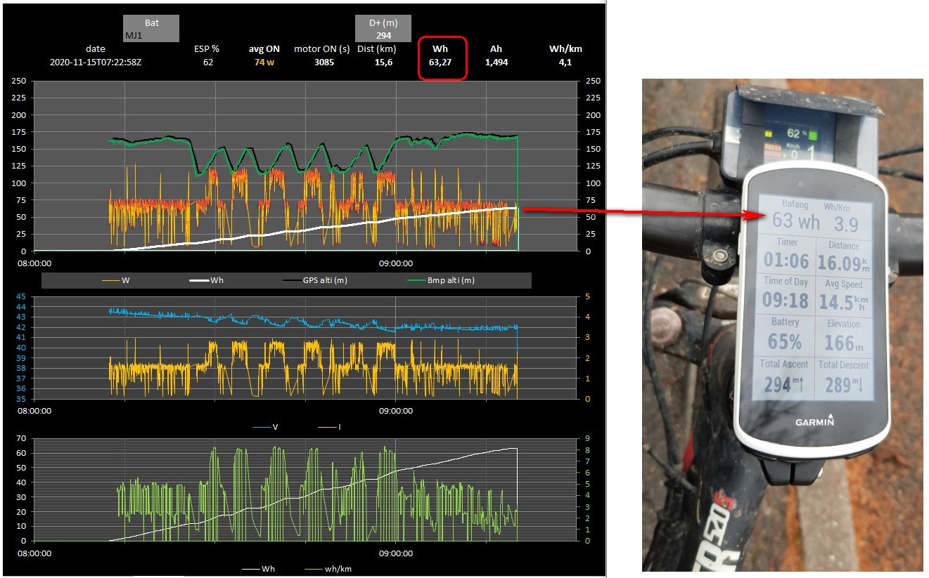

Not reinventing the wheel is using the EBike wireless standard ANT+ LEV and that way we can use software already developed by others, like this one for the Garmin Edge cycling GPS:
another example with estimated range in km or miles…
Can you explain which motor are you using? and which technology to implement the ANT+ LEV wireless?

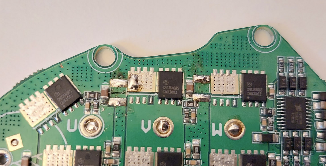

Anyone knows what are that 2 missing components on the motor controller board? could it be 2 power resistors to measure the motor phase current?

SUPERJC said:
The motor -> simply BBS01 UART but the new ones risk being CAN
Technology communication to the Garmin use ESP32 bluetooth smart (BLE)
the picture TTGO ESP32 display is here:
https://endless-sphere.com/forums/viewtopic.php?f=7&t=113971&start=49
For the answer on SUPERJC, I think is like this:
- the motor used is a BBS01, UART communication with the display
- SUPERJC developed his own display and that is based on ESP32 module (see next picture)
- the ESP32 send the motor data by Bluetooth to the Garmin Edge GPS display
- the app on Garmin Edge GPS display was probably developed by SUPERJC (since it probably does not follow any standard)
- processing of motor data, like range estimation, can be done on the display side or on the GPS display, but I would say it is probably done on ESP32
The only thing I would do differently was using the ANT+ EBike wireless standard. Well known brands like Specialized EBikes uses the ANT+ EBike wireless standard.
We already implemented ANT+ EBike wireless standard on our DIY display, then the GPS display supports nativelly the motor data, without the need to install any app (although they are available) -- here a picture of my GPS display while I was riding my EBike with TSDZ2 motor:

The ESP32 calculate the Wh with current and volt
these values (V and A) can be retrieved by any protocol (Uart, Can, ADC, other…)
On the Uart Bafang BBS protocol we only have steps current of about 0.25A or 0.5A
On the canbus M600-500 -> I dont know what are the steps of the current?
For me it's read by ESP32 with ADS1115 (for precision)
ESP32 send only Wh to Garmin wirelessly (BLE)
The Garmin having the km and the elevation can calculate Wh/km and the estimates itself
you can do your data field and your calculation by Garmin itself
