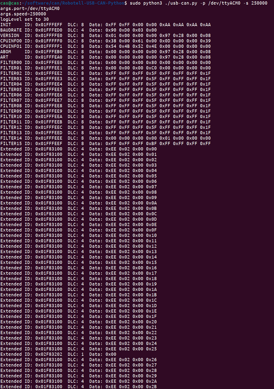

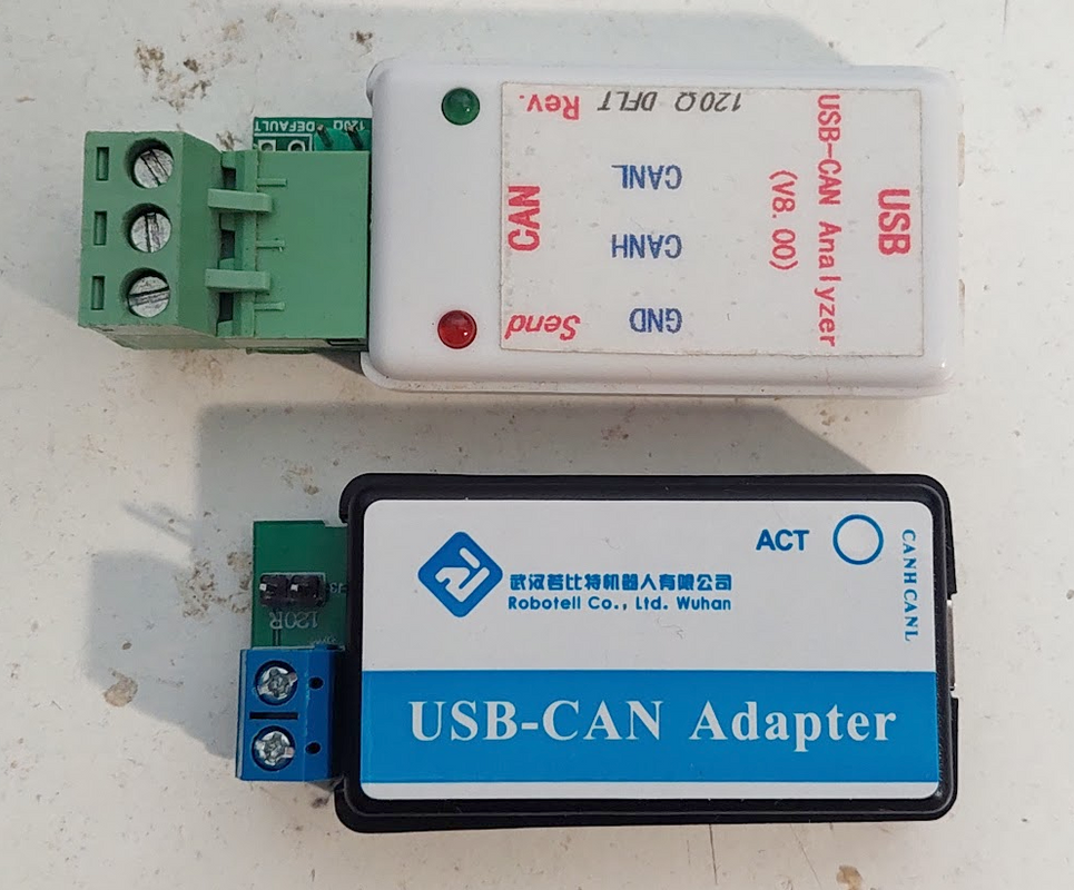

I am out of luck. I have with me 2 different USB CAN devices, the most cheap ones. I used a few hours to test both and I could not receive any CAN data from the motor although I see the data on the oscilloscope. I did follow the CiDi guide and other guides, it should be very simple to receive the motor CAN data, still I was not able to get it.
On another forum one of the guys is trying to build a smaller keypad, he has mentioned about having to change the Baud rate to 250KBS before the cheapo CAN readers would work. Is this something to consider ?
Thanks, I tested again and it works!!
It is so easy!! just wire the USB CAN adapter CAN_H and CAN_L wires to the HIGO-B6-F connector, and connect it to the brake connector on the motor. Once you turn on the display, the motor will start sending the data to the CAN. You can also send data to the motor, for instance to change the max speed and wheel diameter: https://github.com/OpenSourceEBike/Bafang_M500_M600/tree/main/CANBUS

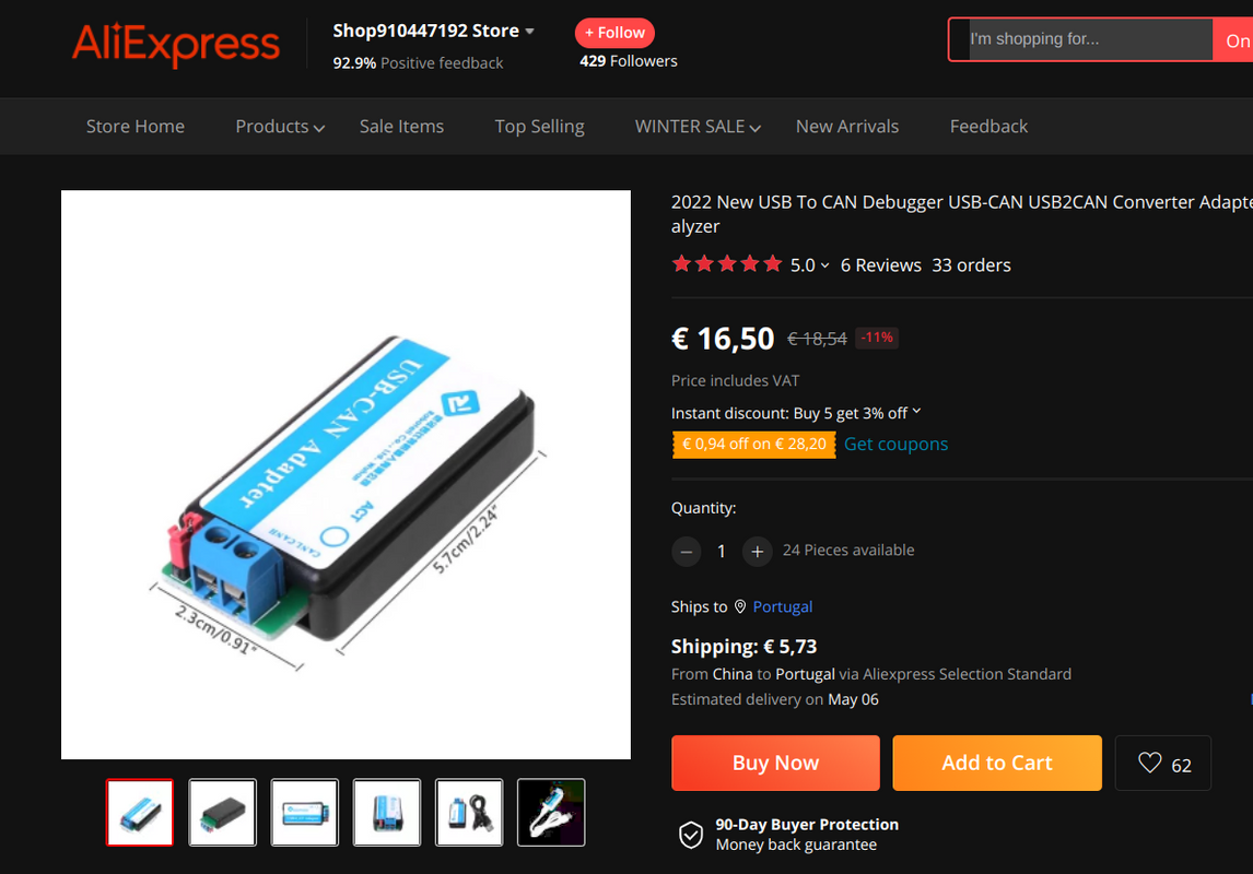

HIGO-B6-F connector is not that much expensive:
USB CAN adapter on Aliexpress:
Hi,
I've got the same usb2can hardware. It's recognized by windows, showing in COM ports. But when I launch BESST or Innomaker, the device does not show (nothing after "scan device" in Inno, "choose COM port" in BESST with empty list).
What am I doing wrong ?

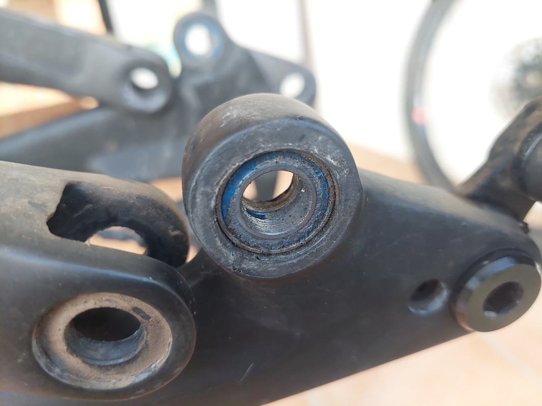

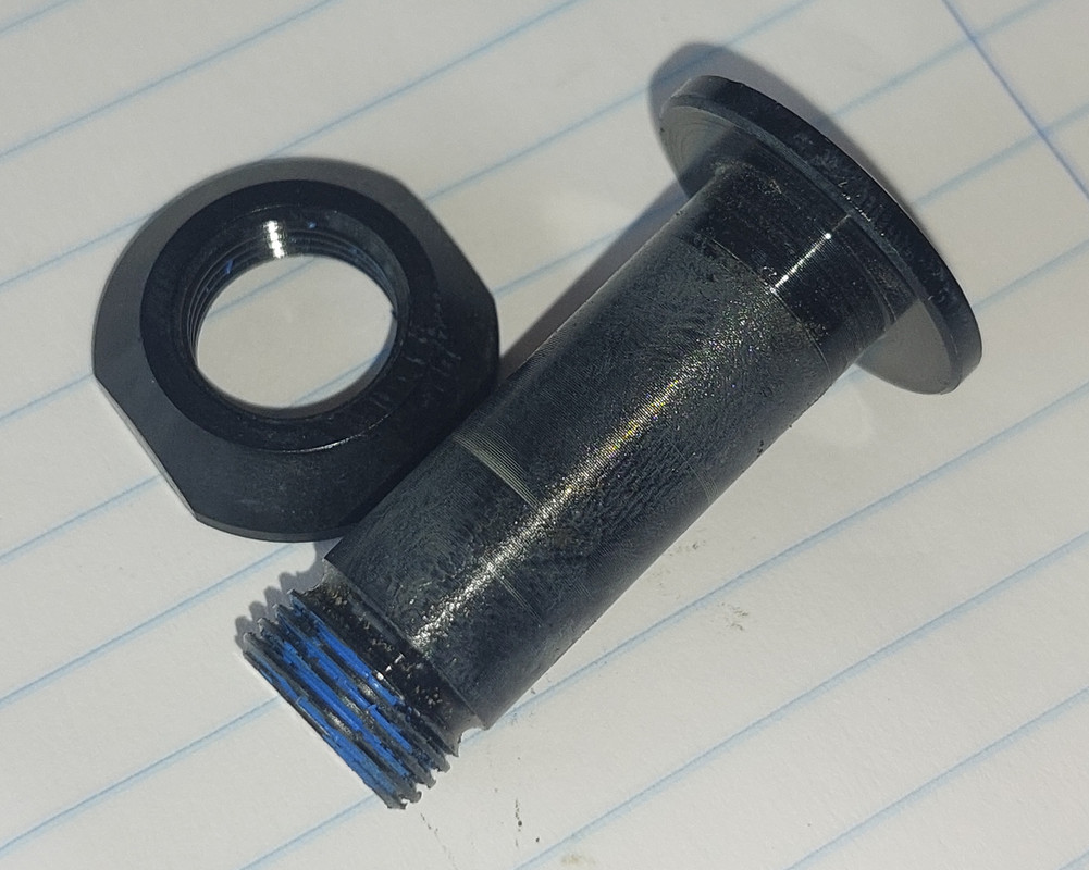

I keep using my EBike with M500 motor that I built with the Dengfu E10 frame, very happy with it riding on mountains, until 2 days ago that a frame bolt simple disappeared while I was riding at middle of a 80 kms event...
Sorry, this is a question about the frame and not specifically the motor but I hope is ok here anyway since many of us use this same frame.
Here is the bolt I need to replace - can someone point me to which type is it and where can I buy it? ideally I would like to buy from some European online shop:
Here is the empty hole on this frame that this bolt is missing (there are 2 of this bolts, one on each side of the frame):
And a picture I took during this ride... I was so happy until this bolt were missing on the frame... anyone experienced with this bolts on this frames that can recommend what I should do to avoid the same issue again? (I remember so see other guy having the exact same issue on a different frame...):
Casainho, sorry the bolts are unique to Dengfu. You will have to contact Melody and ask her to send both sides of the bolt.
It is possible to manufacture a bolt and nut replacement however using a standard allen headed bolt within a turned section of Ali as a temporary fix, take the same bolt from the other side of the frame to someone who has a lathe and it should take less than an hour.
The fix is to ensure you put Loctite or such like on the thread before assembly and use the correct torque.

Thanks! So I just contacted Melody. But I will also look at the other bolt to check the other option you say - I wish to use the EBike on next weekend...
Thanks. I am pretty sure I used the torque wrench to validate all of them were correctly tight, although, just when I assembled the EBike. In talks with other riders, I were told I should clean the EBike after every this full day rides with rocks, as also check every bolt with the torque wrench -- is this a good idea or can I damage the bolts after many checks?

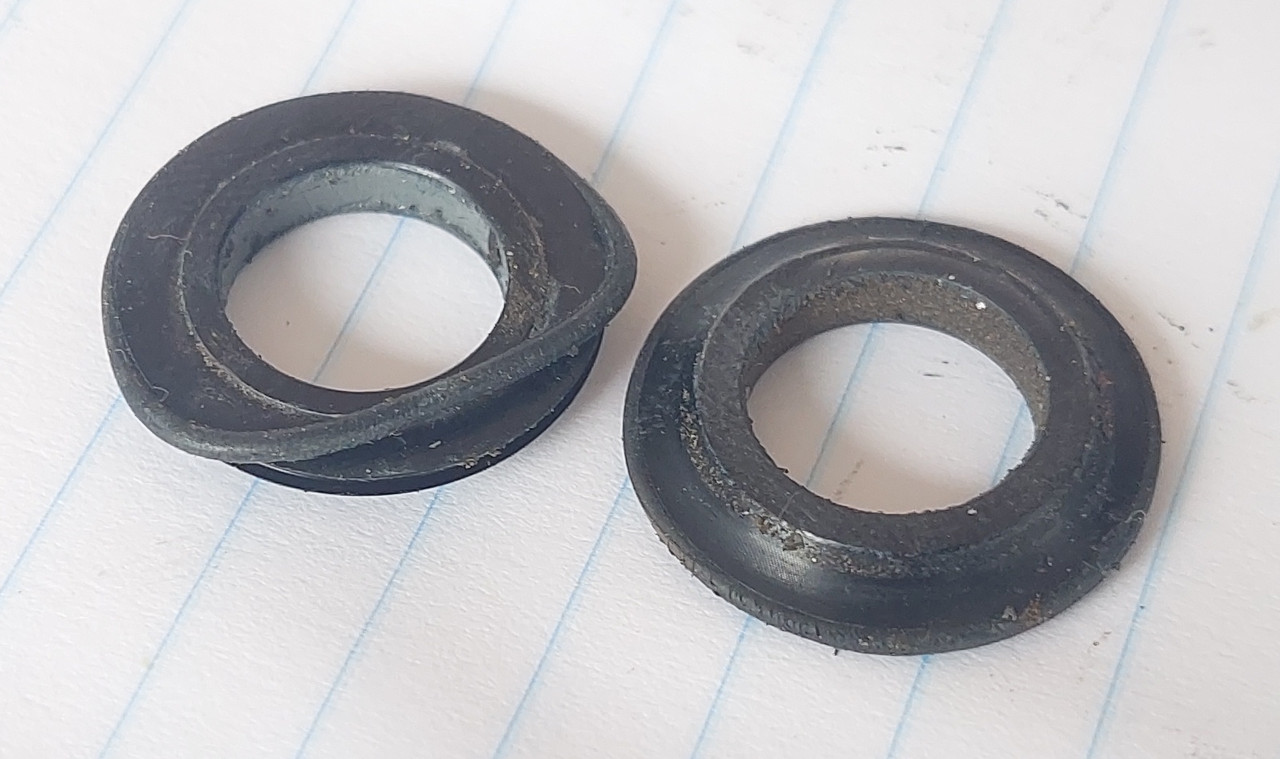

Just for reference, here is the bolt from Dengfu E10 frame:
Question: I did disassembly but I did not recorded the correct placement of this parts, that has an o-ring. What is the side of this part that should be placed near the bearing that is inside the frame, as seen on next picture??
The problem with re torqueing the bolts is that you then break the initial " Loctite " bond. Loctiting a bolt and nut is usually a one time process, once you retorque or adjust the tension you must totally remove the nut, reapply Loctite and retorque. Perhaps when you originally retorqued the bolt you moved it enough to break the bond.
I wonder whether Dengfu may have not applied enough Loctite on first fitting, my main rear linkage through bolt came loose but luckily I saw it had moved, I simply undid the bolt far enough to get a full circle of Loctitie inside the nut and retorqued. Not had any problems since.
