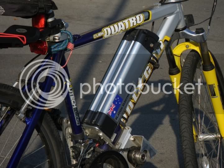

Elation and Aussie promotion! A guy came and talk to me in broken english... can I see your bike? He was quite amused. There's a bit more eBikes around compared to Melbourne. Also the culture of cycling is different. The Swiss are much more relaxed compared to the speed pursuit of Melbourne lycra crowd.

Fully installed and operational!
The whole setup was a bit fiddly and delayed due to various issues.
I had to fix the motor-mounting flexi-clamps to fit around my larger bike tube. It turns out these are
standard 06B (3/8) chain links used in industry. To add a chain link, grind off link end, then punch out link.
Either add a connector + 1/2 link + connector, or full link + connector.
In my search for chain links, I went to a few motor scooter places and ended up at an industrial products company ("G & R Industrial Products P/L" near my work) who had the links and the guy was very helpful and helped me complete the task.
This is the company if anyone is interested: http://www.yellowpages.com.au/vic/collingwood/g-r-industrial-products-p-l-12117233-listing.html
To complete the job I had to get 20mm heatshrink tubing from Dick Smith (can be sourced from many place) to have as-good-as-new flexi-clamps.
