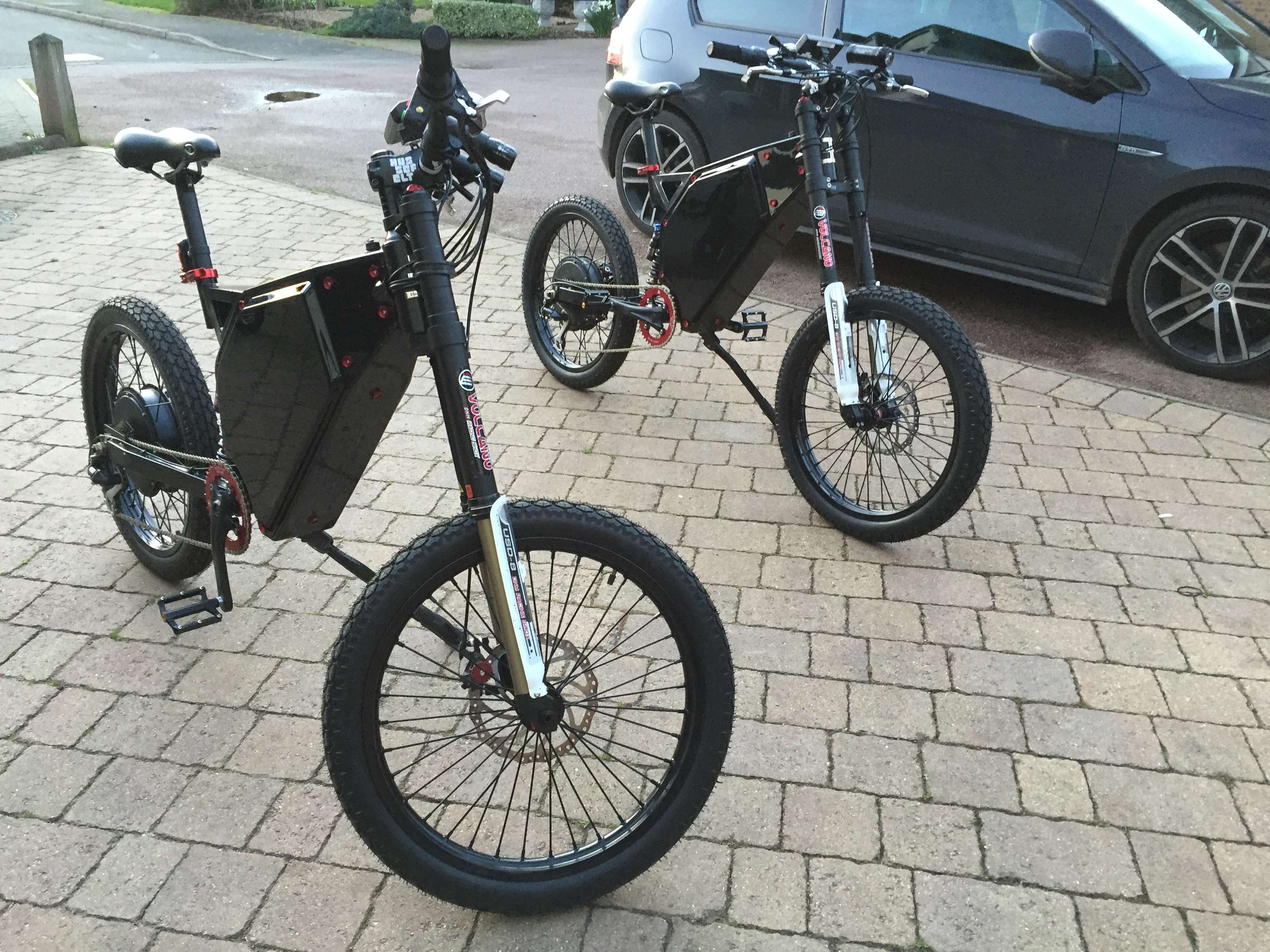

ok, so, the bikes arrived couple of days before christmas.
i have a couple of questions if anyone can help me ?
Does anyone know the recommended cut off voltage for 72v nominal 20ah lifepo4 pack i need to program this in the cycle analyst for battery gauge.
On full power i'm only drawing 3800 watts max. The bike is 5000w rated. is the controller limited ? can i change this with cycle analyst ? or do i need to reprogram controller ? whats holding it back ?
I want to set 3 different switch settings. At the moment on my 3 way switch, from what i can tell still puts out the same current but seems to be geared differently switch position 1 being 1st gear 2 - 2nd 3 - 3rd. I'd like to program as follows
switch position 1 250w max power 20kph limit
switch position 2 2000w mode unlimited
switch position 3 unlimited 5000w ?
Regen braking. i think this is set to the brake switch. but it doesn't seem very powerfull. is there a way i can increase this ? again through the cycle analyst or do i need a usb cable to the laptop ?

Glad to see your bike(s) arrived, my bike is holding up very nicely, ive did about 600 miles (offroad) on it so far without any issues atall,thats including a couple of scottish mountains!!! mastered power wheelies too! :lol:
ive since converted mine to single speed as i found i wasnt using the gears atall, was also glad to free up some space on the carbon handlebars that i just fitted
i have some 4pot Hope brakes to be fitted over the next few days as i felt the brakes were pretty poor for the power of the bike, a touch of carbon now too and its looking great!
i hope you get your teething problems sorted out soon mate,look forward to seeing some more photos

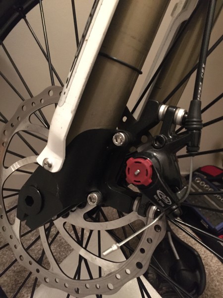

craig
wow 600 miles offroad not a hiccup! impressive!
I know what you mean about the gears. there are pretty useless! and above 26-28mph any pedalling is useless. ive been looking into the ATS speed drive system. which is a geared hub inside the crank. the schlumpf version is silly money. ats seems more affordable. http://www.ats-speeddrive.com/
Totally agree with you on the brakes. they squeel, there spongey and the brake levers look like they came off a £50 bike from argos.
So by fitting the hope brakes are you going to do away with the brake cutoff switch ? i looked at these http://www.ebay.co.uk/itm/Zoom-Hydraulic-Brakes-for-Electric-Bike-Cut-off-Switch-203mm-Rotors-Brackets-/151923681004?hash=item235f5b66ec:g:2cAAAOSwwE5WYrVz not sure of the quality though ? but they have the cut offs. the place we bought our bikes from actually sell these brakes.

as for the brakes, it appears that myself and quadfather were given a different brake set up, i had zoom hydraulic e bike brakes, which were ok but nothing special,no brake fade or overheating, but they just didn't fill me with confidence when riding .......i then had a leaking seal and contacted EEB who were happy to send a replacement complete brake....i told them i was planning an upgrade anyway, so just went ahead and ordered the 4 pot hope tech set i had my eyes on , they are immense!ill get some photos up soon
hopefully will see some photos of your bike if it arrives soon!
cfsmale said:
that link you put on for ebay (zoom), those are the brakes that i already have!! maybe because my bike was an early bike from their production line the spec is different from yours, what make of brakes are on yours?
lucky you! i got the most terrible 'avid' cable operated brakes. Don't get me wrong, they work. 210mm discs. They squeel and are spongey. i think the brake levers are massively to blame aswell, as they flex. there just cheap.
heres some pics,
I had hope brakes on my trials bike years ago. there bulletproof! expensive tho. I have been looking at the shimano
