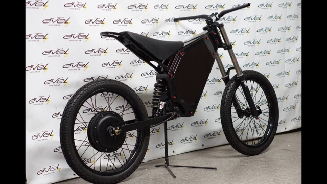

eVelbike said:
100Amp is too much for 20Ah LiFePO4 battery, battery life will be short. 60A is max safe current.

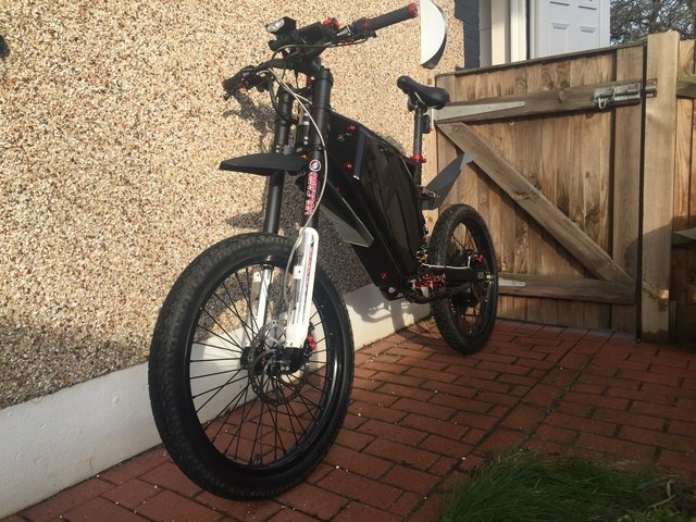

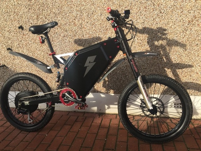

Just a little update from me, just back from an awesome 40 mile offroad trek, bike is taking a beating offroad no problem
And came home to a pacakge from the postman - new tail light!!
Ive fitted it inside my rear mudguard and is pretty cool, has indicators, brake light and tail light , and best of all, wireless controller for handlebar - all for under £20 - great stuff! Charges via usb and apparently has am amazing battery life , its meant to fit to seatpost but i just tie wrapped it snuggly into to my mudguard!
Cheers
Craig

looking good craig, like the tail light. interesting. the indicators flash red still ? american style ? or orange ?

Heres some pics after my ride today (just cleaned it) i added some new stickers to the side..... a bit cheeky i know..... but it needs something....
