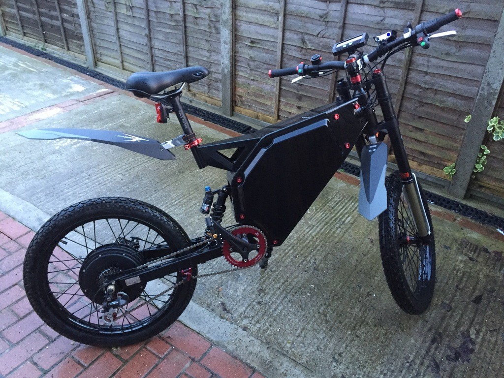

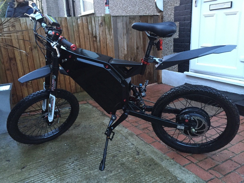

Had a great ride today. Thought id share some pictures. Done well over 40 miles and the battery still showing 76volts.
Was riding along the canal for a while, so wasn't exactly flat out.

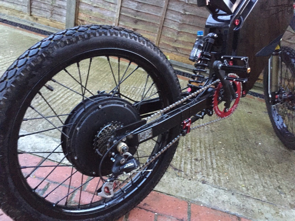

I thoroughly recommend the chain guide in the pictures below. my chain was coming off almost every ride. hasn't budged since.
Also got my 250w plates :shock:
I have a few bits still on order.....
Carbon fibre handlebars and seatpost.
Hope 4 pot brakes (yes cfsmale, i couldn't help myself lol. mine are black with anodised red adjustment screws and caliper bolts)
Controller usb lead to crank the amps up...
I had one of those chain guides aswell before i ditched the derailleur and went single speed! Looking good!

Did you have any luck with the ats speed drive, if so what size / ratio and chainring you going for ? i cant peddle after about 26mph. i look like the roadrunner.
I did contemplate fitting a 52t chainring, my setup is currently 42t. This will be a lot cheaper than a speed-drive. but bugger running out of battery with a 52t chainring!! :shock: i don't think id be able to peddle it un-assisted.

Regular ATS is not compatible with EEB frames, you may order 100mm BB version for it.
There is also one trick for big chainwheel - just add second one (no need to replace 42T).
52T you can mount on outer side of crank and 42T on inner side.
Ride with 52T and change to 42T by hands in emergency case.
But at first - I recommend you to change frewheel to DNP with 11T sprocket, becuase Shimano is too slow with its 13 or even 14T smallest sprocket.
