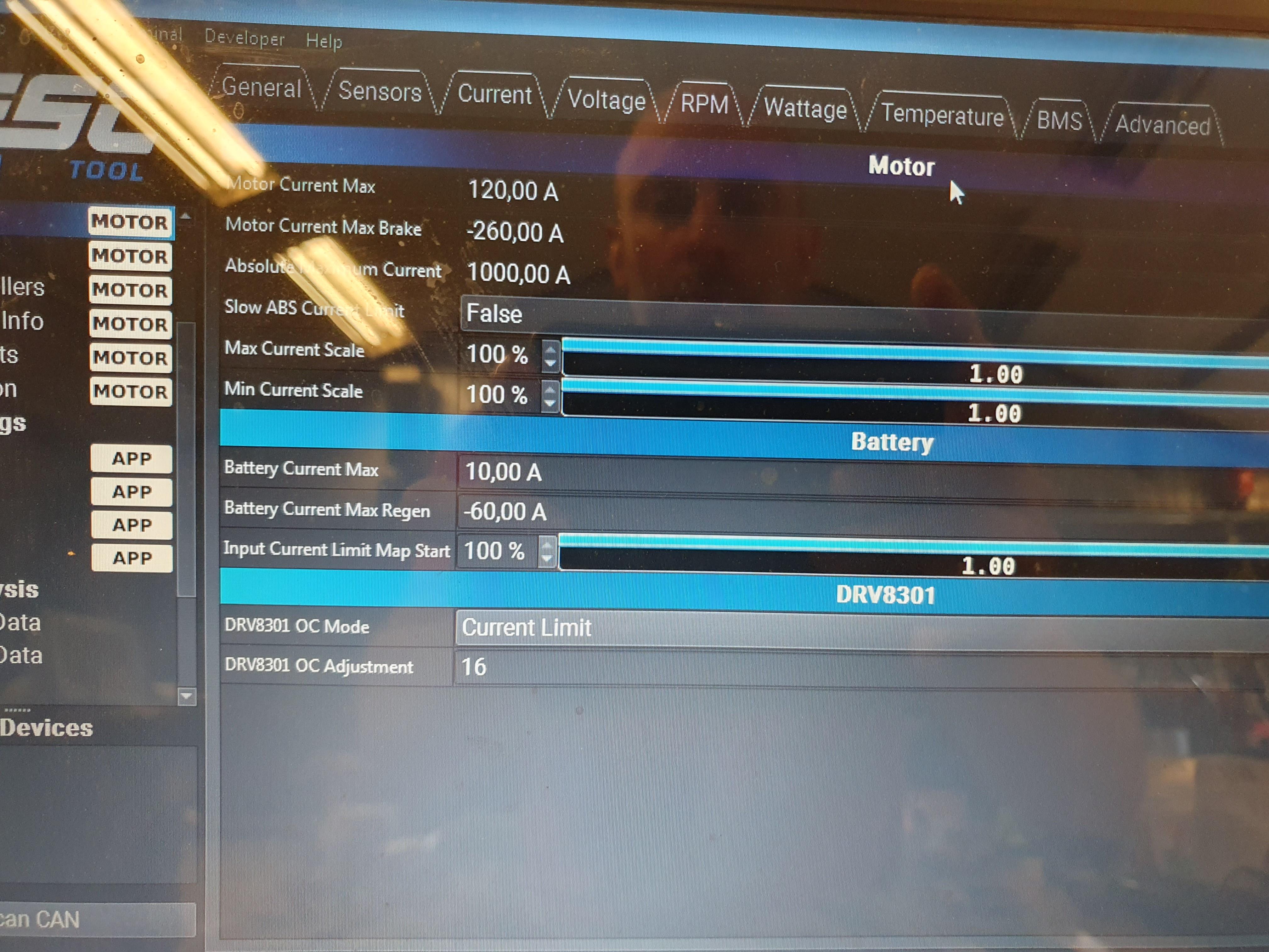

I have a CL1400 and a QS180 90h, early model with hall sensors.
There has been problems from the start to get it running properly, and hackey thinks that it all should be solved with changing to encoder instead of hall sensors.
I get that it is better, but I am not convinced that it will solve the issues.
What do you think?
There has 2 problems that I thought were the same or related, but maybe the weren't.
1: The small stutter/hesitation at low speed when it switches from hall sensors to observer.
2: A stutter that stays over the rpm range, a lot of lost power and rough running.
1 was probably solved with some tuning and the beta fw 6.05
2 started the second time I was riding it on a track, I noticed the rough running and went back home.
At home it was gone, and the bike worked normal again.
Around that time we did the switch to 6.05, tuned it a little at home and it seemed fine.
Tested more, after a while the problem 2 came back. It came more often, and now it seems to be constant.
Eventually I tried doing a motor detection again:
The saved values with 2,8mOhm and about 65uH should be about right, 600mOhm etc. not so much..
It looks like it is time to change back to the fardriver, or what do you think?:cry:

Could you show me all your settings? Or send a motor config file.
I also had issues with sensorless and after trying some settings hacked immediately recommended the encoder, but after some fiddling I managed to get the motor spinning much faster.
Can't promise anything though.
Encoder is already on the way, the problem is I dont think it will help.
I mean, can there be anything else than a hardware problem in the motor, controller or phase wires when I get 20 times the phase resistance I am supposed to?
I dont think it is the motor or phase wires.. Hackey said earlier that if there was a problem with one phase (like a bad connection or so) there would be a fault code for uneven current between the phases.

When I do the motor detection I set amps, frequency and dead time compensation according to hackeys video, not like in the file. See pictures:
The same way I did it when it worked too. I can get induction close to the right value sometimes, but resistance is always out there with 500-600+mOhm

Thanks for the reply, but as you can see in the other posts in the thread it is solved since a few months back. Problem 1 works after some tuning, I think it was mostly at what rpm the transition happened and dead time compensation. I am on 6.02 now, so 6.05 dosent seem to have anything to do with it.
2 was a hardware fault in the controller.
Are you sure about the motor? When I have measured myself I got 5mOhm phase to phase, so about half of that for one phase seems right to me. Same thing with inductance, if I remember correctly I got 100-130uH when measuring phase to phase. So I suppose half seems right for one phase?
When I tried to tune sevcon and used about 130uH it worked, but got low power in the chart. 65 also worked, and gave better power in the chart (and reality). I think a z-force 75-7 has about half of this inductance, at least that was how it was in the sevcon maps I looked in.
You can certainly play around issues by tuning values and it can work for a particular situation. The sensorless transition issue can be mitigated by pushing the switchover eRPMs higher when the power demand during acceleration tapers out the switchover is not as dramatic. It may work good enough for one motor and maybe for a certain operation scenario but as soon as get to the next setup, you are at square one. Chances are if the use case is different, that exact solution or value will not work the same. The permanent and repeatable solution is to fix the issue as the core which is noisy hall signals.
Regarding #2, the stator resistance value floating with temperature is something that affects FOC operation. It's usually motor rough operation as it gets warm/hot. Again, the issue may or may not be immediately evident and can be worked around, for example, by running lower current or going with a larger motor, therefore reducing the temperature drift. FOC is tricky in a way that it may run fine on the bench. But things change as you start applying the load. Temperature is yet another variable, a moving target to deal with.
The only way I can be sure about your specific motor parameters is by measuring them. All I am saying is that 2.8 or 5mOhm is an unusually low value for that kind of motor.
