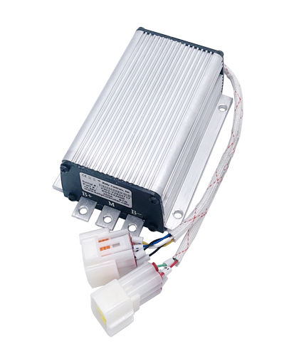

Try measuring the throttle signal voltage going to the controller. A normal hall throttle should go from around 1v to 4v.
It may also be possible the controller was made for a resistor throttle, but this is rare.
Another test is to disconnect the throttle and try placing a jumper from the 5v line to the throttle signal line and see if you get full speed (wheel off ground!).
It's not uncommon for *brushed* controllers to use potentiometer (resistive) throttles, but ones that use hall throttles are a lot more common than they used to be.
To be sure of what's going on, we'd have to see what the OP is actually using, preferably with links to the sale pages for each part, and clearly readable pics of all labelling on the parts and documentation that came with them, if any.

Looking at 40 working volts of LTO for a 20" bike with three 36V - 35 amp brush motors.
Two will go on the back hooked to a single 44T spoke sprocket. One up front with 44T sprocket. Both will sport #40 chain.
Looking at a Kelly controller.
KDS – Mini Brushed DC Series/PM Motor Controller (12V-72V) (50A-200A)​
Share
SKU KDS48100E
Motor RMS Current, 1 minute: 100A.
•Motor RMS Current, continuous: 60A.
$89.00
Gearing will be approximately 49 mph at 3,333 rpm @ 40V LTO.
