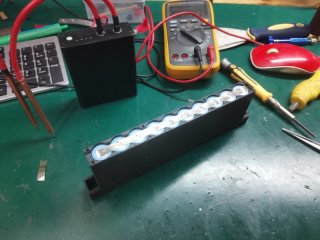

First assembly of a module:

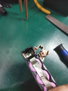

Making the copper tabs:
Installing the tabs:
The first prototype module completed:

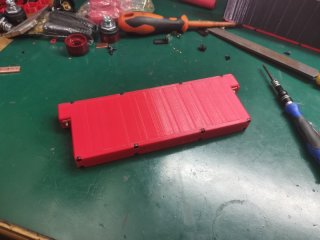

Next, printing a small 3S sample of the outside shell:
Test fitting of 3 cells + the BMS :
Test fit in the suitcase:

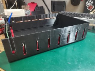

Some nice progress this weekend,

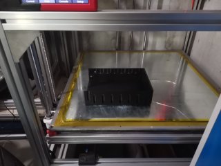

First I had to print the outside shell. I printed it at 0.2mm layer height with a 0.4mm nozzle so it took a while (30 hours). But it was a great success:
A quick test fit in the box just to be sure... Fits like a glove!

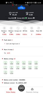

So far it's been a little bit disappointing:
The balancing function is very limited, according to the vendor it will work only after these 3 conditions are met:
-Charger plugged
-An other condition I forgot right now but that actually made sense.
-All cells need to already be within 0.05V of each other. WTF, isn't it the whole point of the balancing function to do that?
This really sucks for me because all my modules have very different voltages right now, I was hoping for the BMS to do all the hard work for the initial pack balancing. Turns out it won't and I'll have to do it manually, which will take forever because I don't have a powerful 3.7V charger.
It would have taken even longer with the BMS, of course, but I wouldn't have to do anything, it would have been totally automatic.
An other issue: when I remove a module the BMS will display the removed module voltage at 5V instead of zeroV. This is a problem because it means that if at some point I get a cell disconnected then the BMS won't see it as disconnected, it will see it as overvoltage. Not sure if it will create any real life problem, since it will get into protect mode no matter what, but that's not really normal IMO.
Also, the bluetooth is a bit unstable, but that might be my phone, I'm not sure yet.
So yeah, I prefer the ANT BMS so far, it has a lot more options and the balancing function works whenever you press a button, there's no useless drama of weird random conditions to meet.
Too bad because I really wanted to like it, the form factor is nice, the bluetooth dongle can be installed anywhere I want, the little battery gauge is nice, it can be plugged to a screen and last but not least it can be plugged to a computer.
I'll balance the cells up to whatever they recommended and hopefully things shall get better. Hopefully I'll be able to give it a better review after that. :)

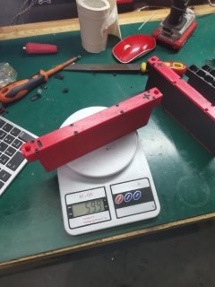

Capacity is 25Ah, max Amps limited by the BMS @ 60Amps. So it should be able to power stuff up to 2500-3000W continuous.
Weight should be around 10 kilos, maybe 11 with the casing.

While it is true that typically you'd want to balance cells first, the BMS shouldn't be incapable of fixing more severe balance issues when they arise in regular pack use.
If the BMS does not either alert you via some active method that does not require you to interact with it to find out (such as via beeping loudly, etc) or better yet to error out and shutdown both charge and discharge ports when cell differences exceed it's ability to balance, then it is potentially dangerous to use:
If some cell groups lost enough capacity to become unbalanced beyond the BMS limits, and it did nothing to prevent continued charge / discharge, then eventually this imbalance will grow worse and worse, to the point the pack either becomes unusable due to insufficient capacity, or dangerous because of overcharge (if it also fails to stop charge or discharge at LVC or HVC).
I'm just not sure I would trust it without testing that first. ;)

Don't worry, it does alert and cut power, but you can choose the voltage difference between worst and best cell in the app to be any number you want, so I bypassed this protection by setting 1V instead of 0.2V, which is usually what I set on my other batteries. I had to remove this protection to get the FETs to activate on the BMS to test the functions. I monitor the cells regularly on all my batteries to check the drift, no worries there :wink:

Anyway, since apparently I'm on trial here are the requested elements, your honor:

For the regular people who still follows my build despite the drama, here are some updates:
Had to cut a little opening in the suitcase for the battery SOC indicator:
Painted it black and then installed it :
And voila, now balancing ecah module one by one... as you can see my setup for doing that is quite primitive, I modified this little cell charger so I can charge each module using alligator clips:
Trying to get all cells within 50mV of each other, then hopefully the BMS should be able to take them within 0.001V .
Also have to order some nice wire to make the power cable, and that should be it! 8)
