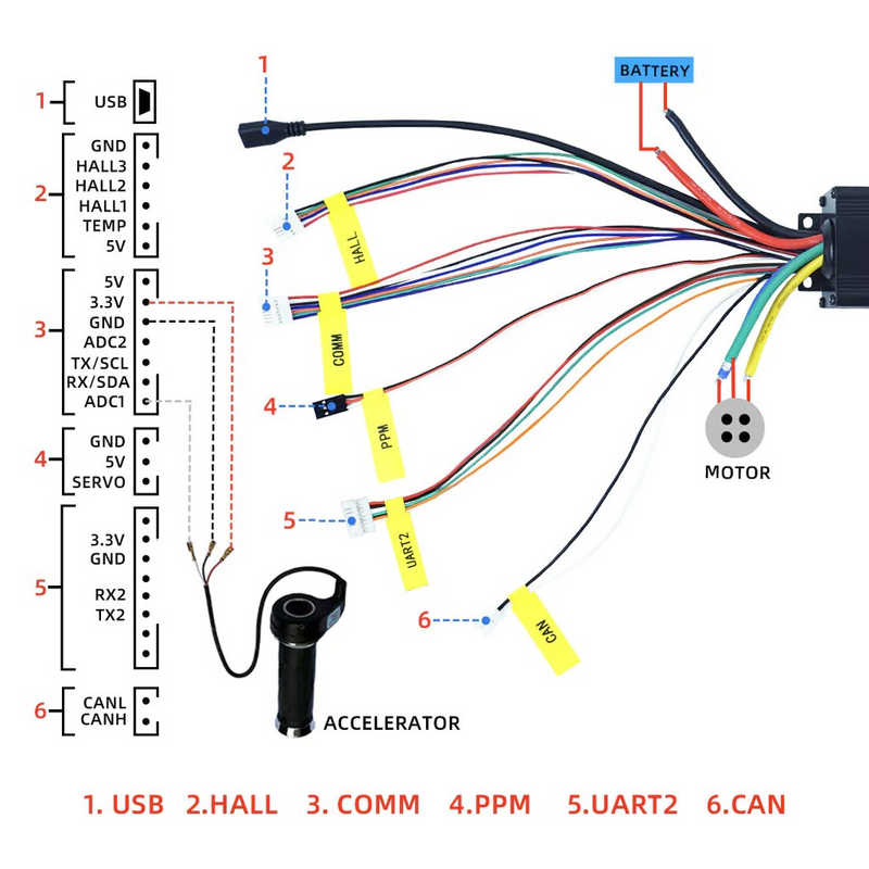

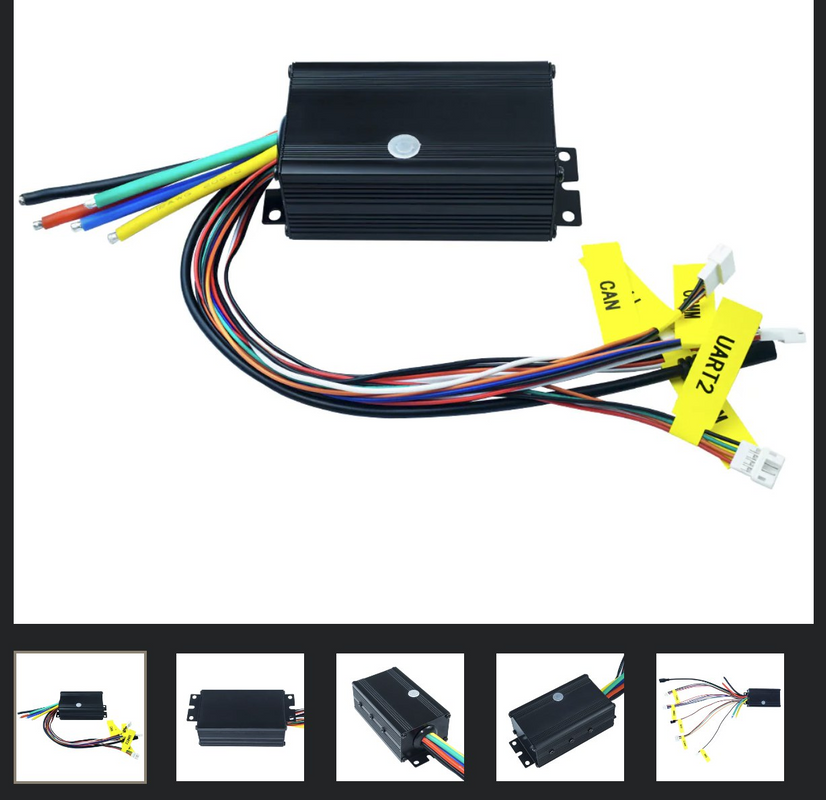

I am now in favor of VESC, just because VESC is so popular and powerful. So, my suggestion is for the hardware developers to think if is possible to update this concept of Easy DIY and repair OpenSource ESC, to be as the VESC hardware so the VESC firmware can be used directly.
Some of my notes about VESC:
Example of VESC EBike motor controller: Flipsky VESC 75100 EBike controller: 100€, 75V 100A, CAN and UART communication.
Advantages:
- BEST motor controller out there, OpenSource, small and powerful
- only 1 minute to make the inital motor auto detection setup, resulting in the best motor performance and silence out there!!
- VESC EBike application can be developed in high level scripting language
- powerful mobile app (also for PC and RaspberryPI), with high level scripting language for custom application
- display available to buy on shops, OpenSource (although for ESkates but easy to adapt for EBikes)
- there are A LOT of experienced users / developers of VESC
- powerful advanced algorithm for sensorless at motor 0 speed meaning no hall sensors needed
Disadvantages:
- not as cheap as the chinese EBike motor controllers although cheap enough since the chinese also sell VESC controllers (Flipsky is chinese)

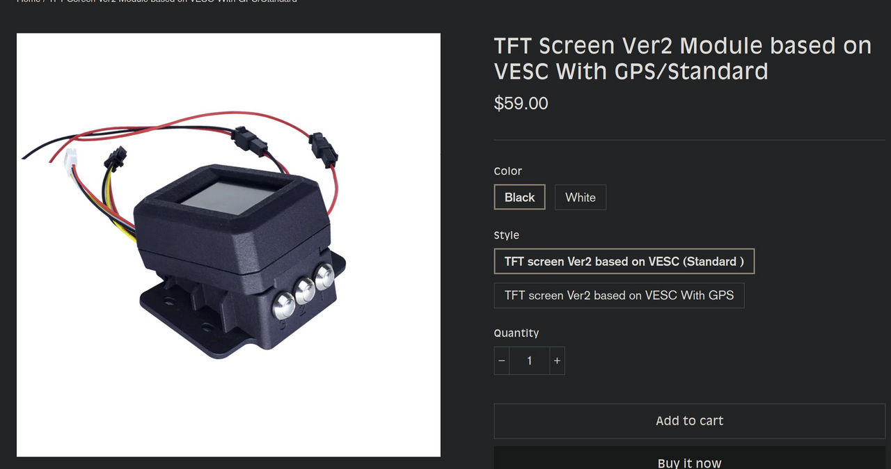

This is the main disadvantage of the VESC! It's not suited for EBike use at the moment. There is a basic PAS implementation that's it.
There are forks with Bafang Display Protocol implemented from Luna Cycle I think, but I'm not sure....
This controller uses VESC firmware however only a few of the settings will be user adjustable to prevent the user doing inadvertent damage to the controller.
VESC hardware is definitely not the way, I would go. Way too expensive and no advantage over the Lishui Controllers for EBike use...

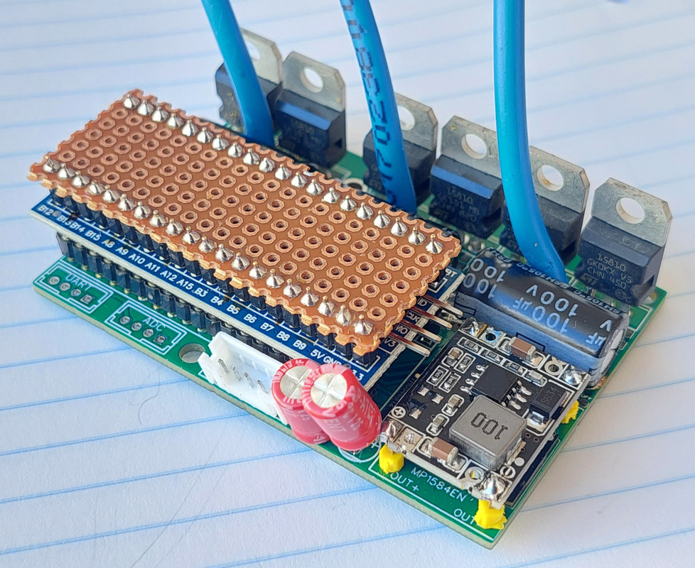

If you want to run VESC on this board it's already easy, you just use the F405 pill designed by ES user OWhite and tested extensively on the MP2 ESC.
https://github.com/davidmolony/F405_pill
For some reason it's on my github not his... But full credit to OWhite.
The original hardware can be used with full VESC and MESC functionality with 6 resistors to make phase sensors and i think the latter KiCAD version Afzal is writing on will support this natively.
VESC is not the best motor controller, it had an amazing interface and a bazillion options but the underlying FOC is very similar to the reference implementations, with serious limitation on PWM frequency and for reasons not currently understood by the community a higher than necessary rate of self destruction (there have been significant improvements in the later releases on this front).

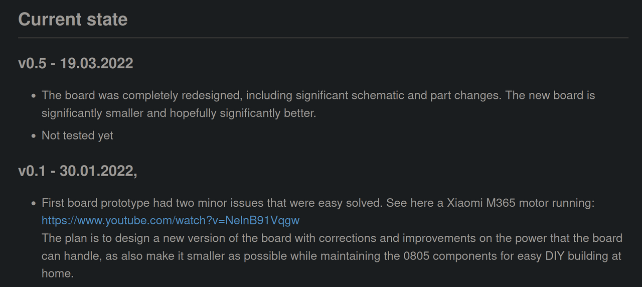

And an update, I had ordered for SMT assembly of this board corresponding to git tag v0.5.x (current HEAD of main branch)
