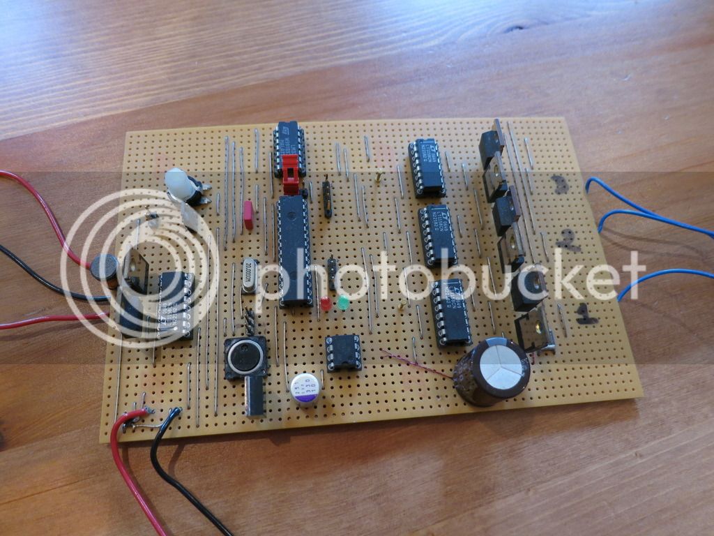

I started to play with BLDC motors back in 2007, my first controller used sine wave open loop control. So it took me about 5 years, working maybe few hundred hours per year, to get where I'm today! I did spend a bit of time to get the solar power management working on my gen 2 controller for solar RC planes but it's still many hours to get everything working...
see below the picture of my first gen prototype
walls99 said:
I started to play with BLDC motors back in 2007, my first controller used sine wave open loop control. So it took me about 5 years, working maybe few hundred hours per year, to get where I'm today! ...
Congrats on the journey! Those who have walked with you can relate. It "looks" so easy... but it's not, to do the integrated system well.
