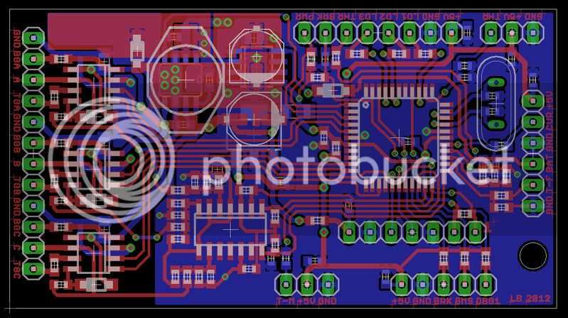

Hi Walls,
What software are you using four your pic ?
And i also noticed you named the pins on the upper connectors THR LD1 LD2 BRK PWR on your pcb layout.
Could you explain me what they stand for and to what they are used for.

If you dont mind, I would like to know what parameters did you looked at to choose the regulator on your design (max5035) and the cap values on the bootstrap of the driver (1u).
Also, what is the chip just above the 12v regulator, there is no p/n on it or no labels. An alternate regulator ?
Thanks VERY much for this thread and the open source !! :eek: :eek:
I chose the max5035 for its wide input voltage range and low shutdown current. For the bootstrap, the recommendation is a few 100nF and 1u was the closest value available to me.
It's a 5V LDO in SOT223 format for the 2nd 5V power rail from the 12V switcher which is switched off in standby mode. The other 5V LDO (LM9076) is for the PIC only and is always on.
