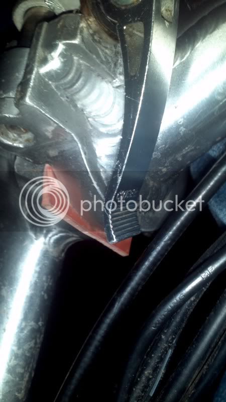

Hi Everyone,
This could work for anyone who has this type of folding bike frame hinge:
I recently gave this bike a very simple and very good update. It's improved the handling and stability of the bike significantly. This cheap type of folding hinge isn't designed to close very tightly. When I reached to the underside of the frame, and put my hand on the gap between the two hinging plates... I could feel the gap opening and closing as I rode over bumps. This floppy hinge in the middle of my frame made my bike feel wobbly and unstable.
What I did was sandwich a piece of 3/32" thick rubber gasket. It was tough to close, I had to use a clamp... so I would recommend a 2mm thick gasket, I would also recommend a harder material than rubber because maximum rigidity is optimal... maybe a really soft metal would work. But once I got the hinge closed, the frame became rigid! It was like having a new bike. Here are some pictures, Cheers!
I have a folder, not an Xtreme but still chinese. This information is very helpfull, thanks for sharing.
