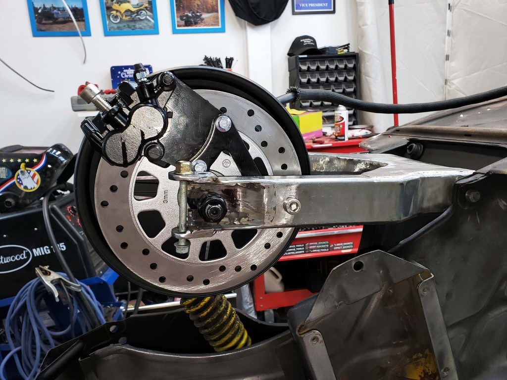

Lastly, a question: The torque arms are very loose, moving 1/4" at the tip. You can see the slot has a significant gap:
It is barely over half the thickness of my swingarm dropouts, and they are very snug, plus will be pinch bolted. Should I still use them?
If yes, is there any reason why I can't curve them to fit my swingarm, then drill and tap it for a bolt?

For the torque arm, yeah I think that tolerance is way too much. I'm not an engineer but I wouldn't use those torque arms. I will be interested to see what others say though.
I just learned about this company - https://sendcutsend.com/ - it looks like it would be a good option for making two torque arms to the correct size, and they can even do bends. I've heard that turnaround time is about a week. $29 minimum order.
Or maybe you don't even need torque arms with your thick swingarm drop outs! Or maybe just tighten up the tollerances in QS's torque arms by welding on some mig filler metal and then milling it to the right size with a dremel. That's probably what I would do.

Yeah, I am waiting, but I am also considering making my own out of 3/8" plate. I can drill it and then cut it out. I will look into your link though. For the price it would be worth it.
At this point I would be better off paying a pro to build this to my spec. I have at least 15 hours in fab, and another 10 in design.
Nonetheless, I am pretty happy with it, and learned a lot. My welding is steadily improving. It is STOUT!
The addition of the shock mount was problematic. Angle and clearance. I will have to mod the new shock when I receive it. Yes, single sided.
Then the brake mount messed with me. I ended up with the caliper upside down. Not ideal. I will be looking at it more tomorrow. Note the bolt threaded through both sides of the swingarm, and into a bushing on the caliper mount.
Lastly I made a small error in building the swingarm and did not leave enough meterial for the pinch bolts, so I added it.

Nice work! My only suggestion is, ideally, the captive nut you welded to the right swing arm should be on the other side of the metal, so that you're not relying on the welds to hold. But your welds look good enough, and with the shock mount where it is, that might not have even been possible.
And now that I have a better look at the dropouts, I don't think you *need* the torque arms that came with the motor. Especially if they leave a gap around the axle! I wonder if anyone else has an opinion though.

Yeah, the nut on the inside would have been ideal. I should have done it before I boxed the shock mount.
Mostly on the valve stem I am worried about wear through. I would not be comfortable removing the cover. Mostly because of warranty. I will be keeping an eye on it though.
