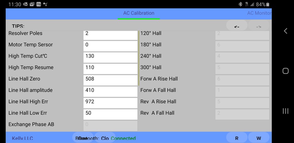

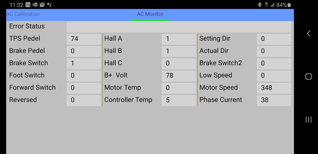

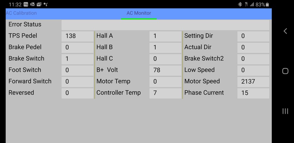

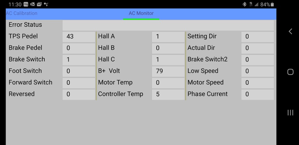

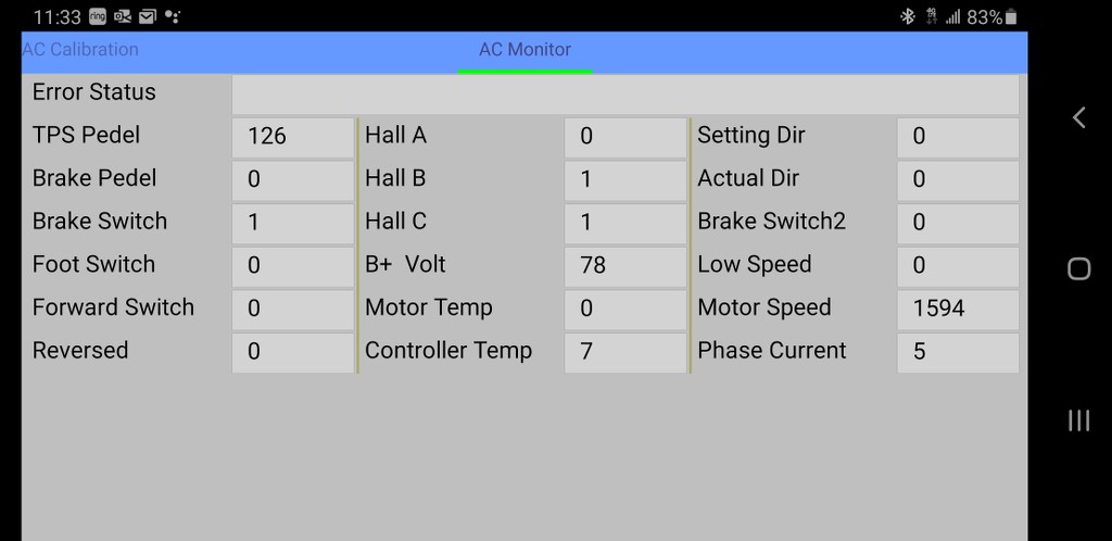

So, in the interest of optimizing my Kelly Controller, KLS 7245 H, and to get some opinions, here is a video of it running. It makes an odd noise, and has since installed, but runs great, with only a slight initial hesitation.
https://youtu.be/1awk6_YSeJM

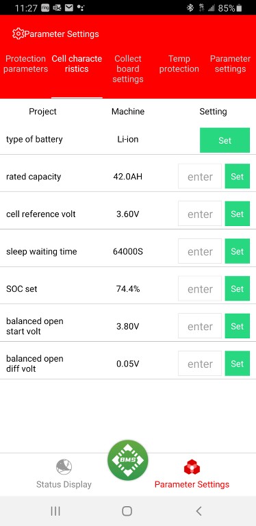

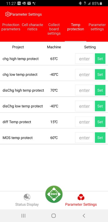

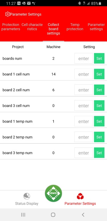

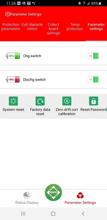

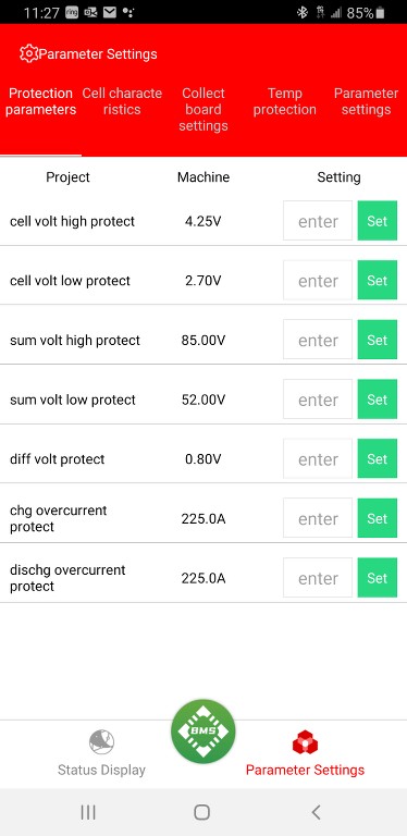

These are my BMS and settings, it is a Daly BMS:

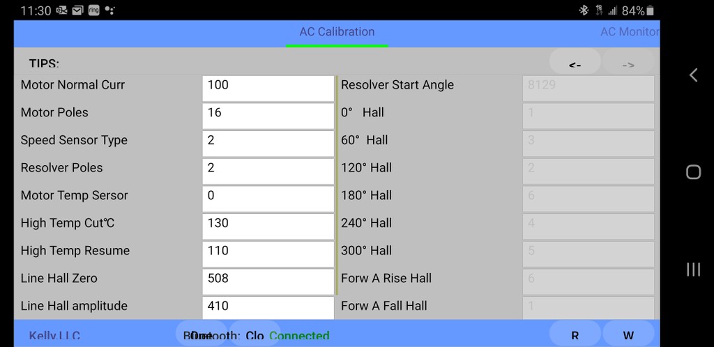

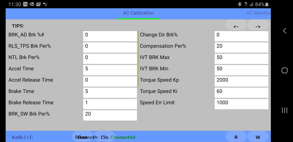

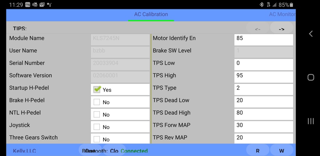

These are my settings on my Kelly Controller.
Any thoughts? I'm open to making it faster and get more miles per charge, with more miles taking the more important role.

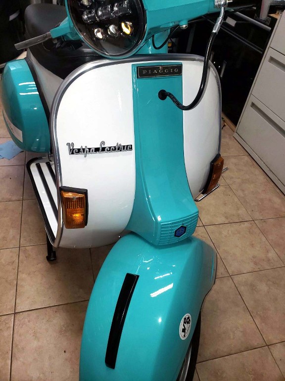

So, EmVeeTee made me some 3D printed badges and I painted them up. Fortunately he gave me his test badges so I could play with sanding and painting them.
Black spray paint first, then silver brush on.
Test fitted one of the test pieces. I used 3M trim tape with a heat gun conform it to fit the legshield.
Once dry I will put on the final good badge.
Made some changes that _Gonzo_ suggested, and I went through the Kelly manual and made a ton of adjustments, including your suggestions.
All I can say is holy shit. It is a rocket off the line now, even with my fat ass on it, and no odd noises. No time today for an extended ride, but I am betting it will go even faster than 62mph, and get better miles. It is 100% improved, and way more fun to ride. It nearly pulled itself out of my hands the first time I nailed the throttle. :shock:
Thanks so much for your help -Gonzo_! :bigthumb:
I recorded the new settings, and will display them for all soon.

BTW, I am showing my project to the local authorities (not sure what to call them) to get it road legal next week, and I need to restrict it to 50km/h for the occasion. Do you have a suggestion on the easiest way to do this in the Kelly software? I will make a separate thread on it, I think.

The easiest way is to lower the max speed limit. Should be pretty simple with a little math.

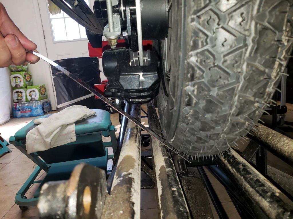

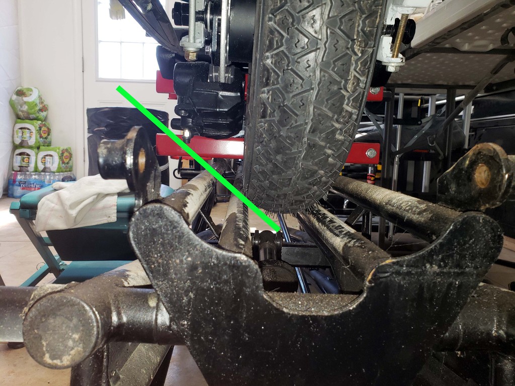

I really think you should do something about this rear caliper. I might be wrong but I think it is very likely to rub the floor sometime soon.
I discovered this weekend that these calipers and brackets actually exist in both right and left versions, exact mirors of each other. installing a left version will very easily solve this issue, it is also very cheap (well at least in China). :wink:
So I suggest you to try and find one, so at least you'll be able to corner without fear of destroying your caliper or worse
Many have said the same, and at 300 pounds, and riding hard and fast, no touch so far. More the issue, I get a little howl out of the rear brake when lightly applied, so I need to do something. If I can get an upright caliper that doesn't hit, and a new rotor, as a package, I may do that.
Flipped it didn't clear. Believe me, I tried it on both sides.
