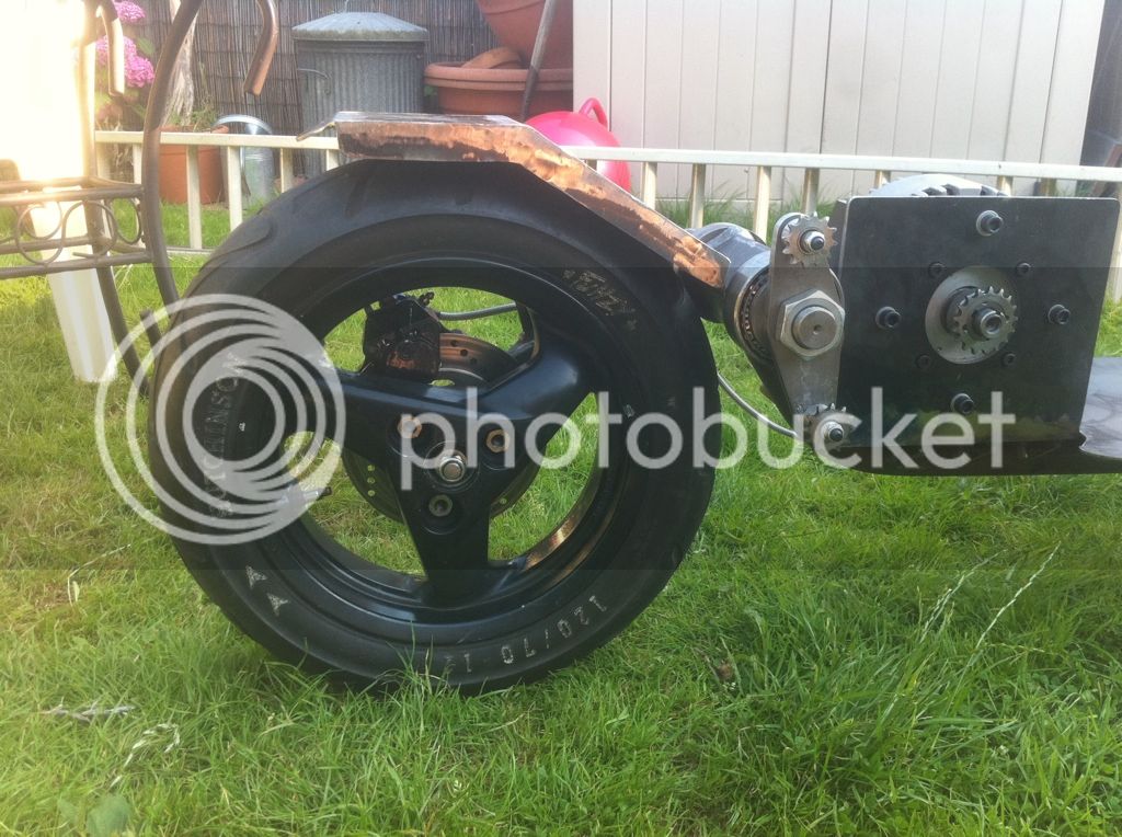

Been working on making a mud guard today. Took quite some time cutting all the pieces then welding together, but am pretty happy with it now. I am still not sure where I am going to mount the controller so have made the mud guard as a possible place to mount.
The mud guard is attached to the swing arm, and as the knuckle was the pivot point of the suspension I was able to go very close to the knuckle with the mud guard without any risk of it hitting.

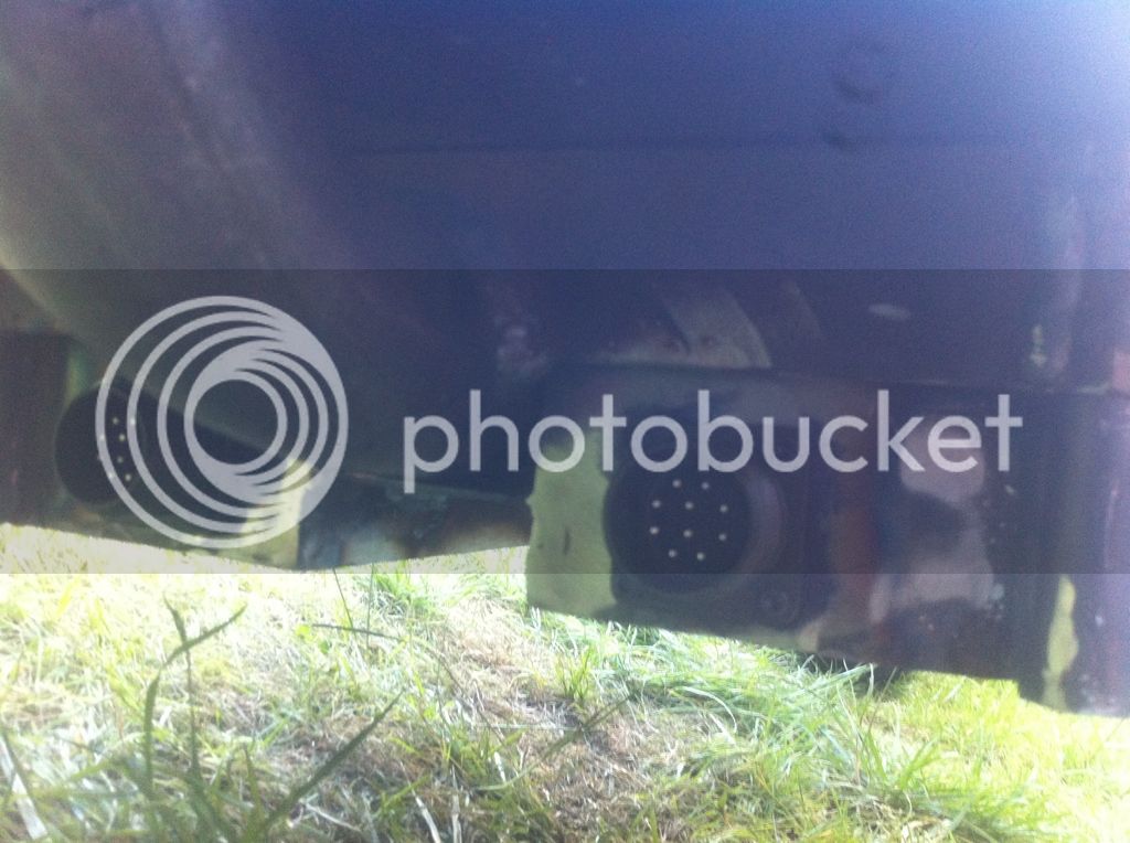

Made of some of the cables and sheathed them with the stainless braid. There will be 6 sheathed cables running down the scooter. The sheath really improves the look, will look like some huge power cables, but actually inside is just control cables. The cables which come from the controller are made of to an amphenol plug. This will then go through a small box, basically there will be four sockets on the box. This will allow me to transfer from the controller plugs and configuration to send everything to their appropriate place out the other end. Have yet to make this box but won't take long as will only be small.
Still yet to mount controller or contactor. This job is really alot bigger than I imagine. I been up to 2am most nights soldering connections, 8 x 8 series batteries means everything is multiplied from my last build, used 20m of 1.5mm heat shrink, plus all the other sized heat shrink I have used. Nearly done a whole roll of solder too. I think I am about 75% through the electrics. Hope to have the project running by the weekend.

I have an issue. When I made the test chain up I ground head of the pin and punched it out, but not all the way I then used the same pin to complete the chain link not using a split link. Now that I wanted to use the drive chain for test ride I used the split link, which wraps the tensioner too far around the knuckle. Its ridable but this is slight marking when the must of been chain rub because of this.
A longer arm to hold the bottom tensioner sprocket should resolve this, or a complete chain made up without a split link.

The reason for the controller facing outwards is because the high current bus bars would be pivoting into the suspension knuckle. It's quite ugly in terms of cable routing. The current leads I fed between the boxes, I am considering doing that with the two cables that come out of the junction box. I would have to secure the one that is sheathed and add insulation as the 400amp fuse holder is bolted to a plate I welded down there too.
